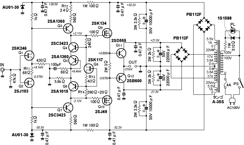

Jam's latest schematic is not optimum. I have made circuits like this 30 years ago, but they are too hard to bias. The feedback pair will just slow the amp.
The bias control is primitive, and is a step backwards from the one on my schematic. I hope this is enough for contemplation.

Hi Charles,
Thanks for the information, you and Mr.Curl have given me a lot to think about.
This is what I have so far.
a) J-fet differentials .
b) Folded cascode like Joe describes.
c) Vbe or Vgs multiplier (how about a diode string and trimpot?...a non-feedback bias circuit, keeping with Charles's theme.
d) Triple darlington output or option 4 with lateral mosfets. (If this is to be a non-global feedback design I probably would stick with the triple.
e) We would have to degenerate the diffs. and folded cascode to obtain the right amount of gain.
f) Front end to be driven by it's own regulated (non-feedback) supply.
Questions.
a) Can we get by without a servo to keep dc offset to a minimum?
b) Any objections to using mosfets for the diffs. to use higher fails or cascodeing the diff. pairs to attain the same goal.
c) Should we drop the differentials and use an input stage like above.
d) Who is going to layout the pcb once the proto is working.........
Jam

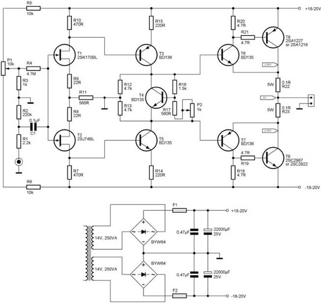

Hi Jam,
using JFETs in the diff-stage is a good design approach. Slightly
degeneration helps to prevent this stage from unstable operation.
When using lateral MOSFETs a Vbe-multiplier is a must. Vgs only works
with vertical MOSFETs. To my opinion a diode string and trimpot is not
a good solution, because Vbias depends much more from the tail current
than a Vbe multiplier does.
Option 4 has only two transisors in the signal path, a triple emitter
obviously 3... So I'd prefer the FET & bipolar output stage. The
output stage topology you've posted is very close to that what I'm
using. But I would never use bipolars without the emitter resistors. Thermal
stability is strongly dependant from the emitter resistors. Many
(especially the DIY) designs blow off because of thermal runaway.
Any suggestions about the current in the (MOSFET) driver stage? Currently
I'm using 150ma. This should be enough for up to 15 Amp ouput current
I like the differential input stage. You can obtain balanced operation
easily.

Boca,
Thanks for your input. I think you need at least 100 ma. for the mosfets to sound good. I would like to know if you ran the bias past 200ma. if there would be any sonic benefit.
Bi-polars do not need such a high bias current I believe. It might be useful to compare the mosfet driver to the triple darlington. I suspect that Charles has already tried it and prefers the latter.
