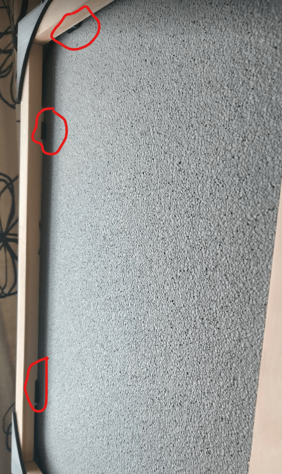

The corners are 3d printed and holds together the two frames that the GPS plates are clamped between, using some adhesive foam strips:
https://www.amazon.se/gp/product/B091HPDSH4/ref=ppx_yo_dt_b_asin_title_o02_s00?ie=UTF8&psc=1
The corners fit the wood bars for the frames very tightly, and plate pretty much holds together as it is, but they of course have screws to secure the frames.

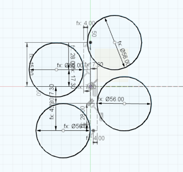

Here is a sketch for the template I used to fix the exciters, which I put in the middle of the plate:

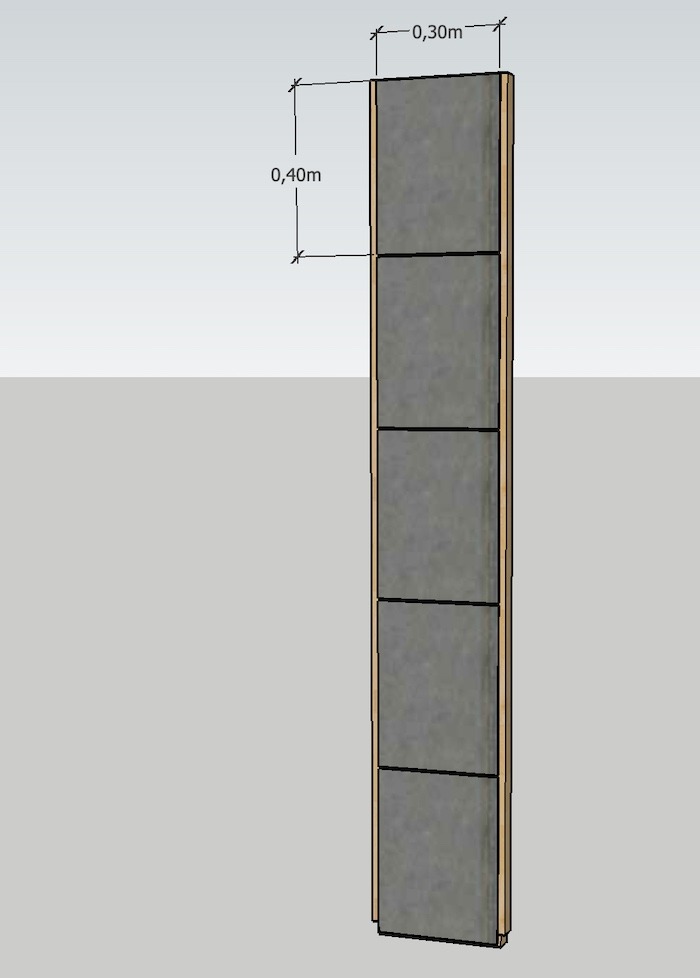

Remember that the panel is about 50x40cm by 3.5mm thick.
