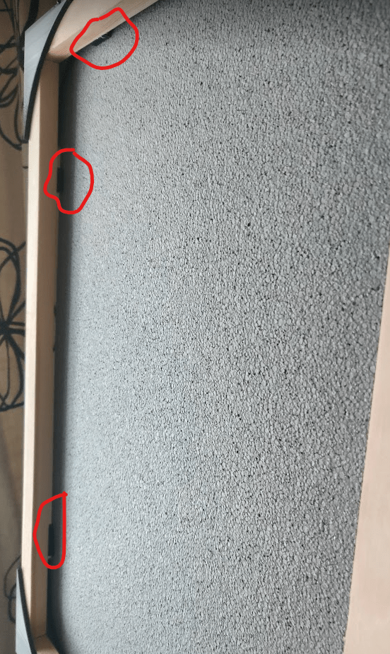

So here is some more details about the system and event I used them on.
First a little about the plates. They are graphite enhance EPS (GPS). I found the GPS to sound slightly tighter that the EPS of same density, but I think there is more variation between different EPS materials then between EPS and GPS. Link to the specific plates I use is in original post.
The corners are 3d printed and holds together the two frames that the GPS plates are clamped between, using some adhesive foam strips:
https://www.amazon.se/gp/product/B091HPDSH4/ref=ppx_yo_dt_b_asin_title_o02_s00?ie=UTF8&psc=1
The corners fit the wood bars for the frames very tightly, and plate pretty much holds together as it is, but they of course have screws to secure the frames.

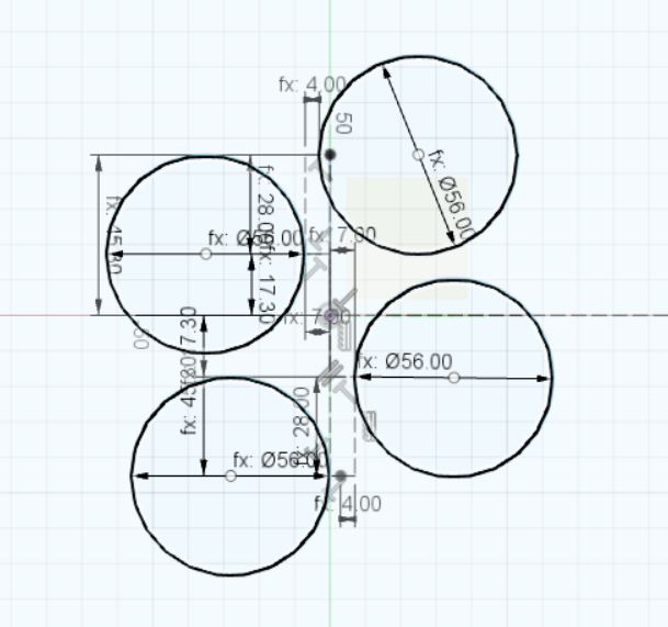

The exciters are fixed with epoxy to the GPS plate in a configuration similar to what Tectonic use.
Here is a sketch for the template I used to fix the exciters, which I put in the middle of the plate:
I attempted to make a support spine, and I tried a couple of variations, but got issues with distortion. The exciters should stay glued on without issue, but doing stress testing during a very hot day on my veranda and and instead of using a HPF, boosting bass a lot, the exciters also started distorting. Conditions was very extreme and I doubt I'll be able to replicate the issue unless I organize a party in a sauna without using any subs :)
But as a desperate quick fix I added some strings to hold up the exciters just very slightly, making the distortion disappear. I probably do some more experiments printing a holder to hold up the exciters, but also want some kind of back bracing anyway to protect exciters during transport. Although now the do stack very well, so is quite easy to transport safely.
I did various experiments with coating the plates with PVA glue, shellac and hide glue, and found that at least on the EPS plate I'm using, hide glue with a very thin layer of shellac gave best sound and sensitivity. You have to be very careful with the thickness though. I used a roller with 3 parts water to one part hide glue granules to apply one thin layer, and when that dried I rolled on a single layer of very thin shellac solution.
I decided it was simpler to build a roof over the speakers than try to make them protected against rain.
I made construction as simple as possible and could do it all myself without a proper workshop in a couple of weeks. While it doesn't look very finished and professional it worked really well, and I will try to tidy it up and optimize it as well as get my own subs so I have a complete system I can tune carefully.

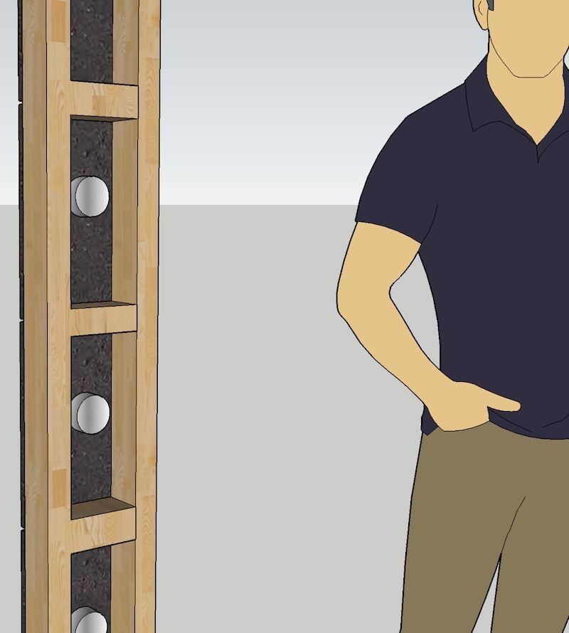

I see you mounted the exciters into the center of the panel - or that is just how it looks in the video and you used the standard 3/5 mounting point as a center of the cluster? Or maybe the 3/5 rule does not apply to multiple exciters in this configuration, since none of them is actually in the center and is closer to 3/5 mounting point?
Joined 2008
I have just ordered 10 pieces (8 for PA panels, two for smaller for home). Do not tell me I need to order another 10:) I read that the Tectonic panels use carbon honeycomb panels. I am trying to find some local source, until now I found only 200 x 300 mm on AliExpress for around 50 Eur each. Would a thin (1 - 3 mm) carbon board work as well?
DML is as the name suggests about distributing the modes, which will give you a smoother response. Exciter placement seems to have less effect on the response than I assumed, but avoiding dead center seems to be good. But with multiple exciters, indeed none of them will be dead center. Looking at Tectonic they also use a similar configuration that looks placed in the center.
Most ready made nomex core honeycomb doesn't seem ideal for DML. My guess is that you want around 0.1-0.2mm thick carbon skins. I did get equipment and materials to try to vacuum bag my own plates, and will dig in to that again when I have time. But it will be much more work and much more expensive, and since I was so happy with the performance of the GPS I decided to settle for that for now.
In the DML thread in full range, someone recently linked to an italian supplier that does 0.3mm thick skins for a reasonable price...looking forward to see how that works out, but I fear it will result in lower sensitivity than the GPS plates at a higher cost.

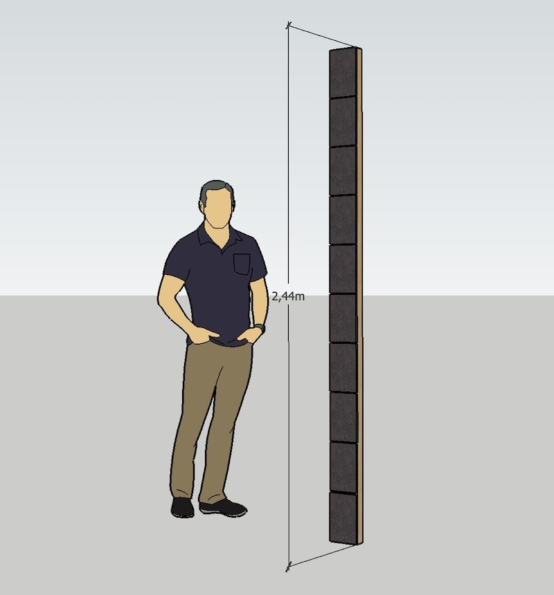

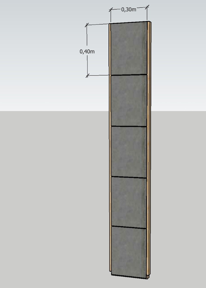

Thanks for the answers! So the distortion was higher in Tannoy?
Anyways, would you say that a line source endeavour could be successful?
I will use DSP EQ so not so scared about FR not being ruler flat.
Would you buy those Neopor Styroporplatten again?
If I would go for smaller plates, do you think that 10mm would be better or is 25 the one to get?
Or will these be to small all together perhaps - go for larger?

Sorry, yes, the distortion in DML panels was much lower than the Tannoy. I'll get back with actual graphs eventually.
I don't see any reason it would not work well in a line source configuration, but I guess it will not really be a line source any more.
While it is good to avoid square ratios, I have the impression that having a very long rectangle is not very optimal from a power density or response perspective. The shortest side dictates the lowest mode, and you don't want the longest side to have the exact same mode of course, but you also don't need to move it very far to smoothen out the response. So looking at your drawing you might get even better response and more power by using say 5 plates instead of 4, or making the whole thing a bit less tall. And I think you want them at least 300mm wide, depending on where you hope to set the HPF.
I'm very happy with the neopor plates. I will do some carbon/nomex experiments eventually like I mentioned, but I'm not sure that it will be that much of an improvement since the EPS seems very hard to beat being both very sensitive and good sounding.
I did get the 10mm to test as well, but they feel a bit flimsy for outdoor use, and didn't notice the 10 mm sounding better or being more sensitive during my tests. If you want smaller plates I think 10mm plates can give you a little bit lower extension, but have not really experimented with that.
