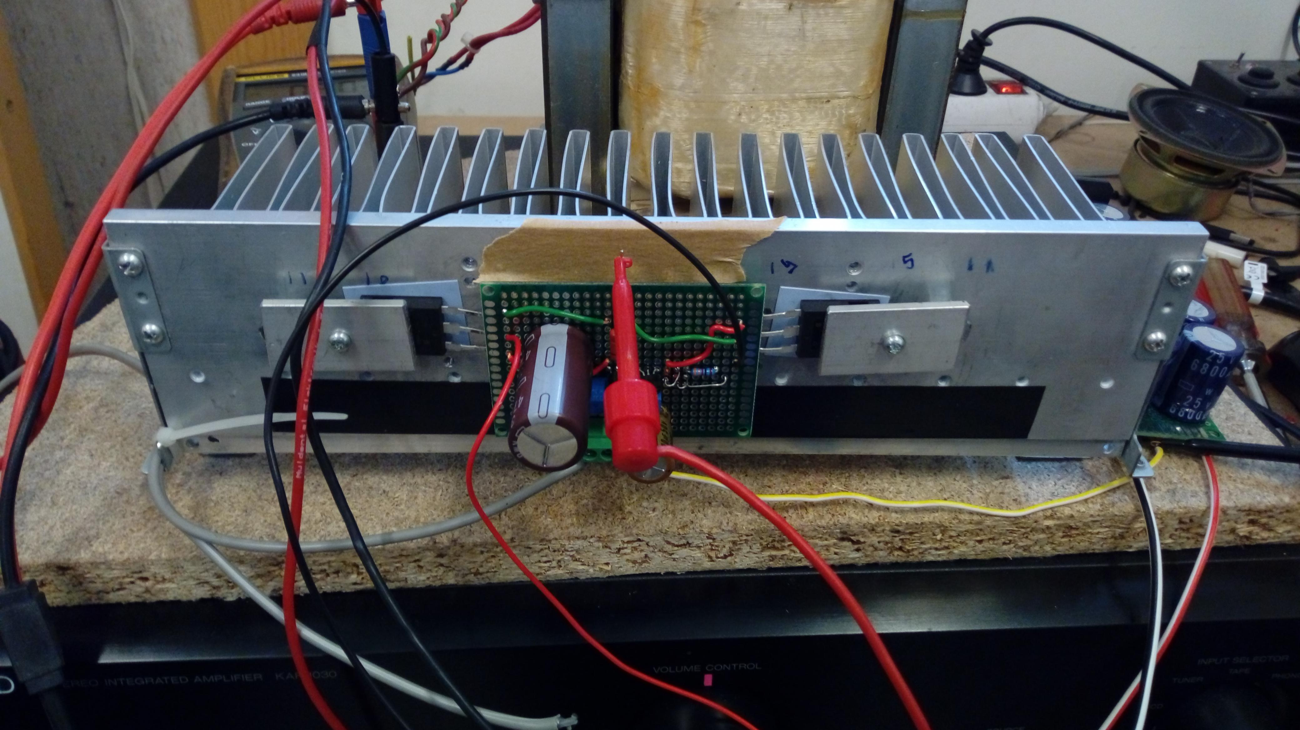

I have around 1,3A current, the supply is abt +-13V. I did not read all of the thread, should the diodes be mounted on the heat sink?
I still have some 'adjustments' to do, I'm thinking some decoupling capacitors close to the fet's would be good.

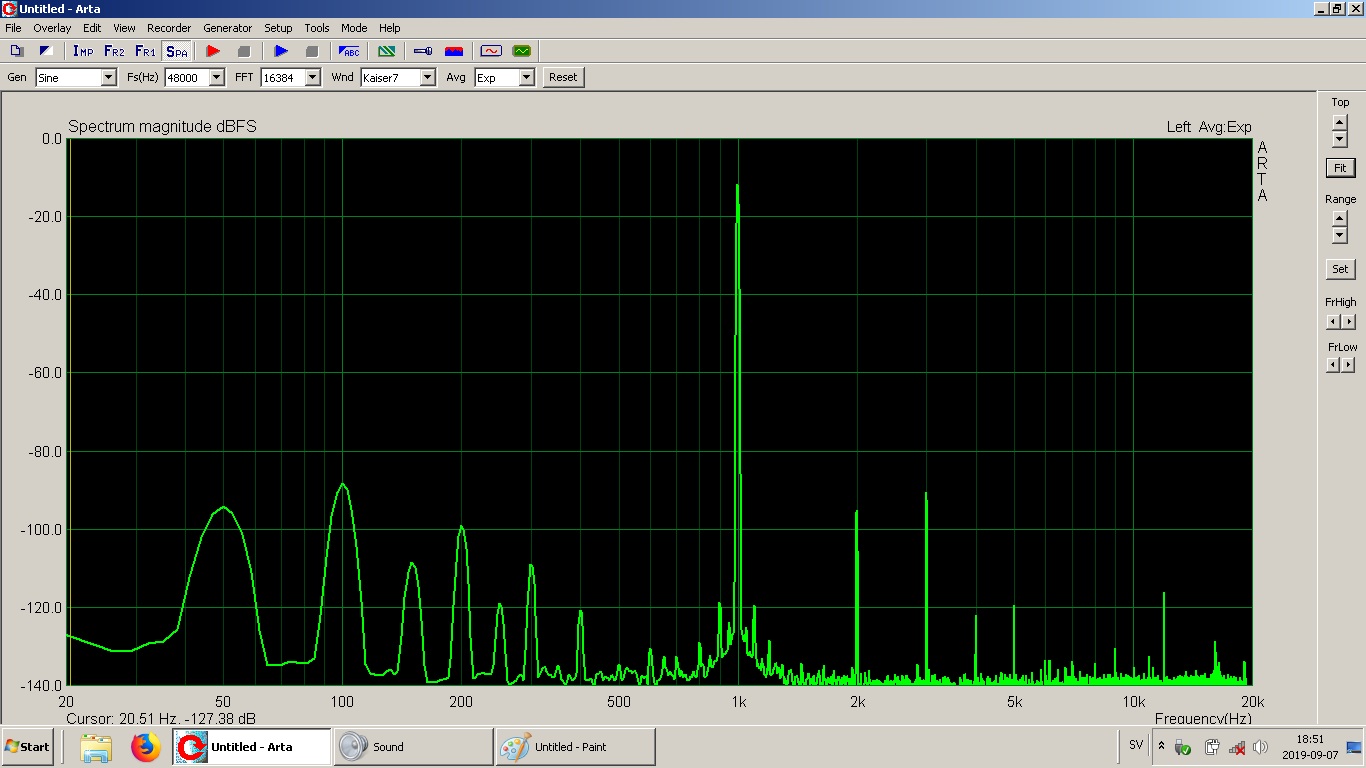

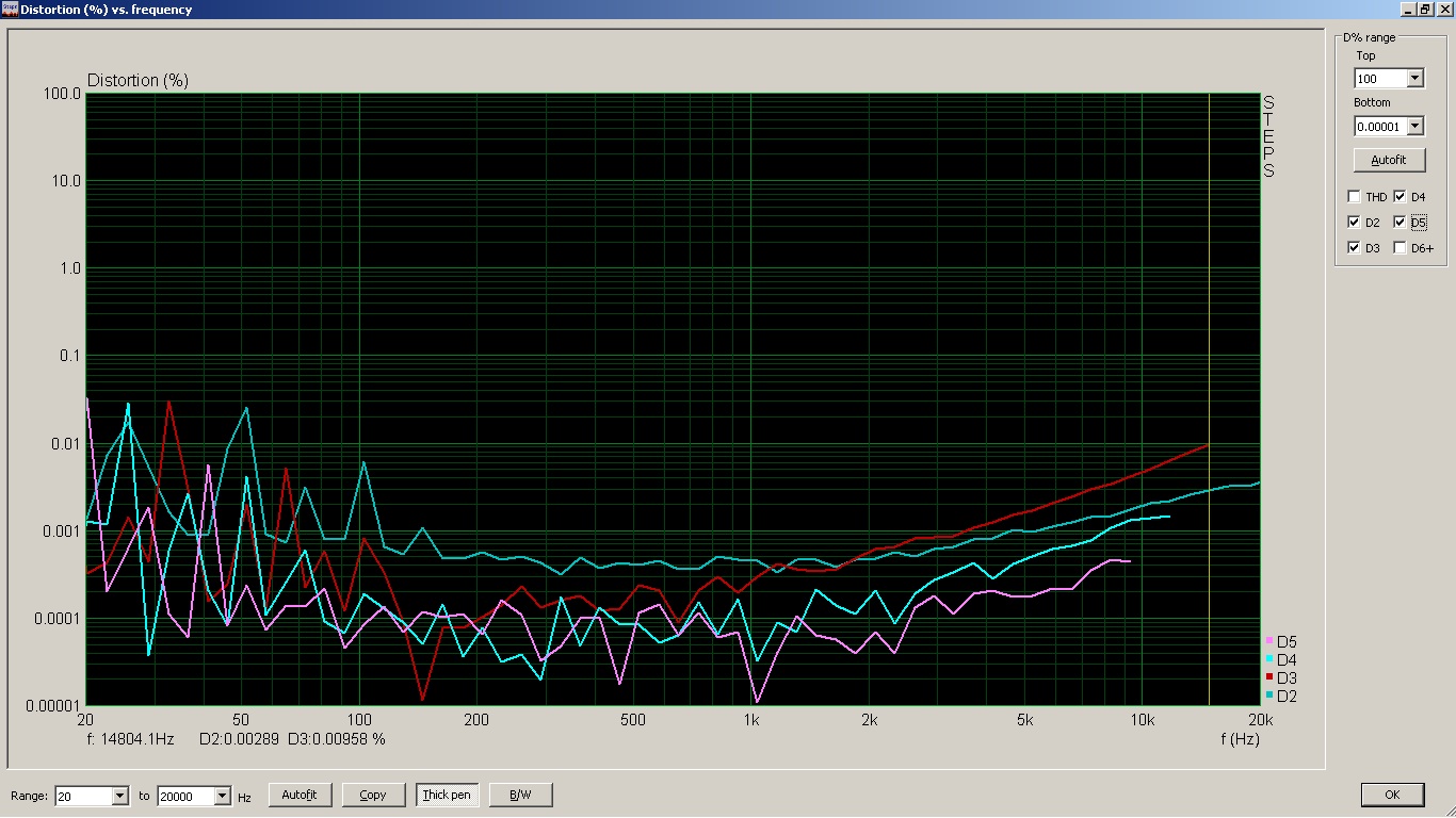

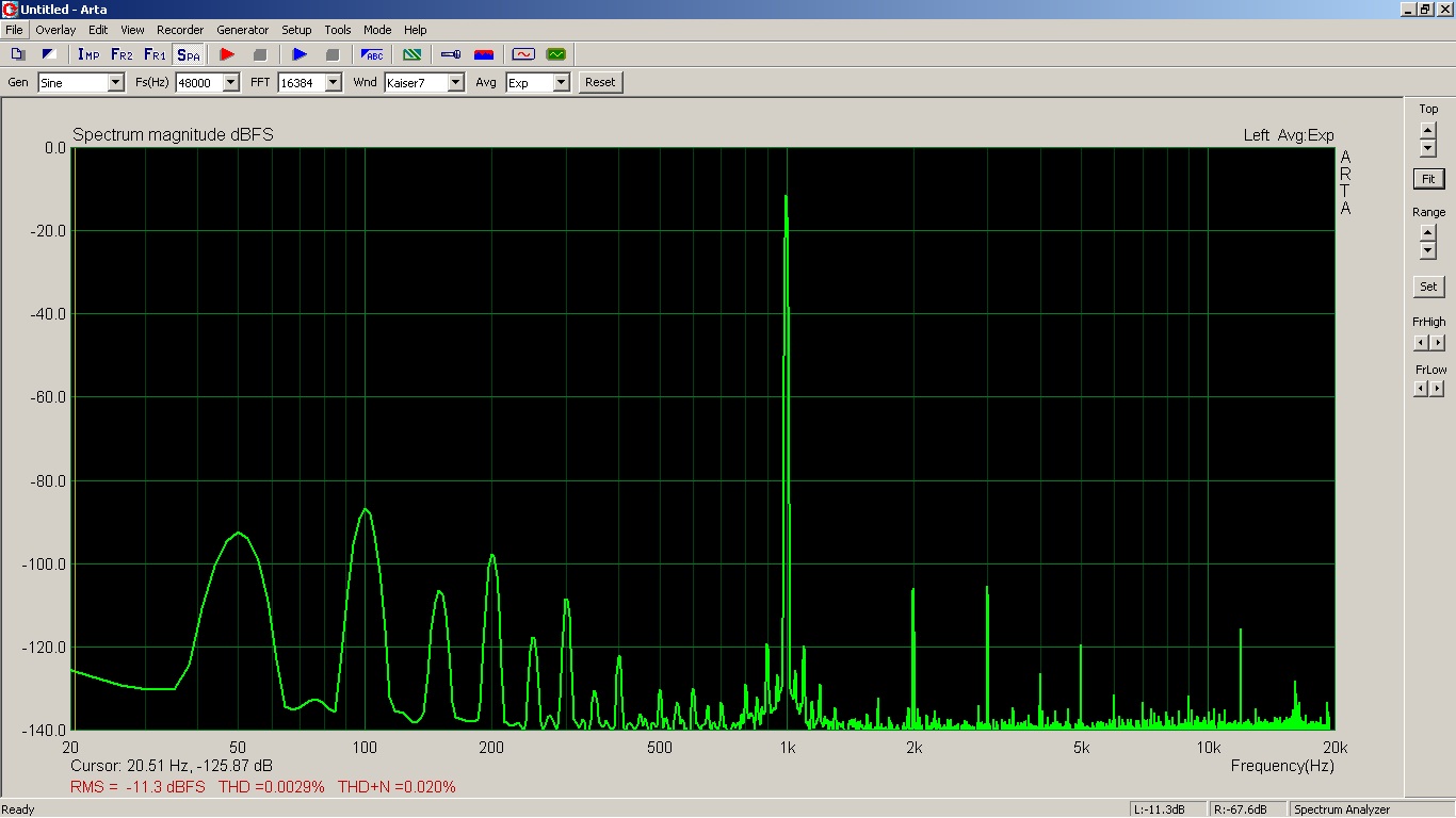

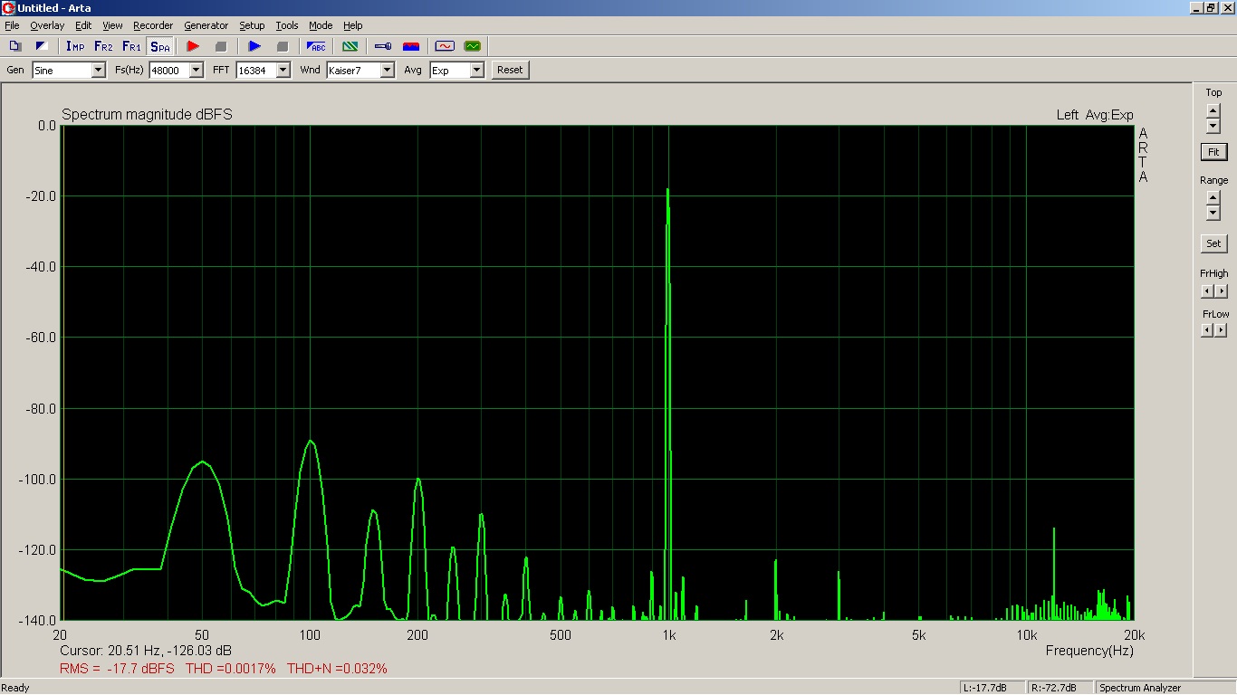

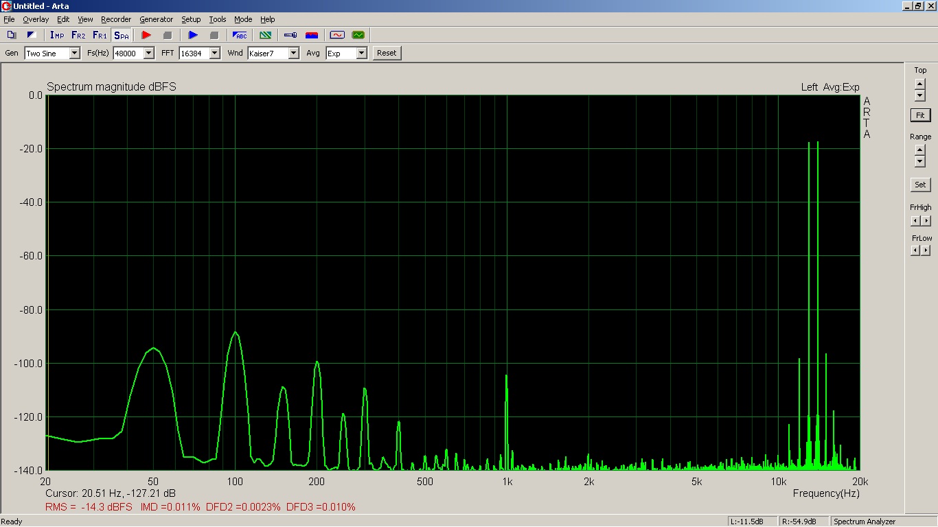

DLH distortion measurements
So, here are some measurements. I was not able to drive it harder than 8Vpp, due to limitation on the sound card output (get some distortion at max output), and low gain in the amp.
My basic measurement setup picks up quite a lot of noise, a lot from the 50Hz mains, something around 12kHz, and higher too, so please do not look to much into these areas. It also affects the THD calculation (in a negative way) seen at the bottom of the screen.
The 1k pot has been adjusted to give the lowest distortion. The optimal adjustment seems to differ between 4 & 8 ohms. Transistors are not matched. Capacitors are 'quality' capacitors, and resistors are metal film. The 'layout' might have some influence on the results too..
Power supply is linear CRC with 5x6800uF and 0,08ohm per rail. Wires to the amp board are a bit thin at 0,5mm2..
Filenames for the pictures explain the measurement condition (the picture of the board is before I added the gate resistors).

Truly surprised by the outstanding measurement results. I am very pleased to know that it is a variant with a very low IMD.
According to the settings I see, it should be very pleasant to hear the range between 70 Hz and 2 KHz, with a high range above 2 KHz quite detailed.
I believe that the diodes would do their job better by staying close to the bipolar transistors of the input circuit. It would be interesting if you measure if there are significant DC shifts at the output, after stabilizing a certain final operating temperature.
I think it is an amplifier that shows two very different faces: on the one hand, its extreme simplicity may not be attractive to those who are accustomed to expecting good results from more complex circuits; On the other hand, its outstanding performance seems unable to be associated with its extreme simplicity, surprising more than one experienced builder .

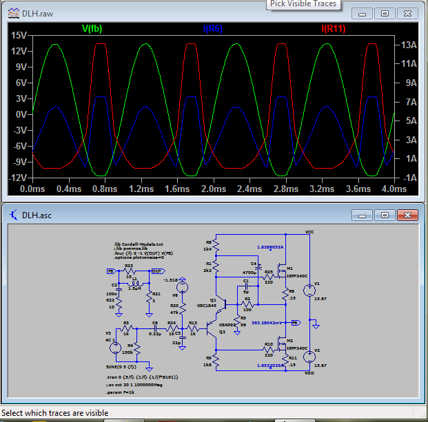

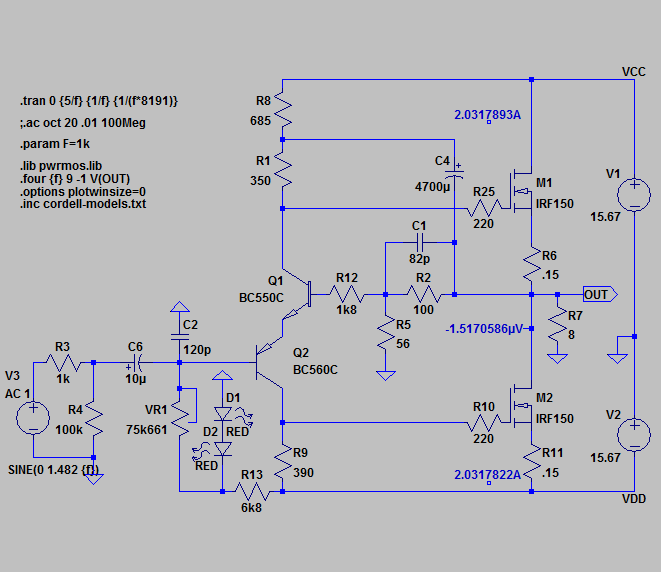

Bad news
Unfortunately, this circuit has a critical flaw as demonstrated by simulating it at clipping while viewing the FET current. At the somewhat premature negative clipping, both FETs become turned on resulting in a huge shoot through current.
I thought there might be a easy fix by adding an offset to the upper FET drive but that just results in premature positive clipping, albeit without shoot-through current. I also tried to move the BJT emitter voltage but nothing seems to help without alternate problems. The more I try to make this work, the more I think that circuits like it were abandoned years ago for good reason.

Well, I guess with it having the benefit of being a simple circuit, it has it's drawbacks too.
Maybe adding some limiter on the input preventing clipping would be an effective workaround to keep it simple? Maybe you can simulate a limiter circuit for it? Would be nice to get it with some different 'settings' depending on supply voltage.
Measurement performance seems good enough for the circuit as it is.
I see you have source resistors on the simulated circuit, probably limiting the shoot through current, wonder how it looks with the one I built without resistors?
I have never set out as a design objective for the DLH that more than 2 VRMS are injected into its input. According to what is observed in its simulation, the input signal would be close to 3.5 VRMS, almost 77% more than the original value of design. In addition, some values and components have been visibly modified. The generality of the conclusions would not apply here.
Please analyze the circuit as it was presented in its different variants. It is obvious that they all have limitations and that there will be cuts in the negative half-wave of the output signal, if the design limits are exceeded.

No, your design is good and produce beautiful music, it only needs safety protection for reasonable usage.
I can not understand why you are against an addition of a simple clamp to limit input within the safe 2VRMS level. Back to back parallel of 4 silicon diodes like 1N4148 in series should do it as a simple solution to protect against mishaps like source voltage being too high and static electricity, catastrophic to both speakers and amp. Show us a design from Pass, Hood or Hiraga that blows up at 3V input, or even 5V, except for Hiraga 30W VFET which has similar problem to the DLH.
Moreover, you give no warning on the first post to potential builders. I found you to be irresponsible to builders of your design. I consider it bad intention leading people on into a potentially disastrous (but actually preventable) incident.
