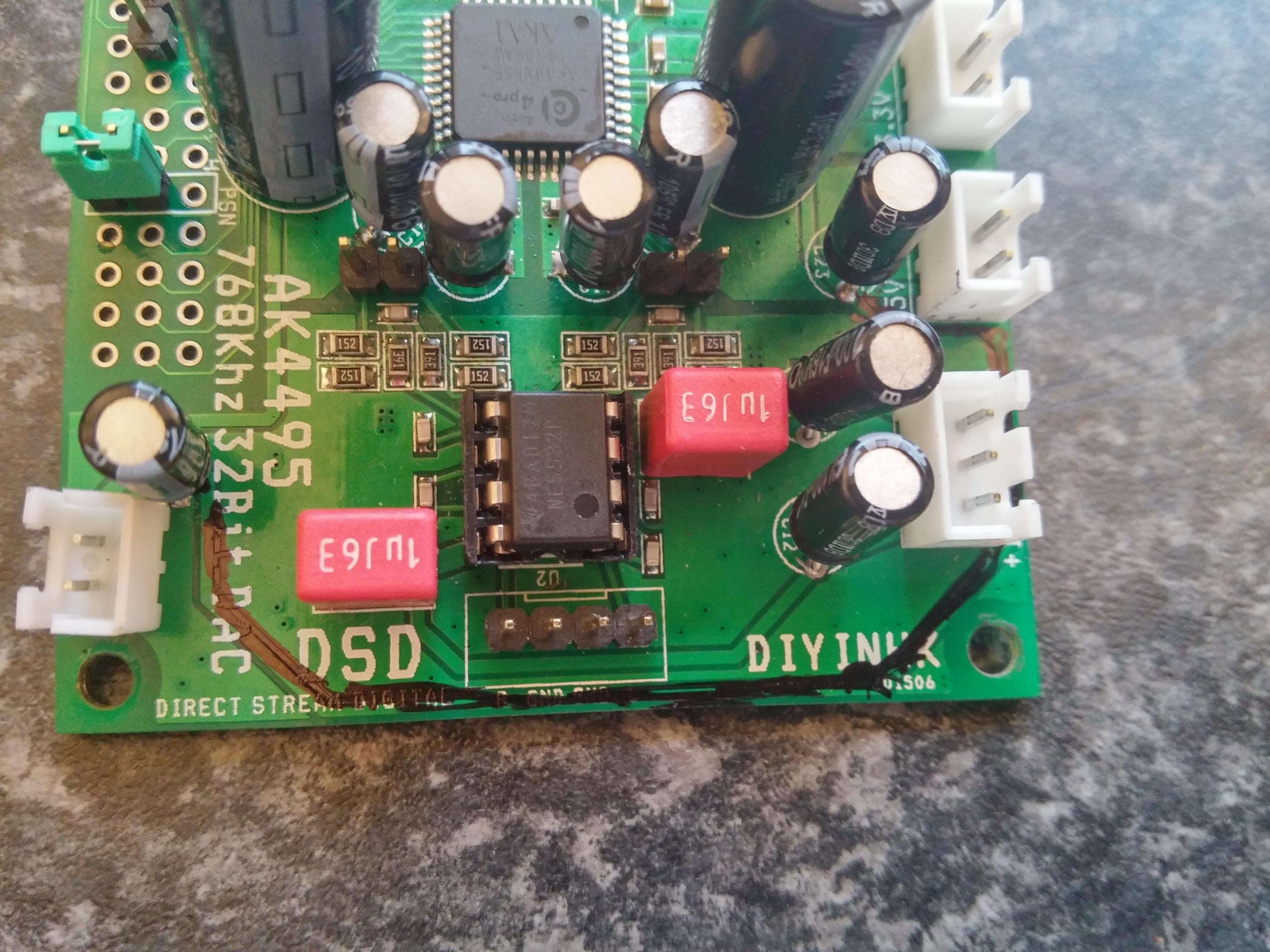

The DIYINHK AK4495 pcb has the option for 3 x 3.3v inputs & 1 x 5v input by removing a link at FB1.
I have done this & checked all voltages & polarity before plugging pcb but have noticed one of my 3.3v inputs has got 5v on it.
Thought it was a faulty power supply at first but found 5v at the pcb with 3.3v plug removed.
I have contacted DIYINHK to see if they can help.
Sent from my LG-D855 using Tapatalk
Hi Saheb I removed ferrite bead between 3.3v & optional 3.3v at DVDD theses 2 conections are fine both 3.3v.
but other side of pcb the other optional 3.3v AVDD I'm getting 5v where the 3.3v plug goes into the pcb.
what's strange is I asked DIYINHK if there was any other traces I need to cut first & they said no just remove the FB1 but if I trace pcb 5v input & 3.3v input are linked both + go to + side of 100uf capacitors after the + input sockets.
I will add a picture and draw a black line.
