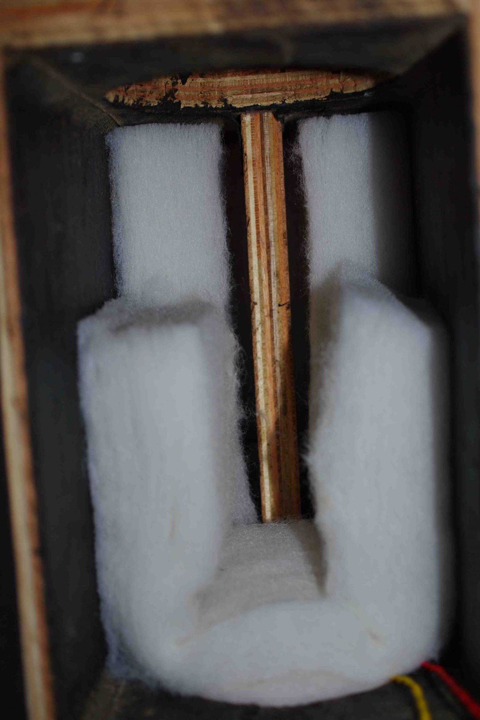

Hi, what about the filling material to be used here. I have the walls lined with bitumen sheets like I always do. The cabinet is nice and solid.
I was planning to go with 2" polyfil on:
a) entire rear panel
b) top
c) bottom
The port has a 2" clearance from the inner top of the cabinet and that space should comfortably take the filling material. The material will be fixed to the walls with velcro which I've tested and works just fine.
What do you guys think ?
Cheers

Have a look at this post and sketch (also posts #115 & #116).
http://www.diyaudio.com/forums/multi-way/143326-kit-australia-6.html#post1837618
The damping is in a "L" shape so the damping sits in the box away from the wall behind the woofer. It also allows a clear path from the woofer to the vent tube. You could use a "Z" shape if you desire to line the top also but it's not necessary plus it could fall over the vent inlet and block it.

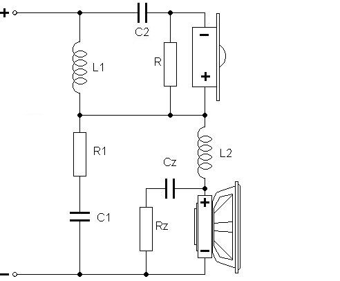

Higher order xo on tweeter
You can increase the slope of the tweeter as follows and reduce the power to the tweeter to less than 25% of the original AR crossover below 1500Hz to Fs.
Add:
C2=8.2uF
Cz=3.3uF
Rz=8R2
R not required
C2 increases the slope and alters the crossover point, Cz and Rz is an undersized zobel to help with slope shaping and phase of the woofer at the xo point. You can try it with C2 only to see how it sounds but I think the addition of the zobel will help with the sonics.
See the schematic below and other values as in post #180.
diyaudio-reference-speaker-project-post #180
A more robust tweeter could be used with the above changes and the SEAS 27TDFC could work well as is well regarded for sound and power handling (maybe even a Vifa DX25TG-05-04). Both tweeters would need the addition of a damping resistor R=15R.
C2 would have to be a good audio quality metallised polypropylene (MKP) as there is now a cap directly in the signal path. Mundorf M-Cap are ideal for this location but Jantzen, Solen etc can be used. Cz is not critical but still use an MKP if possible.

Alternative to the alternative
To take even more load off the tweeter the crossover point can be increased higher by using a smaller cap at C2.
C2=5.6uF
R=15R
R1=5R6 maybe but tweak for taste (try existing 6R8 first).
No zobel is used (Cz + Rz).
This reduces the power at Fs much more by reducing the level at Fs and R dampens the tweeter and lowers the impedance peak / resonance at Fs.
As before, the tweeter is connected reverse polarity.
Unlike the other crossovers I haven't trialled and tested these but have only been modelled to give similar FR results to that in post #180.

The use of the "R" resistor
Some harshness can be reduced by using the damping resistor R=15R. When doing so you have to reduce R1 to 5R6 to bring the tweeter level back up to compensate for the additional SPL reduction of the tweeter.
You can try different values for R between 10R to 22R.

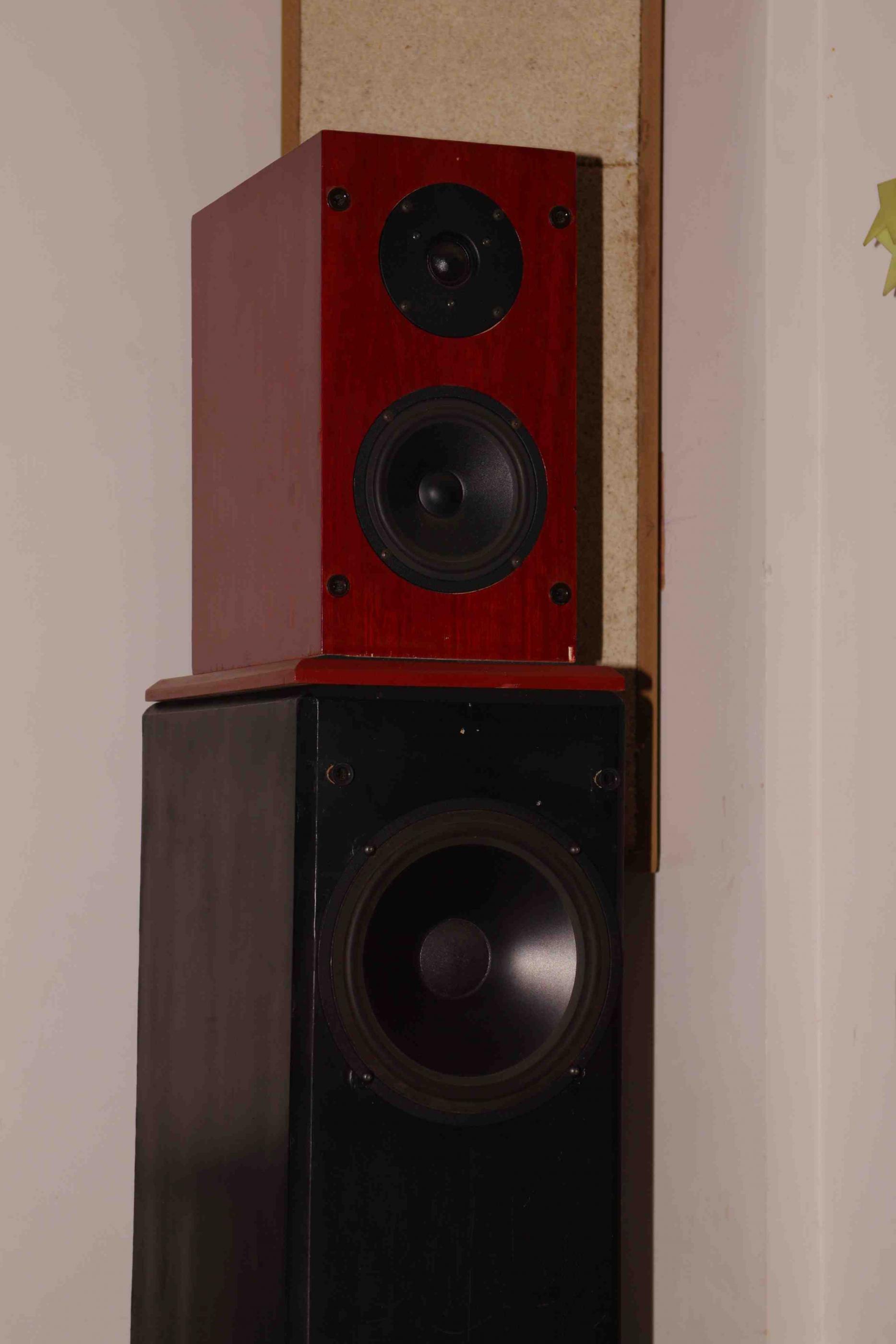

This is what I finally ended up with
The cabinet was modded of an originally TLB tower so the volume ended being 10.91 lt with port dimns - 1.75" dia /4" length. The drivers are D27-TG-35-06.
Thanks for the new X/O's. At the moment I'll keep this setup going. Since the drivers have'nt been played for a while, they get better every day. Even today is a big difference from 4 days back. I'll live with the vol .restriction for now.
I'm posting some photos next.

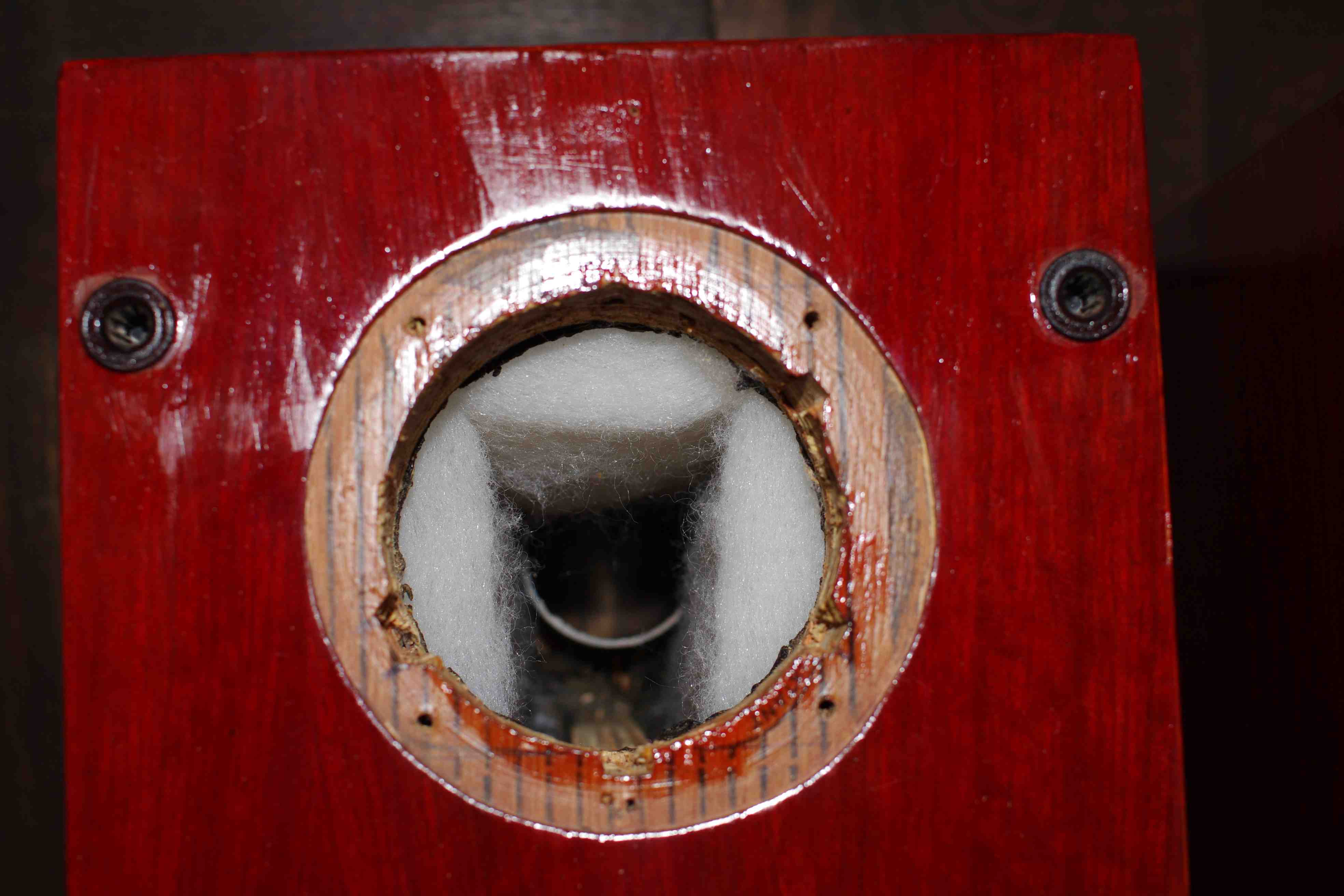

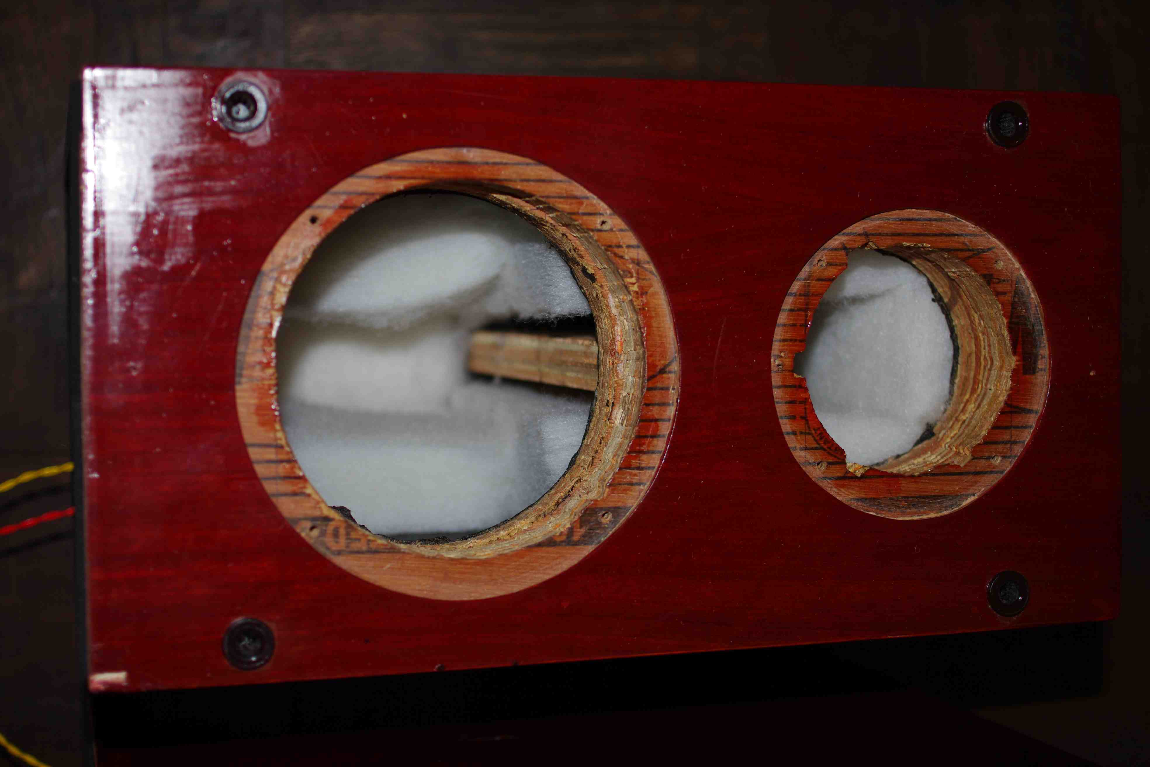

Heres the photos. This is a 10lt cabinet based on the original "reference speaker project". The AR series x/o designed by Rabbitz was used. The final setup is crossed over at ~240hz via a 'Behringer 2310' to a ported Vifa P21 in a 42 litre cabinet. The sound is fantastic and it can handle a good bit of power.
The TW/Mid was initially run via a 3875 GC. Switching to a 4780 was much much better.
The walls have a 2mm bitumen pad which makes the cabinet dead.
