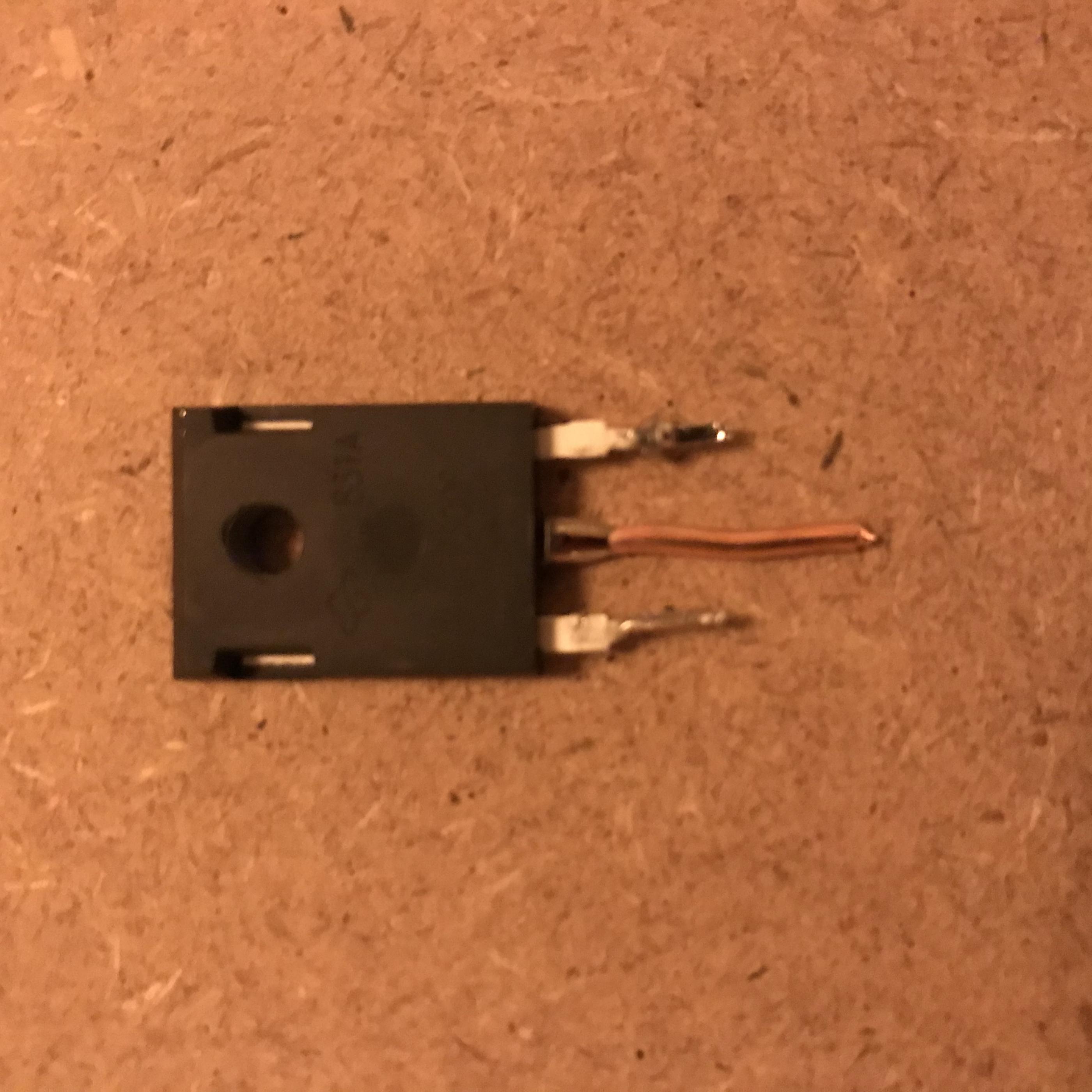

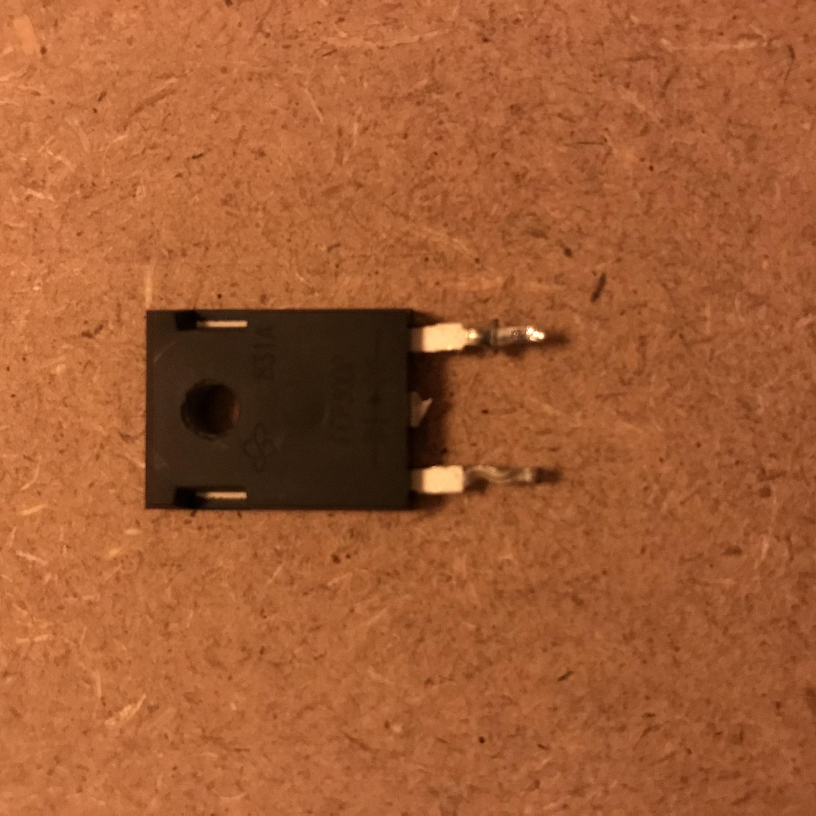

depending how close you cut, you might be able to solder an extension leg, and still use the didoes...
Great! It worked :)
Please see the photos attached, I just used solid core copper wire to solder a leg.

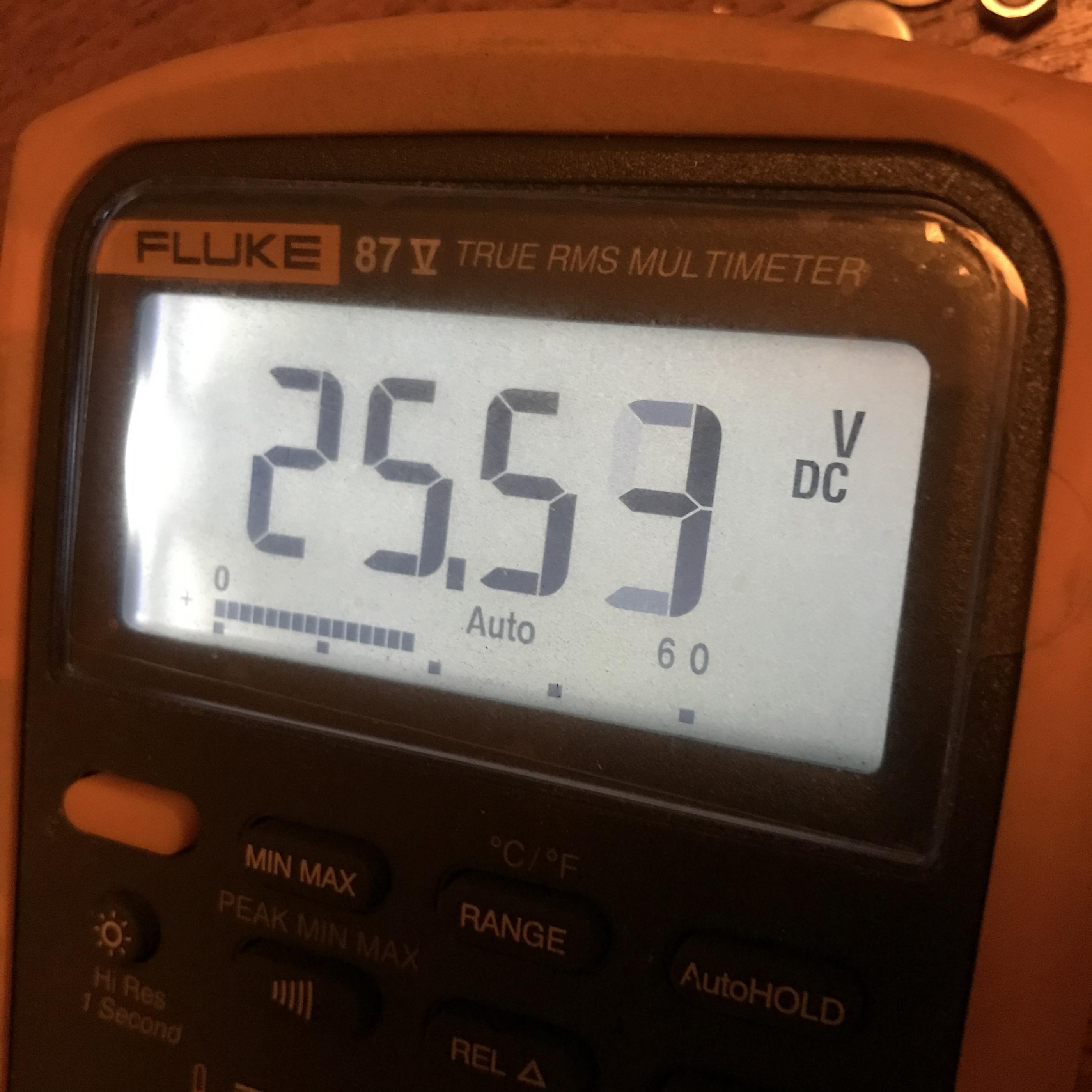

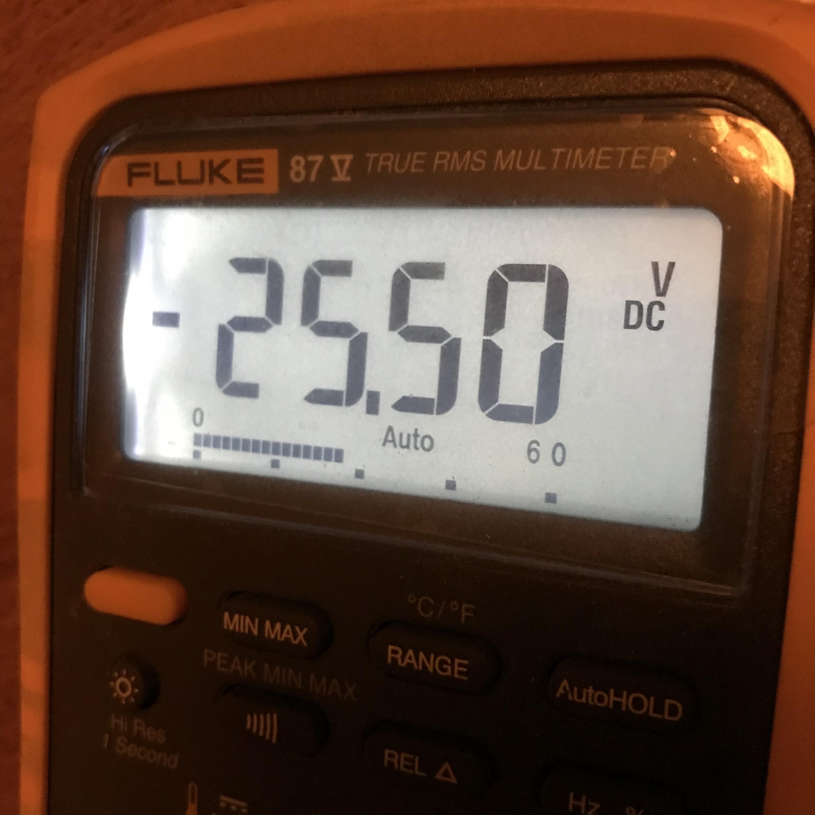

PSU is up and running thanks to you guys!

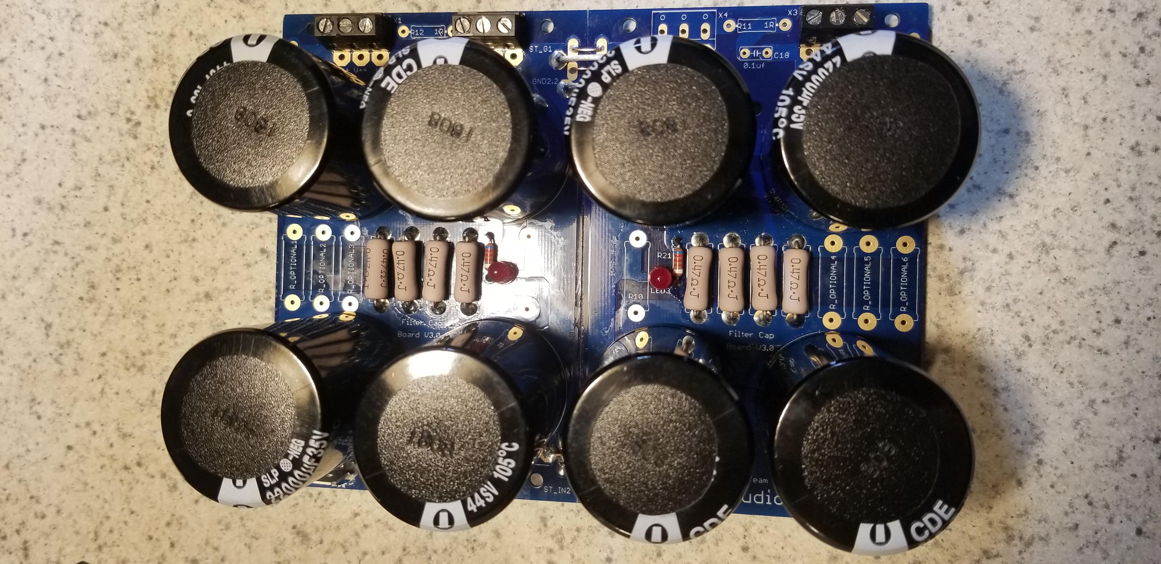

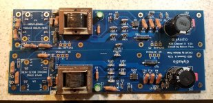

I finished the main amp boards and most of the PSU. I'm going to work on the layout in the deluxe 4U chassis. My plan is to mount the PSU on the chassis floor then I'll get some temp wiring done for a test with a dim lite and I have 3 MM also for testing. I've read all the M2x posts from the start, but I'm going to review the initial start up procedures and tests to be sure I get it before I start.
I have a couple of questions please.
The trimmer prongs were offset I bent the middle prong to line up with the 3 inline holes on the PCB. Is that OK?
I bought high intensity LEDs which I put in with the 6.2K resister. It's all I got, it will be bright which I'm going to convince myself and others that it's very cool:cool:
You see my macho resisters? I now understand the sizing system code of them. I'll be wiser on the next project.:rolleyes:
Well I thought I would easily find what the lettering means on the Dale resistors. Not! Apparently I need to order the correct size. I'm having a hard time finding out how to read a Dale. The ones I have are 14.27mm long. I assumed the lettering on it 1740J RN65C would be a code to the size. I don't think so. What does it all mean? The part I get is 2210F. I'll keep looking. Maybe because it's military spec.
