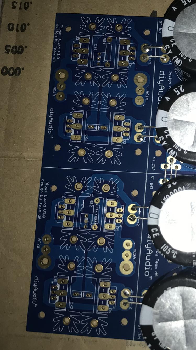

Transformer -> Diode board
Hello All,
I have been searching for where to connect the secondaries from the transformer on the diode board. I have seen lots of great photos from other PSU’s, but I can not get a clear view of where to connect the plus or minus.
On the diode board I have the following connections, where I think the following secondaries from the transformer must go, is this correct? (Please see the attachments for the data sheet and if photos).
• AC1A (Yellow 0v)
• AC1B (Red 18v)
• AC2A (Grey 0v)
• AC2B (Blue 18v)
Thanks in advance!
Koos
Hello All,
• AC1A (Yellow 0v)
• AC1B (Red 18v)
• AC2A (Grey 0v)
• AC2B (Blue 18v)
Thanks in advance!
Koos
Correct! Your secondaries are AC so no +/-
@silasmellor, thank you!
Ah yes, AC is 18v on all secondary wires!
Does this actually mean that it doesn’t matter where to connect the secondaries, either side of the diode board is ok?
As long as you keep the pairs on the same half as you specified it shouldn’t matter.

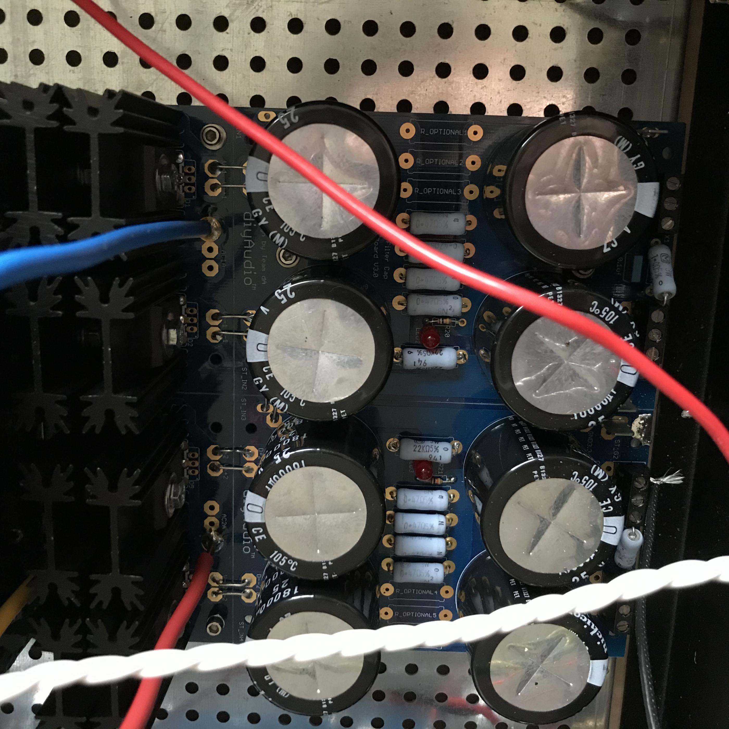

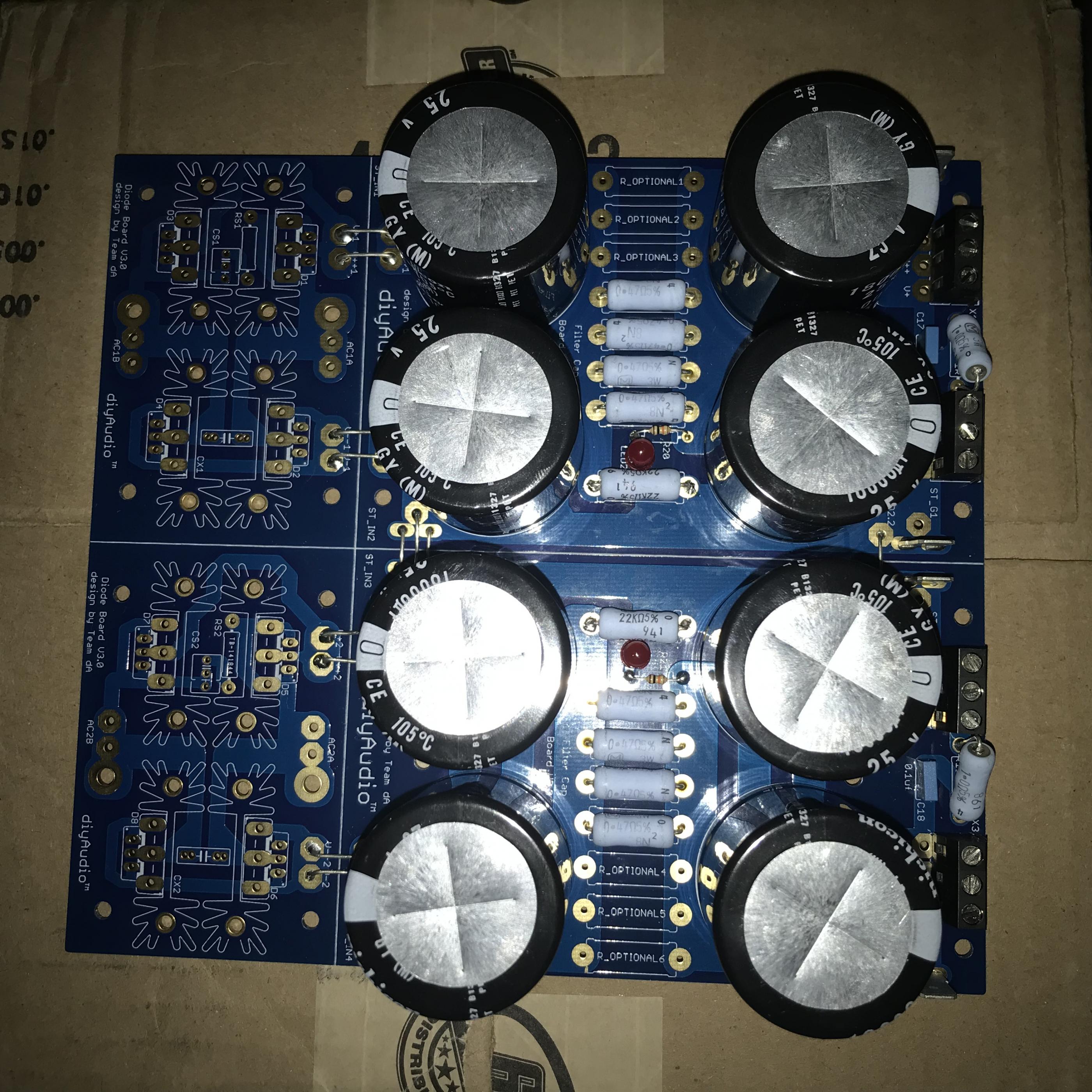

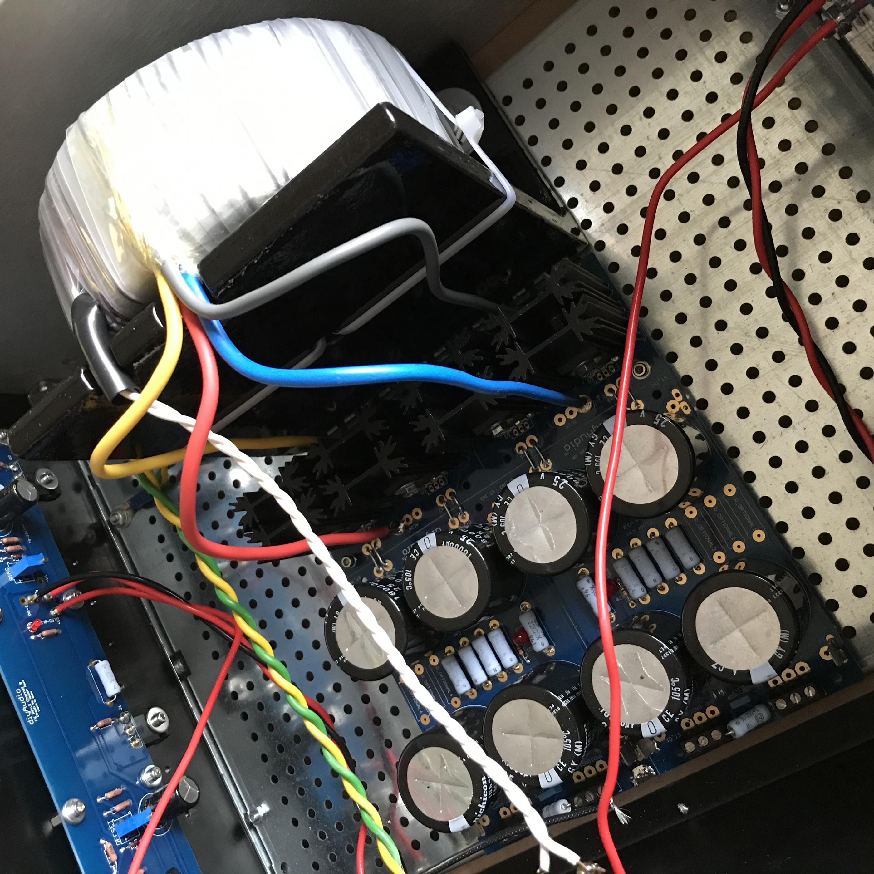

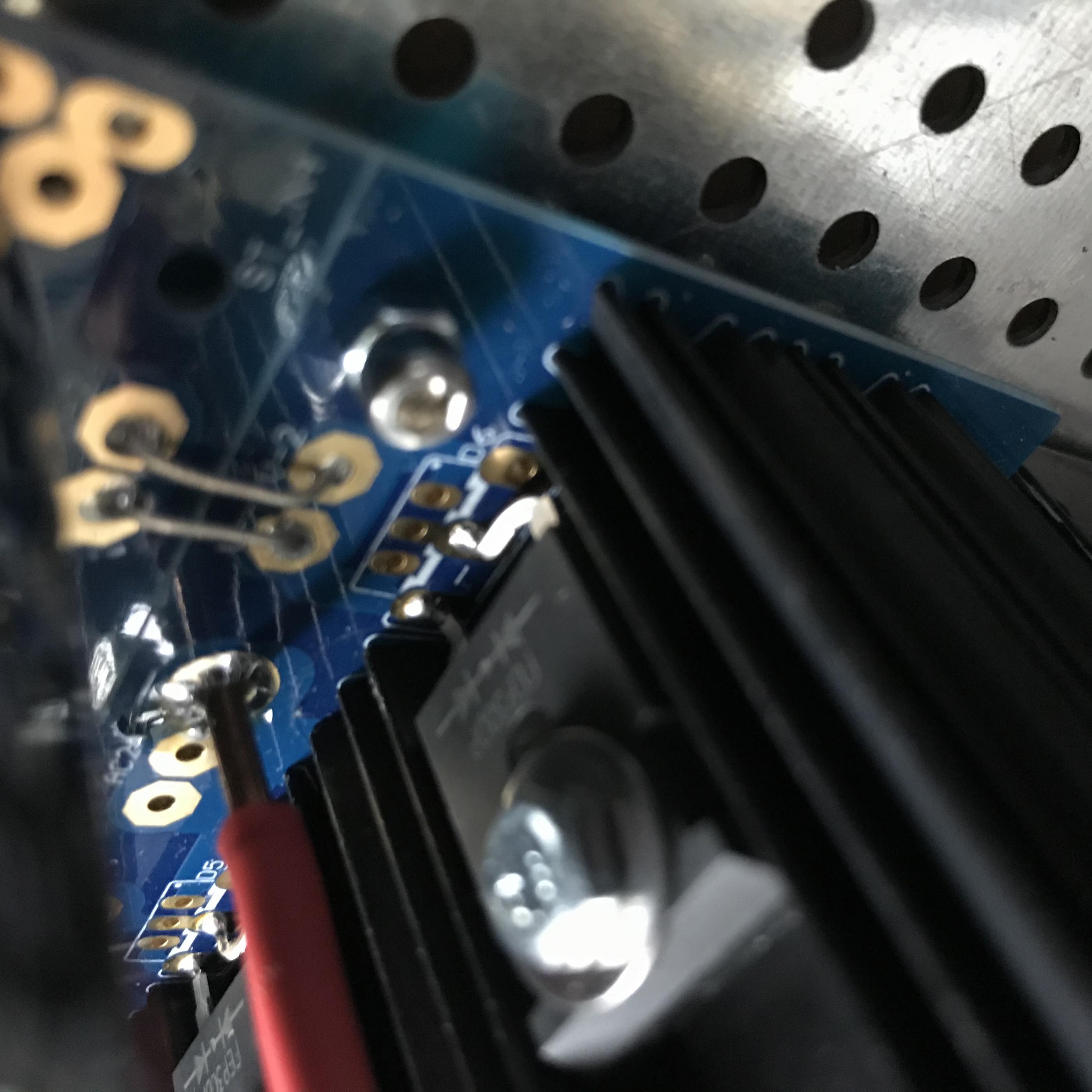

No DC voltage output from diode board
Hello All,
I am making good progress with my FW F6 build, really enjoying it!
But now I ran into a showstopper when powering up the PSU.
I get 230V AC to the transformer, and I measure the following at the diode board inputs:
- Between AC1A and AC1B: 18V AC
- Between AC2A and AC2B: 18V AC
- Between GND and AC1A: 36V AC
- Between GND and AC1B: 20V AC
- Between GND and AC2A: 36V AC
- Between GND and AC2B: 20V AC
When I measure at the diode board outputs:
- V+ : 0V DC
- V- : 0V DC
Could there be something wrong with my diode board, did I solder the diodes at the wrong connections?
Please see the photos attached for reference?
Any help is much appreciated, questions are welcome.
Thanks in advance.
Koos
Hello All,
- V+ : 0V DC
- V- : 0V DC
Thanks in advance.
Koos
Looks like FEP30DP but according to data sheet they should be 3 legged, so must be something else. Please tell us which diodes your used. Looks like a diode polarity issue you me.
Hello Silasmellor,
Thank you for your quick reply.
I used FEP30DP-E3/45GI-ND (according to the BOM, I used the Digikey order number) and connected them according the photos in the first post of this thread.
If any other information is required please let me know!
Thank you.
Koos
I cut the middle leg off, as was done in the photos of the build post.
Koos
