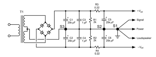

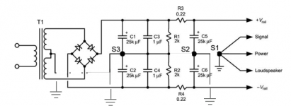

I am preparing to build a pair of 200W mono amps. I will be using diyaudio’s Universal PSU V3 cards in the power supply. In Bob Cordell’s book Designing Audio Power Amplifiers, in the section on power supplies, he suggests using what he calls star-on-star grounding techniques. I have read all the posts in this thread and have not found a discussion on star-on-star grounding. I have two questions that I hope are not too naive.
Question one has to do with schematic notation when showing star-on-star grounding. In the first attachment I have copied a figure from Cordell’s book where he shows the multiple grounds as S1, S2 and S3. Am I correct in assuming that the actual wiring will look like the schematic shown in the second attachment where the individual grounds are brought to a single star ground point?

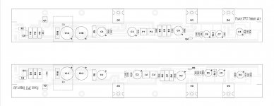

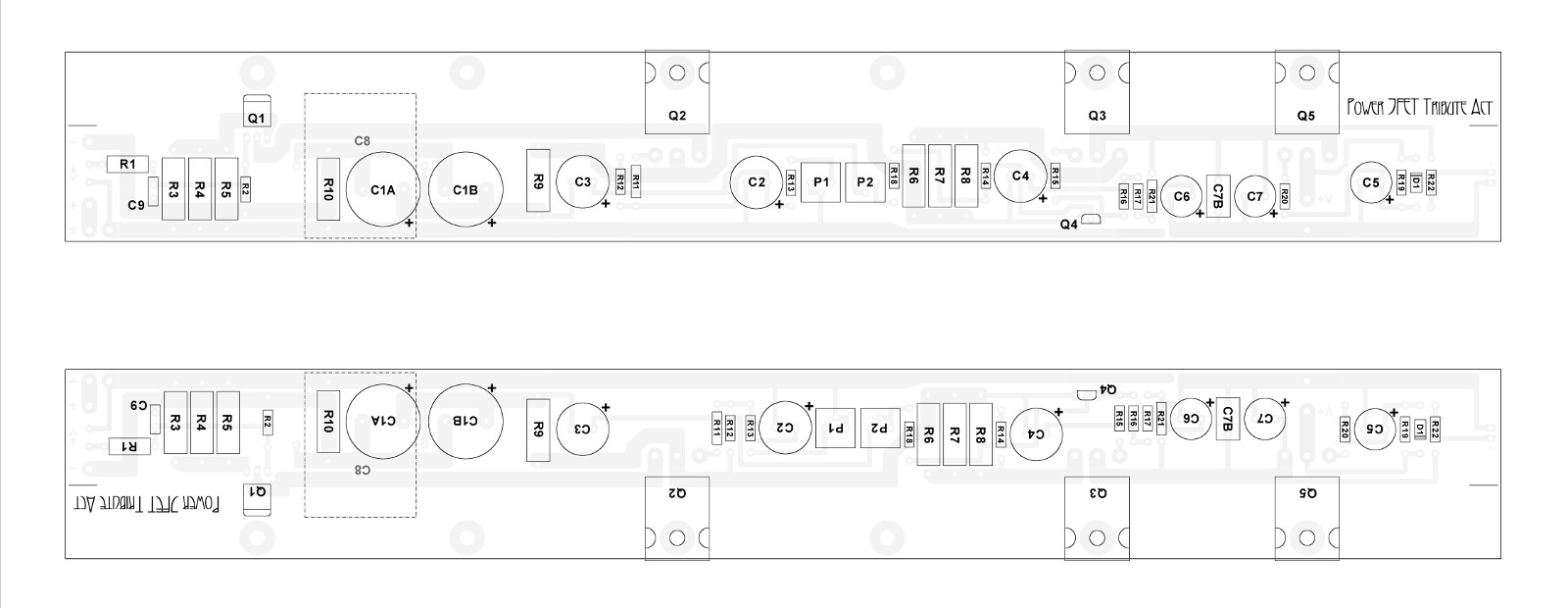

Question two – Based on the schematic and inspection of the board for the Universal PSU it looks like it will not be possible to implement a wiring scheme where the grounds for the two sides of the CRC filters are separated. Is that correct?
Any advice would be appreciated.
ceulrich
Your left diagram is correct. S1 in this left diagram is the Main Audio Ground (MAG).
Do not use the right diagram. Routing the wires to a remote star increases the loop AREAS and thus increases the EMI.
