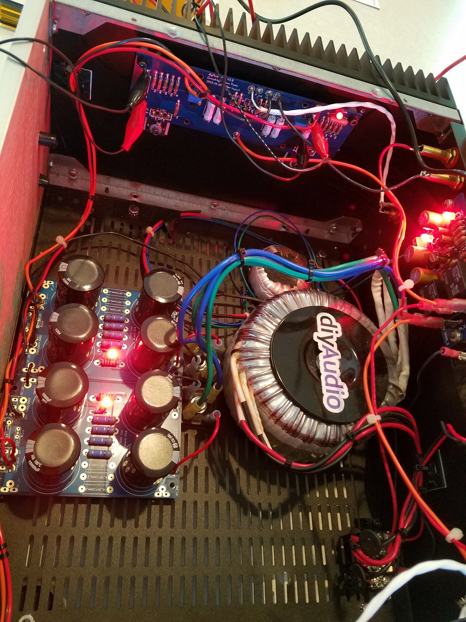

Power Supply is hissing and spitting at me...
I'm using spade connectors crimped on to the wires coming from the transformer secondary. One of them has started sparking where it's connected to the rectifier block (large blue wire on the right). I re-seated and De-Oxited all of them but it's still doing it. It seems to do it more on startup, then settle down. There is no scoring of the metal, no evidence of excessive heat being produced.
Should I just solder these, or is this indicative of a problem with the rectifier?
Bad connection, spade terminals should be very tight if you insist on using them
Thanks, I tightened them up and it stopped doing it. I'll have to get around to soldering but I like to be able to disassemble it.
