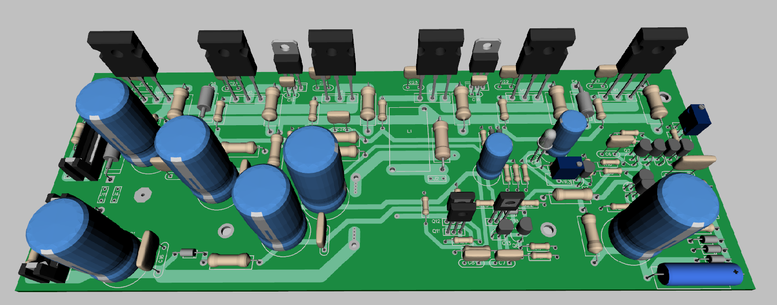

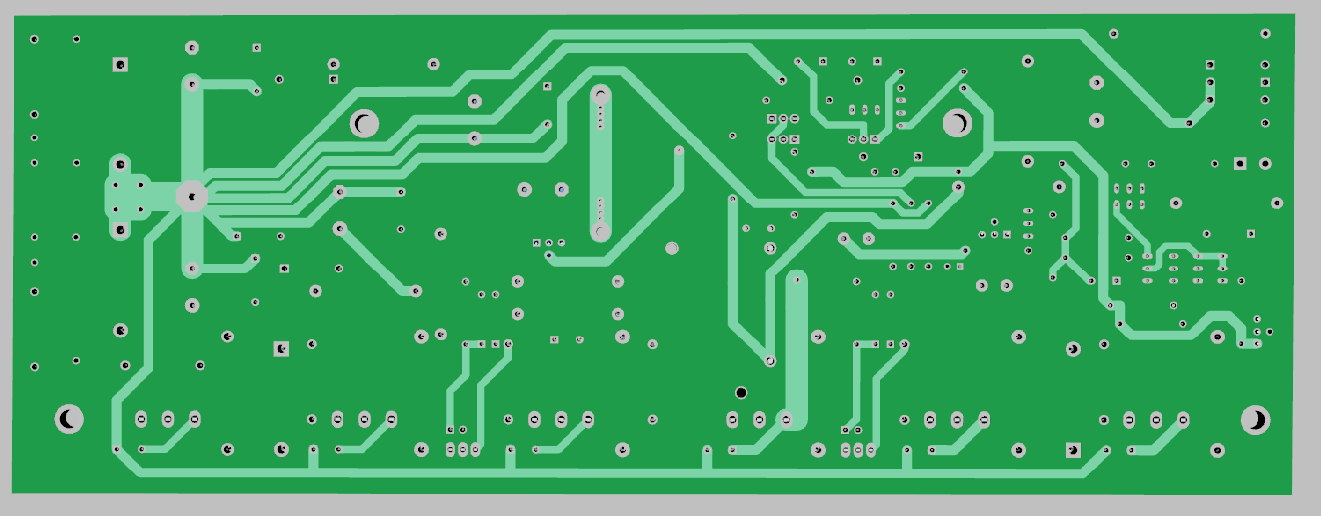

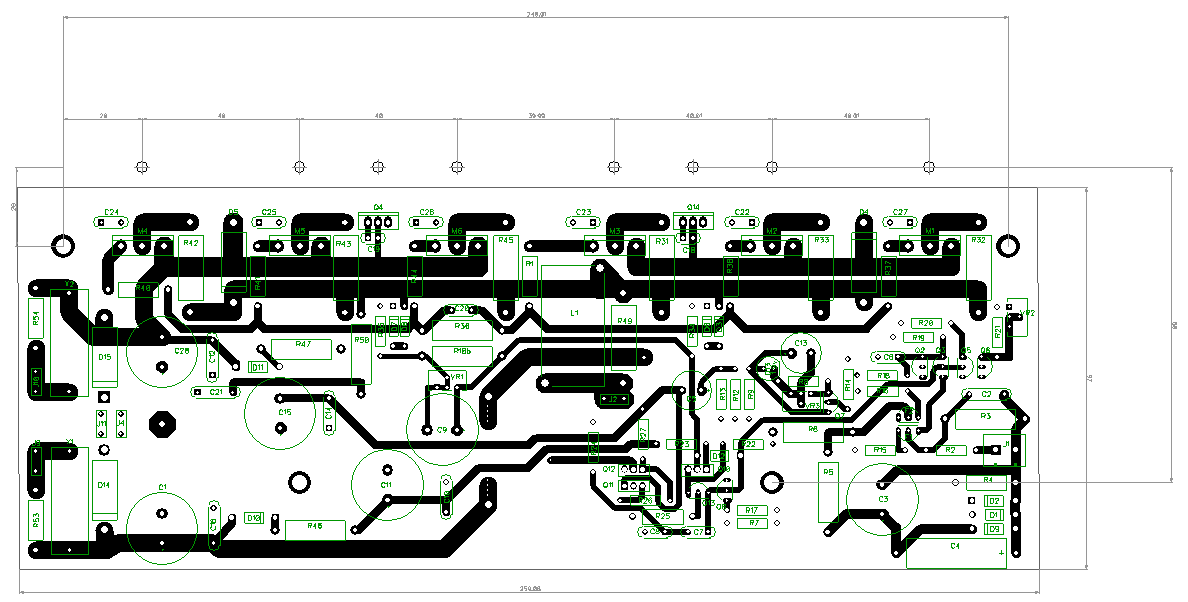

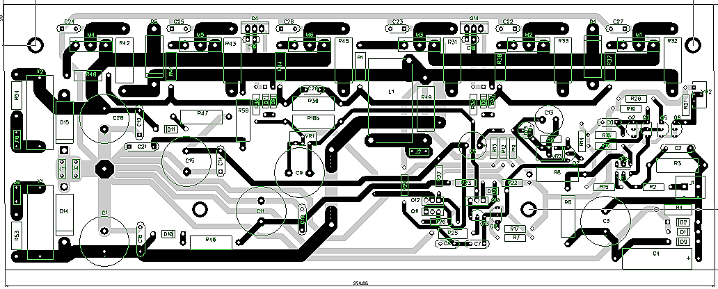

EXICON LateralsWhat output devices are you using?
Finaly the layout..... as usual comments are welcome.
The power devices are far away from the PCB edge. How are you going to mount them to the heatsink?
