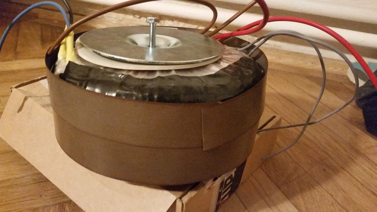

Transformer shielding
While I was building my HB, I was ordering a custom transformer for it, since I also needed 24V AC for my speaker protection board.
The result is two 45V/12A secondaries, and a 24V/3A
Why 3A secondary? you might ask
The answer is simple: As soon as I told the transformer winder that It is going to be made for an amplifier, he offered me to oversize the 24V secondary for free to not to make so much electromagnetism near the transformer itself.
Tip of the day:
When I went for the transformer, as I got there, I asked for additional SCRAP MU METALS.
They happily gave me like 5 meters, since there is always some scrap material in the process of making toroidal transformers.
Why do you need Mu metal?
Because if you care about fidelity, and ultimate sound quality, you should cover your transformer first with a lot of insulation tape (not to short any wires), then with the mu metal, which will act like a shield against the electromagnetic force.
Simply mount them with double sided tape, and voilá, you shielded your transformer more, thus making easier to make the cable management.

Hi Obisix,
... he offered me to oversize the 24V secondary for free to not to make so much electromagnetism near the transformer itself.
I don't understand how this would be true. I'm not disagreeing with you, I just don't understand how making a winding for higher current would reduce the magnetic flux around the transformer.
-Chris
Maybe he meant more windings, less regulation?
This is what I meant! Sorry, my english skills are not really great!
Sounds like you have great luck Obisix, I don't know why anyone would give away even just 5 meters of mu metal. Maybe here in the States we are just pressed for cash.
I don't know about the States, but here in Hungary, everyone is helping each other since we know that our salary is really bad, mine is 300 USD a month (full time job). So maybe yeah, but it is worth a try to ask for it!
I don't think it's mu metal if it's used for toroidal transformer production.
One easy way to test that theory is to bend that metal. If it bends easily and holds it's shape, it might be mu metal. If not, probably steel.
-Chris
It bends easily, and holds it's shape. Also the brownish color turns white immediately after the first bend, it crystallizes easily. The guy making the transformer told me that this is Mu metal, what he uses in toroidal transformer making process. "This is the material we use for the core" he told me.

Hi Obisix,
I can't figure out why he used that for a core material, but Jeff's right. It certainly isn't what you would consider using for a core! It would only generate eddy currents, not a magnetic flux worth talking about. But hey, it sounds like you have some mu-metal there.

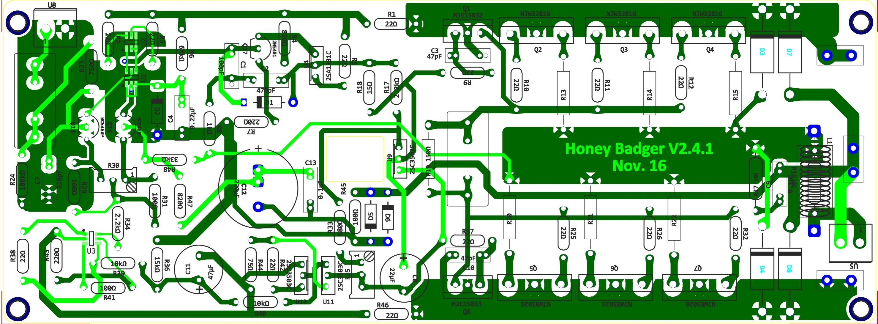

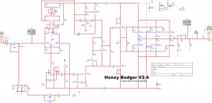

I am trying to figure out how and where the Honey Badger was improved since the build guide was written (I have the V2.4 boards).
Here are a few things I found in the main thread, but I am not sure if this is everything as the thread is a bit long:
Is this list complete? And what's the "diode fix"?
(And would it be a good idea to update the build guide?)
