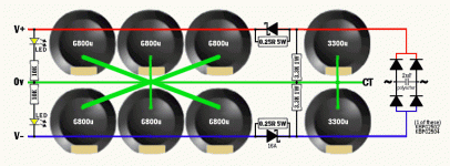

what is the purpose of the resistor and the diode?
The purpose is to help a CRC supply throughout the wide dynamic range of a powerful amplifier. So, the plan is to reduce noise, not bass. It would be easier to say how to select those parts:
Optimize the resistor value for best audio quality at modest/normal levels
Optimize the bypass diode forward voltage drop (0.3v~0.9v) for best audio quality at full blast
for me, tie all caps together for the positive and negative rails, and make them meet the center tap pad in one place.
That is very doable for the high capacitance tank/reservoir section. Thanks!
Personally, I would expect 1) to be preferred in your choices. All PCB traces have resistance proportional to their length (for a given width and thickness).
Thanks!
So, more like this?

Hi Daniel,
Firstly, the 3K3 resistors need to be rated at more than 1 watt. This limits the rails to +/- 57.4V DC without a safety margin. You don't mention your chosen rail voltage level. Either increase their resistance, or increase their power rating. I would aim for 75%-80% of their maximum power rating in the interests of reliability.
Secondly, the star connection arrangement to the 0V point on the first three capacitors should possibly be duplicated on the + and - rails.
The 3.3k resistors will matter less than normal line voltage variations will. If you are concerned about them, then you should be even more concerned about whether your mains voltage is constant or not. For the vast majority of applications it doesn't matter, and if it does you should be fixing what's broken.

Isn't the purpose of the "3K3" resistors to discharge the PSU capacitors within a reasonable time period after switch-off to permit safe servicing of the amplifier?
Regardless of mains voltage variations, these resistors need to be correctly dimensioned in order to avoid their overheating. Depending on the selected output configuration, the DC rails may lie between +/- 35 and +/- 85 V DC.
At 85V per rail, each 3K3 resistor will be required to dissipate (85^2) / 3300 = 2.2 W.

Those "discharge" resistors do several things.
The one we want is to discharge the capacitors after Power OFF.
The various things we don't want, include; increasing supply ripple, increasing power dissipation inside a casing, increasing the power drawn from the electricity supplier.
These last three can be very important and can all be avoided.
Use a normally closed relay to connect the discharge resistors during OFF periods.
Use a lower power trigger circuit to switch out the resistors during ON periods.

Thank goodness for LEDs :) I adopt option 2) but with higher discharge resistance and no LEDs (yet). Good point about the fuses blowing.
The resistors need to be sized so it has a fast enough time constant. So what is a good one? 30 seconds, 1 minute? Maybe a CCS diode would be a better option than a resistor, as the discharge won't slow down when voltage gets low, so you waste less power for the same speed of discharge.

Yes. And, thanks for the calc. Okay, here goes. Because of the amplifier, I'm starting with a voltage estimate of 65vdc.
65*65, then divide resistor values in ohms till I come up with 75% of a watt is 5600 ohms. 5k6--is that okay?
Also, in calculating the LED's, 1.8fvd, 65vdc, 7ma, I get 9k, which is likely to need 10k after they get warm. Is that okay?

Hi Dan,
5K6 / 1W would be fine. It would just take a little longer to discharge the capacitors, but that shouldn't be a problem. Having two resistors, one per rail, means you would "waste" 1.5 watts in total.
For the LEDs, (65-1.8) / 10K would give you 6.3mA forward current and the series resistor would dissipate (I^2 x R) just under 400mW.

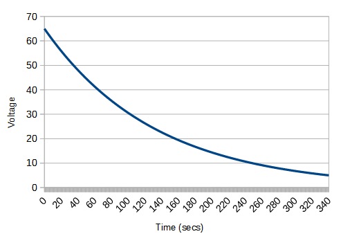

To get an idea of the discharge time, it would take around 340 seconds for 65V rails to drop to 5V due to 5K6 discharge resistors and 23700uF alone.
This ignores the amplifier's operating current and quiescent current drain on the capacitors which would reduce the discharge time as AJT stated. However, a blown fuse between the amplifier and PSU can occur, in which case only the discharge resistor would be effective.
oops. That's a little inconvenient. Or, possibly "most extremely inconvenient" if the LED's also got cooked previously.
