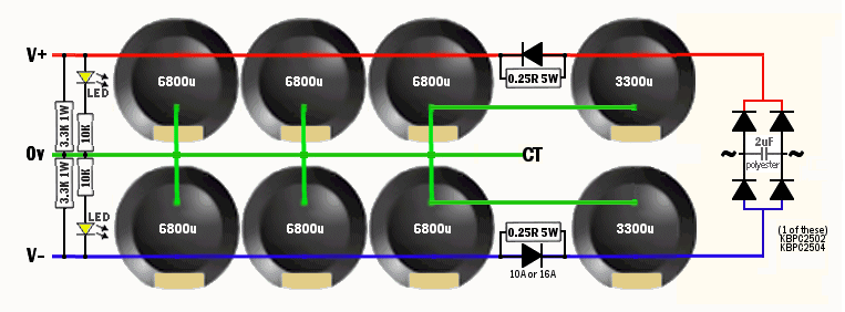

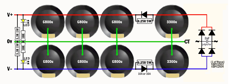

Power board layout question
Which performs better with a center tap transformer?
1). This?
2). Or, This?

Personally, I would expect 1) to be preferred in your choices. All PCB traces have resistance proportional to their length (for a given width and thickness). Option 2) has additional 0V trace length in series with the 3300uF capacitors, and consequent series resistance, which would tend to slightly reduce their peak current smoothing ability.
As for the remainder of the circuit, it resembles a 3-stage pi-filter. I suppose the circuit could be simulated by inserting small equivalent resistance values in proportion to trace CSA & lengths.
