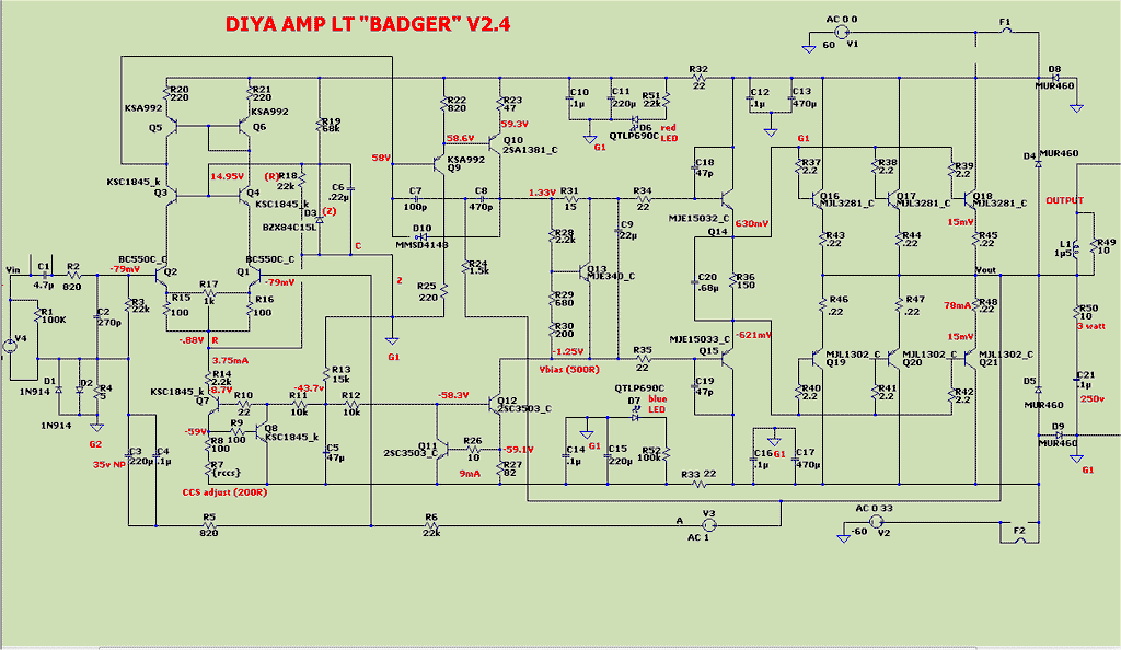

Q3 Fairchild KSC1845 bipolar transistor Q4 Fairchild KSC1845 bipolar transistor Q5 Fairchild BC556B bipolar transistor (cbe instead of bce so bend legs) Q6 Fairchild BC556B bipolar transistor (cbe instead of bce so bend legs) Q7 Fairchild KSC1845 bipolar transistor Q8 Fairchild KSC1845 bipolar transistor Q9 Fairchild KSA992 bipolar transistor Q10 Fairchild 2SA1381 bipolar transistor MJE350G Sub ? Q11 Fairchild 2SC3503 bipolar transistor I have 340G for all ? Q12 Fairchild 2SC3503 bipolar transistor I have 340G for all Q13 Fairchild 2Sc3953 sanyo bipolar transistor I have 340G for all
Also check the build guide it has alternatives. https://www.diyaudio.com/community/threads/diyab-amp-the-honey-badger-build-thread.211905/
i get it. I'll check it out. thank youAlso check the build guide it has alternatives. https://www.diyaudio.com/community/threads/diyab-amp-the-honey-badger-build-thread.211905/
Well, there's a build guide revision 1.0 to be found in #4,752. Is it the latest, the valid one?
Best regards!
I believe it's the only available revision, but I can say it's still really valid.
Gaetano.
The build guide is in the DIYaudio store
https://diyaudiostore.com/collections/printed-circuit-boards/products/honey-badger
Link number 2 from bottom under Additional Information.
