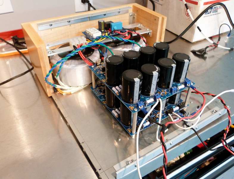

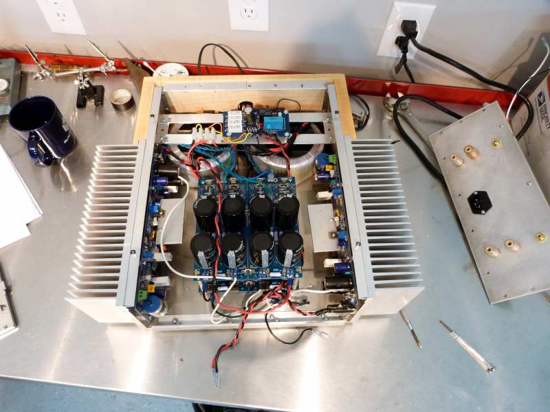

Success at last
Well my persistence finally paid off. Today I had the chance to work on my bad channel. Replaced D1,D2,R4, and Q15(not sure that I needed to but measured funny). Powered up and presto clean music through my test speakers. Now all I need to do is reassemble the amp chassis burn it in for a while and give it a serious listen on some good speakers.
PJN
PJN
PJN

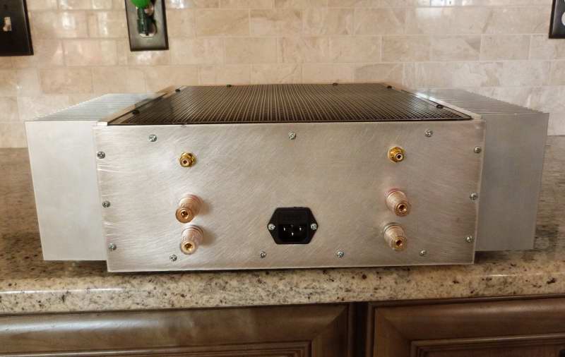

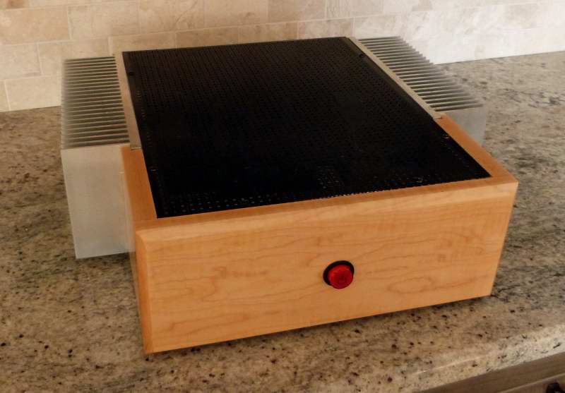

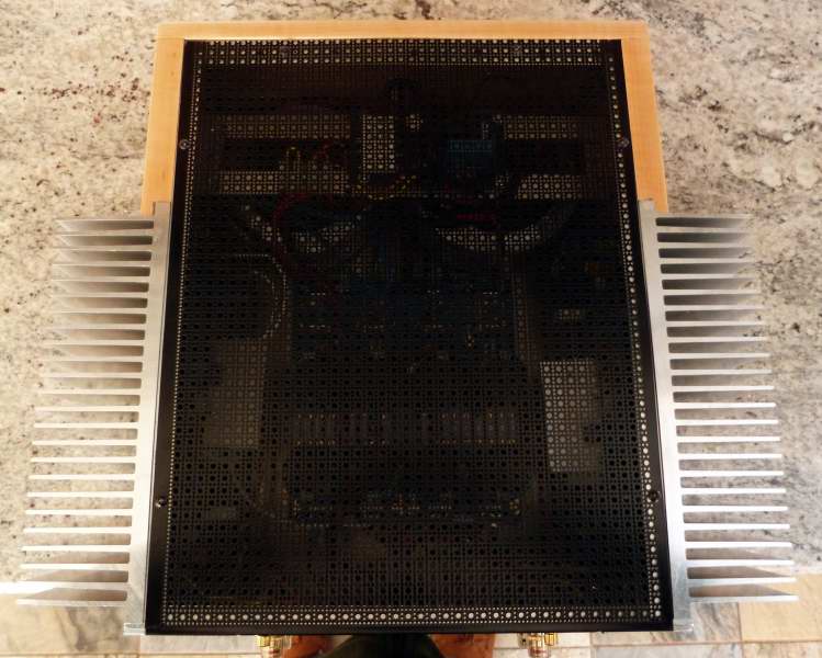

I finally finished everything up and had a quick listen on some decent speakers. Kudos to Ostripper, it is a very powerful, clean, neutral, and dynamic amp. The imaging is outstanding. When folks say that this amp has a grip on speakers they're not kidding. I'm going to let it burn in for some hours and maybe do a comparison to my SKA and F5 in my main system over the holiday break. I've included some build pics, my version uses 63 VDC rails in dual mono configuration, the only downside is that this monster weighs about 50 lbs.
PJN
PJN

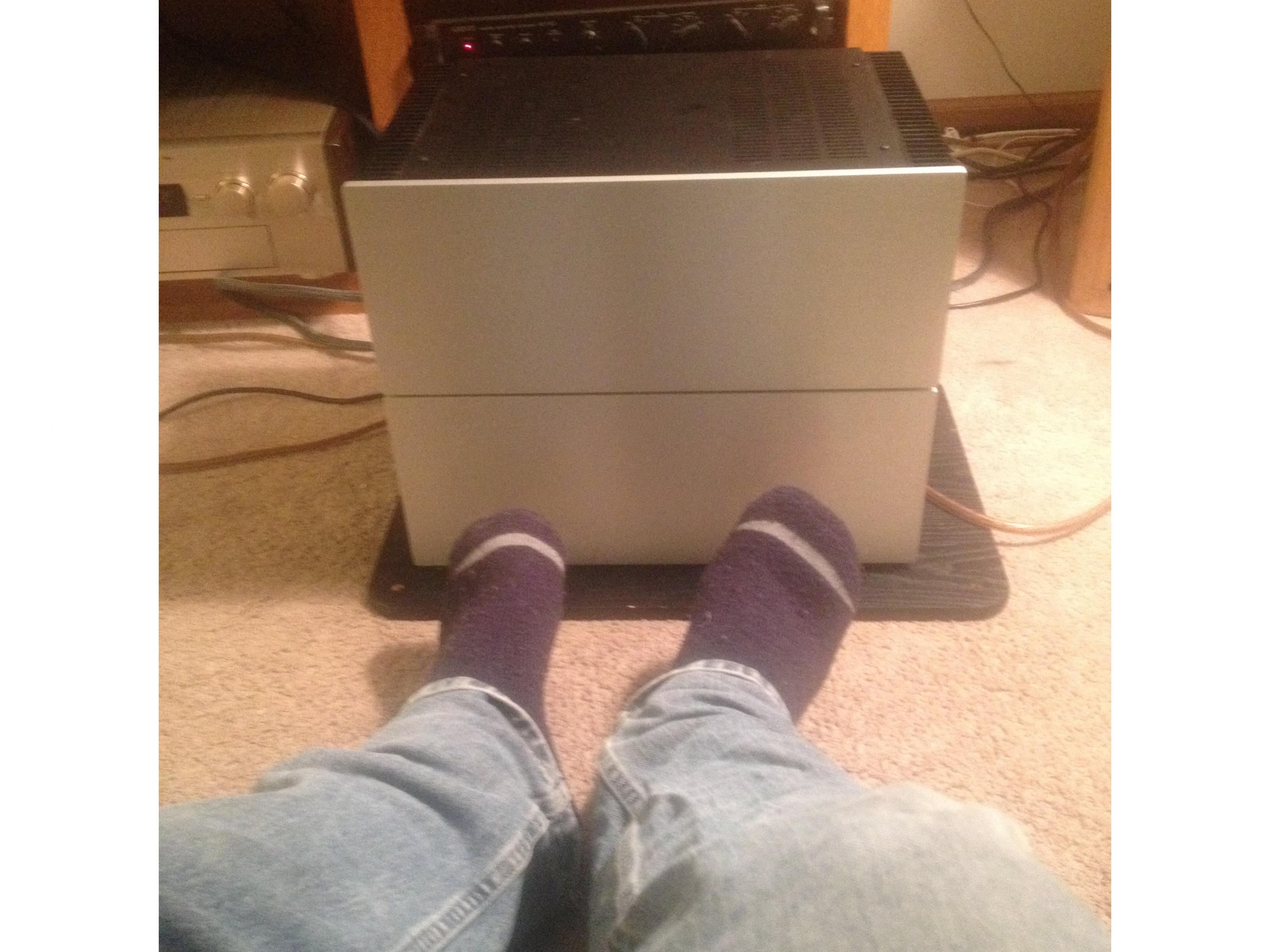

Nice combo...
True DIY , I like the wood/aluminum "merger".
The imaging you hear is the excellent PSRR of the blameless topology.
You would hear this even if you were not true dual mono.
Badger damping factor is above 150 , speaker cable is the weak link.

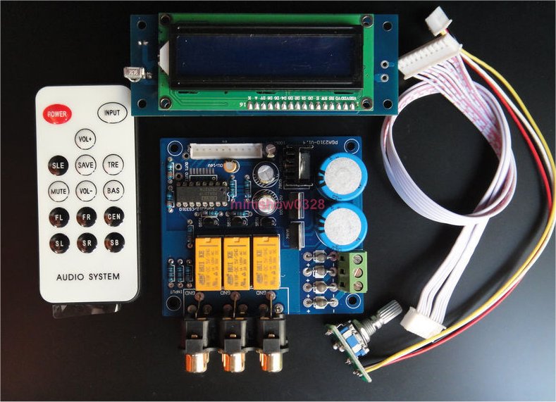

I'm going to add one of these to my badger (below1 - pga2311) , so I can sit on
my ar$e and do the memorex thing (below 2) (hair blowin' in my chair).

Hi Guys,
The transformers are Antek AS3445 (300VA). Each is good for 6.6 amps each for a total of 13.2 amps for this build. For comparison the AN8445 is good for 8.9 amps. The PSUs are the DIY store boards and are set up as CRC. Really nice boards by the way. I picked up a 1/8" aluminum plate for $40 on flea bay, and I had some maple laying around that I used for the front. The heat sinks are 5" high and 10" long from Heat Sink USA. The case dimensions are about 5" high, 17 inchs wide at the heat sinks (2 1/2" high), and about 14 inches deep. The sinks barely get warm after loud volume for an hour. That memorex add was the first thing that came to mind, this amp can really blow your hair back.
PJN
PJN
