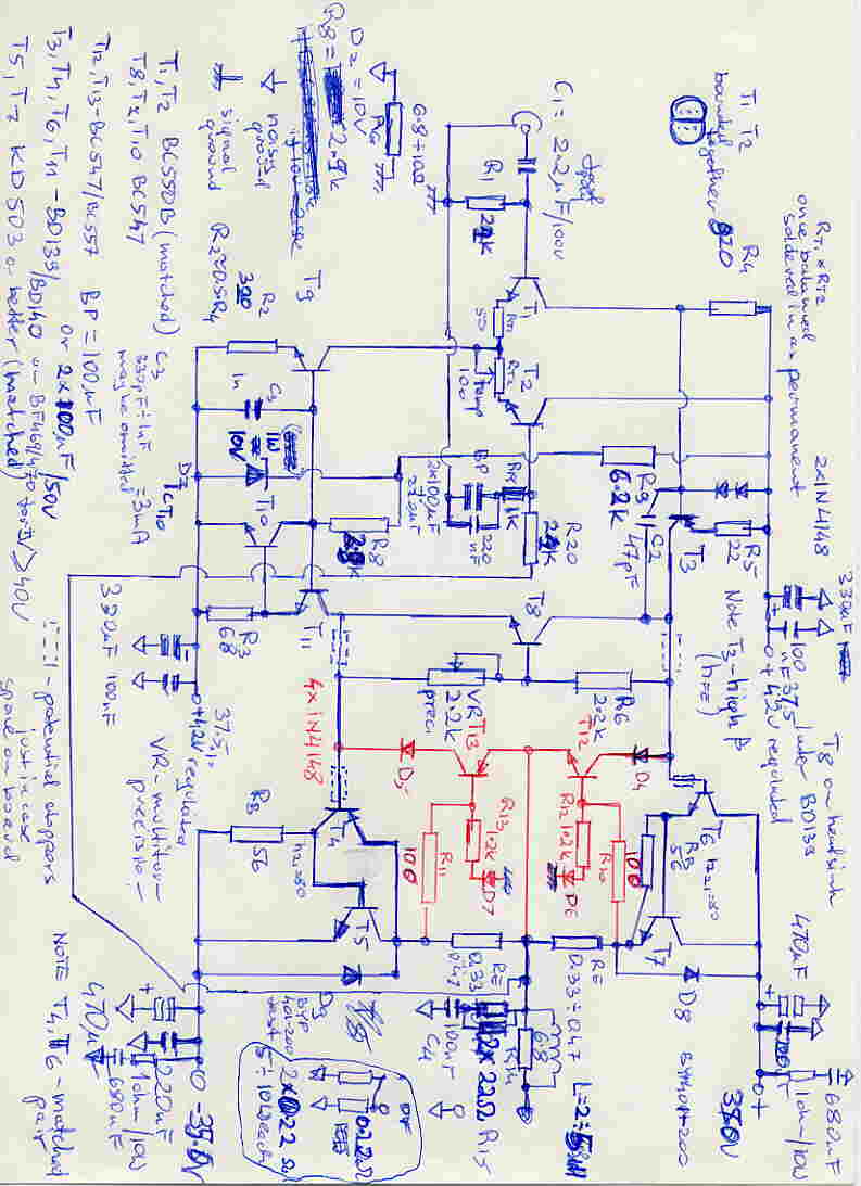

PS one of my first amp designs and example of calcs as a souvenir from old times and some rules (it would be nice to see calcs of this kind in PA design books):
Isource = (2…5) * IRbmaxT6;
IRbmaxT6 = Imax / (h12Tdriver*h12Toutput);
h21 of the output driver can be measured: assume the worst scenario of 20 for 3055 or a better K503;
h21 of the driver can be measured: h21=80:
Isource = (2…5) * 4.5A / (20 * 80) = (2…5) * 3.5A / 1600 = 5.5 … 14mA
Assume Isource = 10mA;

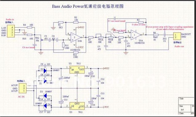

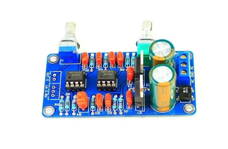

Has anyone given any thought to installing external gain controls
to allow the amp to be "matched" with others (bi-amping etc)?
NE5532 Low Pass Filter Subwoofer Process Circuit Frequency Volume for Amplifer | eBay
Not only gain , but this nice PCB could be low , high , or all pass with minor mods. (Sub - HPF for a 2.1 system). Unity gain or X2 gain on the second op-amp could also be done. Socketed IC's are nice , too.
(photo below). Just $8usd
The circuit is common on the internet (2'nd photo) comes with the dc supply.
A real deal.
OS
Just a caution with that circuit. The input mixer feeds the positive inputs that circuit would cause a fair amount of crosstalk. Although it makes the filter harder to incorporate, it should feed the negative input to avoid crosstalk. I'd use a buffer of some sort between the main signals and that board if I was using the mixer option.
I used Rod Elliot's Project 38 with the same input to switch on my amp and was surprised how much crosstalk there was, even when I increased the mixer resistors from 10K to 200K. I ended up just using a channel signal.
I'll be using a separate sub out from my sound card.I will use 2 in mono for my HPF's (all will be mono for 25$), thank's for pointing out this shortcoming .
OS
