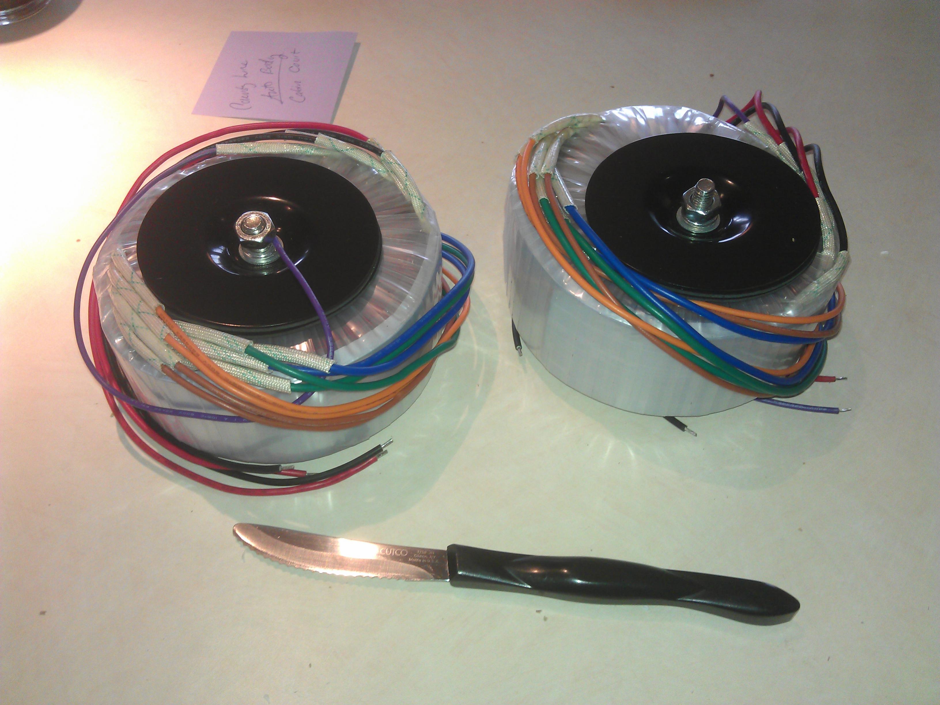

Heh... I was thinking I'd have a lot of real estate in the base of the chassis, but then I got my transfos today. Maybe not.
