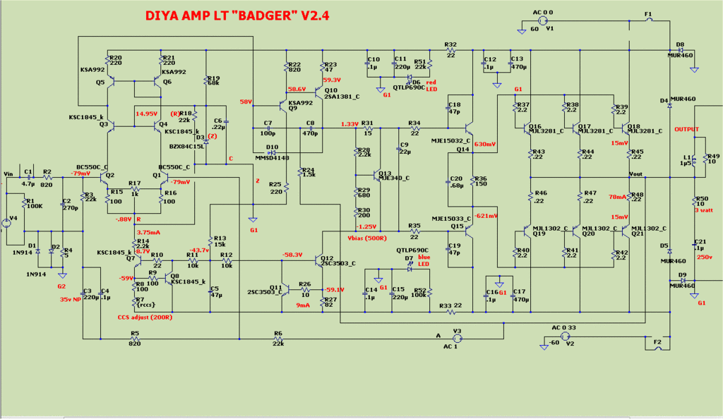

In the last schematic you posted, where G2 is marked at the junction of R4 and C2 is the correct location for audio ground.
D1, D2 and R4 are there to provide a little isolation between audio ground and the power supply ground. R4 would minimize the possibility of ground loops through your interconnects. D1 and D2 are to ensure the ground ring on the RCA connector can't have much more than .6V present for safety.
Thanks for Confirming. I guess the point of my first post was to ask the question if the V2.4 schematic is actually showing the incorrect location for G2.
Which it appears that it is. Can we please ask a forum admin to revise the V2.4 schematic to V2.5 with this change as its very misleading when you are trying to track down a problem

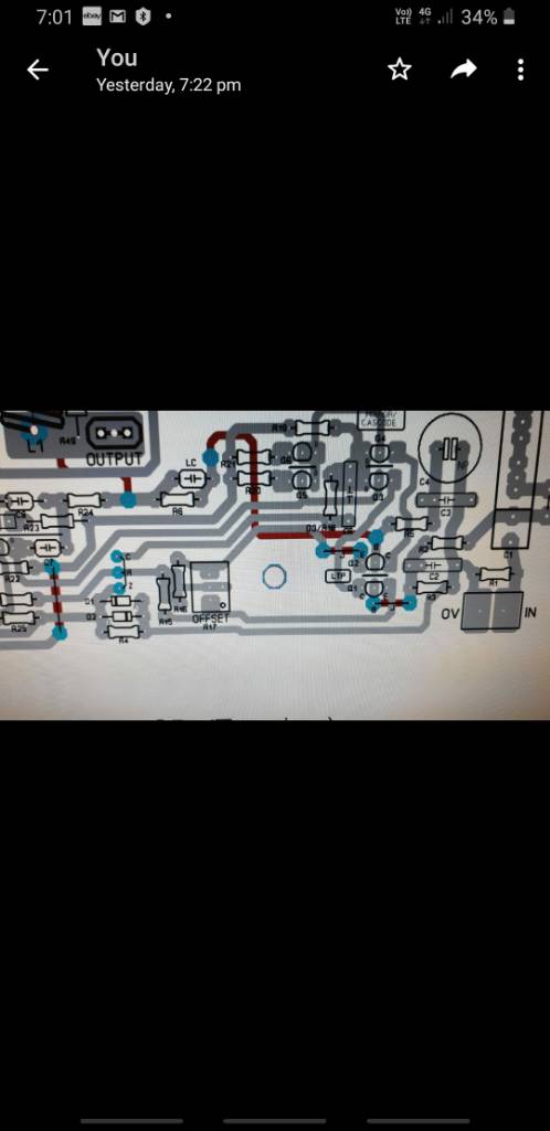

Are you saying that where G2 is marked on the original schematic is the signal (Audio) ground?
Because if you are it can't be. Just look at the traces on the PCB, Signal (Audio) ground is located between the junction of R4 and C2. Not on the other side of R4
I don't see the "G2" marking on the PCB, so there is no difference of G2 between the PCB and the schematic.

Everyone agrees that there is a ground for the input (say audio ground) and a ground for the remaining circuit (say power supply ground). These are seperated by R4 (4.7R resistor) for reasons stated before.
This is clearly indicated on the schematic and I have hand drawn it, a few post back.
The schematic however needs updating for the following reasons.
1. On the left hand side of the schematic the "power supply" ground is labelled G2 and on the right hand side it's labelled G1. No matter how you justify this, it is wrong and misleading. Show me another schematic that labels the same point with two different names.
2. The schematic does not show the optional configuration(s).
3. On the DIYAUDIO store site there are two different schematics, which can lead to confusion for new builders.

As an example I have had a look at the PCB and in my opinion the "audio" ground track is too long. Note I'm not saying that this is the cause of oscillation.
I know that no two builds are the same and that there are many variables however I'm open to your ideas and suggestions, especially from people that have built this amp. Tony etc?
No, not everyone. I don't agree. See my post 4002. In my view, there is just ONE GND involved in the audio signal. Note that I am explicitly not considering the chassis / safety earth as "GND". I refuse to call the safety earth as "GND" in order to avoid confusion between between the audio signal path (GND) and the chassis / safety earth.
The schematic however needs updating...
As it is drawn on the original schematic, G1 = G2. Therefore it might be clearer to just remove the "G1" and "G2" labels, and call them "GND" everywhere.
How can G1=G2 if there is a 4.7 ohm resistor between them and the forward voltage across D1 and D2 surely there is about 0.7V difference.
Also how can the Signal GND be labeled 0v on the silkscreen when clearly its not due the the forward voltage across D1.
mbrennwa I clearly state in my previous posts that there is an audio (input) ground and that there is a power supply ground that you call G1=G2.
They are "connected" through the 4,7R resistor.
So what's your point?
PS I am glad you agree that the labeling on the schematic needs changing.
It seems you are referring to your modified drawing. As I wrote, I was referring to the original.
However, please note that in most situations the voltage across the hum-breaking resistor (R4, 4.7 Ohm) will be essentially 0 V, not 0.7 V. The function of the resistor and the diodes was explained earlier.

OK guys, this is getting silly. So let's get back to basics.
1. There are two grounds.
- Ground 1 is the source's ground which comes to the amplifier through the RCA input wire ground termimal.
- Ground 2 is the amplifier ground.
2. Ground 1 should only be used by the input network and feedback networks, i.e. return point for R1, R3, C2 (input network) and C3, C4 (feedback network). Nothing else should be returned to this ground.
3. Ground 2 should be used for everything else, including:
- Loudspeaker return line
- Rail decoupling caps C12, C13, C16, C17
- Any other grounds.
4. Ground 1 and Ground 2 should be decoupled with a ground decoupling circuit consisting of a small resistor (5-10 ohms) and back to back to back diodes to avoid Ground Loops. In the HB these are R4 (5 ohms) and D1, D2.
After studying the schematics, the G1 and G2 labels are screwed up in both versions of the schematic:
v1: The diyAB "Honey Badger" Class AB Power Amp - 150W/Channel – diyAudio Store
v2: https://cdn.shopify.com/s/files/1/1006/5046/files/P-DIYAB-2V20-diyAB-amp-schematic.pdf
My recommendations:
1. Remove schematic v1, serves no purpose.
2. Fix the labelling of schematic v2 to follow the above guidelines.
@Stuart / Harry, does the PCB follow the guidelines above?

Thanks Stuart, just a quick clarification, when I said:
v1 and v2 do not refer to the PCB version. The latest is indeed 2.4. What I was trying to say is that at the home page of the Honey Badger at DIY Audio store there is a schematic picture of the Honey Badger (the one with the green background)... I am calling this one v1. Also, there is a link to the schematic, which brings up the pdf version with white background... I am calling this one v2.
While they are both supposed to v2.4 of the PCB, the schematics are not the same. They are close, but not the same, and in both of them the grounds are mislabeled.
What I am recommending is to fix the pdf version and get rid of the 'green background' one. To fix the schematic, I am suggesting to follow the guidelines are laid out above.
Stuart I like the layout in your pdf schematic, it's easy to follow.
My first post was a cut and paste train wreck. I'm hoping to get some feedback on the transistor types and gain grades currently available/in-stock at Mouser (US). Here is what I came up with for the LTP/VAS but I'm not sure about the Toshiba parts (Q10-Q13) and no outputs yet:

Thanks for that additional information Sandro. Maybe its best if we do update the schematic to call it V2.41 so people don't get it confused with the current PCB version 2.4 etc...
I am very busy right now so I don't have alot of time to work on this.
I'd be more that happy to mark up my pdf version if there is some way we could all reach agreement with the component labels that need tweaking based on what's currently available.
