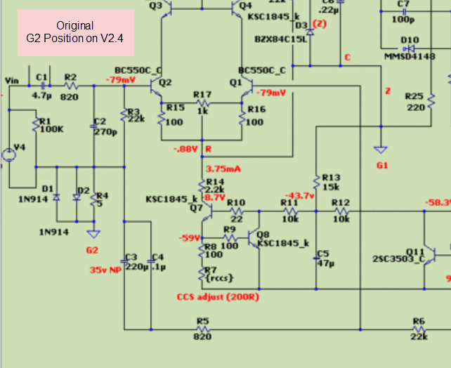

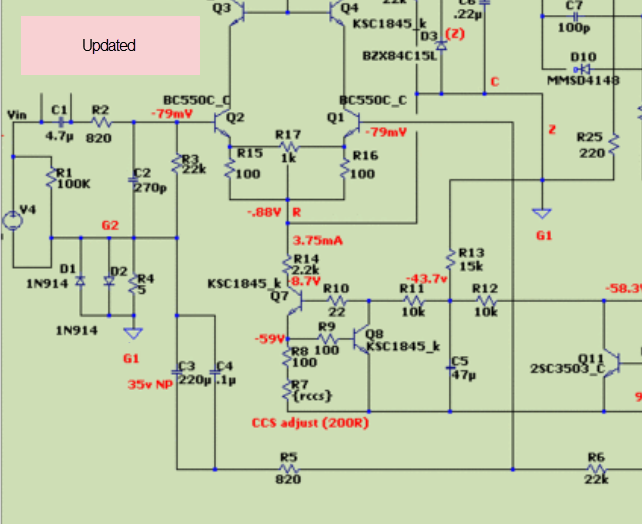

Hi Guy's
While chatting to Harry off line he noticed that there was a discrepancy between the location of the G2 (signal ground) and G1 (power ground) on the schematic
Can somebody confirm that my updated image is how the schematic should actually be labeled.
Thanks Harry, Great pickup

D1, D2 and R4 make up a ground lift/ loop breaker for the input. The ground symbol is the supply ground, the other side is the input/ signal ground or G2
The Ground Symbol shown in the original is showing the location of G2 which is what I am questioning.
It appears that its could be in the wrong location.

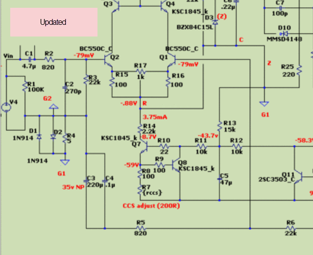

Where G2 is marked is the audio ground.
Please add some more details.

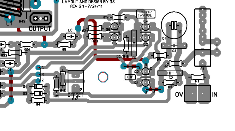

Are you saying that where G2 is marked on the original schematic is the signal (Audio) ground?
Because if you are it can't be. Just look at the traces on the PCB, Signal (Audio) ground is located between the junction of R4 and C2. Not on the other side of R4

In the last schematic you posted, where G2 is marked at the junction of R4 and C2 is the correct location for audio ground.
D1, D2 and R4 are there to provide a little isolation between audio ground and the power supply ground. R4 would minimize the possibility of ground loops through your interconnects. D1 and D2 are to ensure the ground ring on the RCA connector can't have much more than .6V present for safety.
