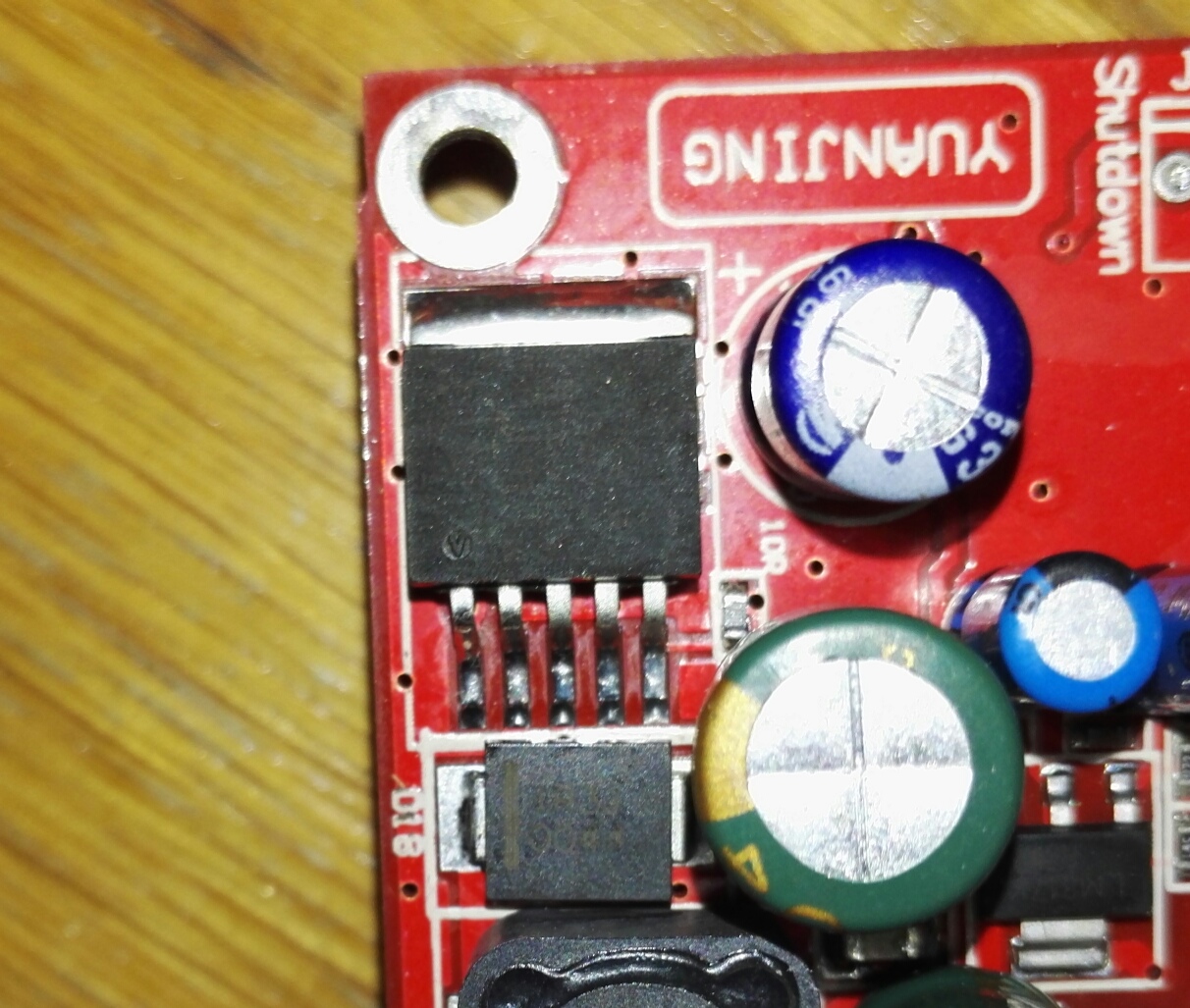

Well, I got my board today, it has a 15V regulator and there is almost no static noise.
But the Voltage Regulator has no label on it, therefore I'm a bit afraid to run the amp at 50V.
Theres only a little "V" marking on it, so is this just a cheap china lm2575-15 copy? :confused:

Almost definitely the cheaper lower input voltage device.
It's easy to swap. Sometimes better to cut the pins rather than trying solder sucker or braid. The PCB lands aren't very substantial so destroying the device to get it off is preferred to ripping or melting the tracks off.
The LM is a bit more robust regarding overvoltage/overshoot (63V vs. 60V) from the datasheet specifications. The TL type is the same a the LM spec-wise but presumably manufactured in a more modern/optimized process which make it cheaper.
LMXX 1999
TLXX 2006
If you can effort the $0.9+, go for the LM, otherwise the TL.
(If they do the same manufacturing process for both devices, the LM type would be the better "bin" then - tested at the preaging/burnin process on wafer-level selection)
Actual versions from manufacturer has this problem?
Some info. I dont know about old releases and fixes of this bug in past time, but actual PBTL 600W blue ver. of tas5630 amp from yuangjing manufacturer, has a "true" LM2575s-15 onboard.
Today order a 300+300 red version, will see on it, in other, no big problem to change this chip.
