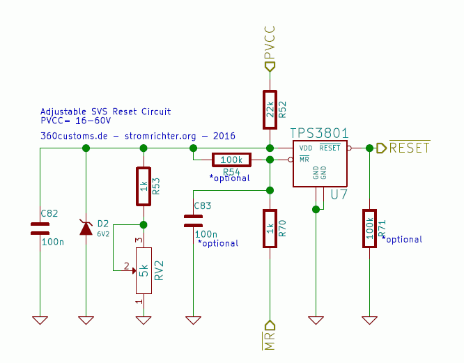

A second board has been added to my system to drive a 12" subwoofer in a 60L ported box. The switch off noise is a problem with this arrangement. I had the sub in 28L sealed box before and the cone movement was noticeable but not dangerous.
This second board has a small sub board with the low pass filter on it, but the main board is virtually the same and I guess it's the 12V supply rail dropping that is the problem.
Does anybody have a simple mute circuit that kicks in early on main voltage loss I an copy? I could design something, but if there is a tried and tested arrangement, that would be best.
Maybe this is something for you:

Top job, thank you :)
I found a 3 pin TO-92 equivalent to the 3809 (no reset input and O/C output) which should allow me stick it down on the PCB with a couple of resistors,cap and the zener where the missing "Shutdown" connector is. I'll probably solder the bits to a small piece of stripboard first.

A 3 pin chip with hysteresis, guaranteed time delay and a 1.1V minimum operating voltage is a whole lot easier!
MCP121 450E/TO

Low voltage cutoff works well. Thankyou DrMord. :p
20K and 2K2 voltage divider with MCP 121 which has a "4.5V" actually 4.38V typical switch point. This is about 43V for a 48V PSU. 6.2V protection diode and 100nF cap fitted.
All the rushing and crackling noises on power down have gone :D
This is on the Yuanjing 2channel board (copy of TI development) I have on the mid/treble channels. The subwoofer PCB is almost identical, but where R39 & R11 go-to means taking the heatsink off again. R11 may not exist on this version, but the pullup will be there. More surgery :eek:

The subwoofer amp does not follow the development board like the mid range (red PCB) and some tracks are deleted. The 100R series, 47K pullup and cap are all there under the heatsink though. The orange wires go to the RESET circuits, red to +48V and brown to 0V.
Works very well and there are no clicks, pops, rushing or other annoying noises!
