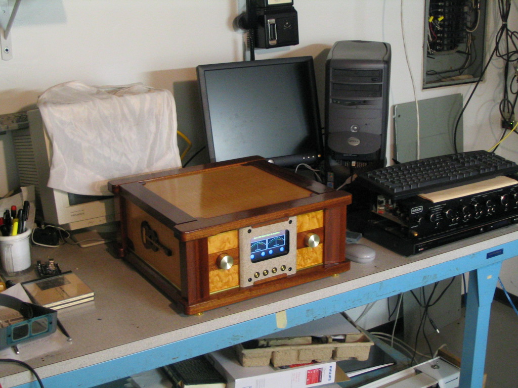

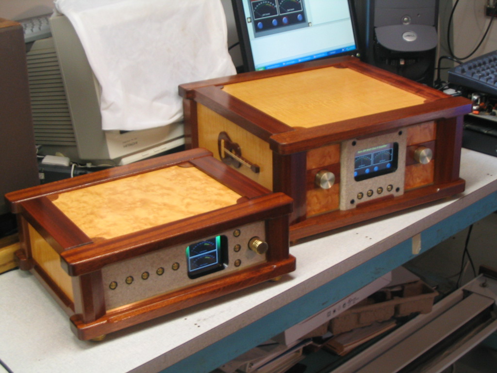

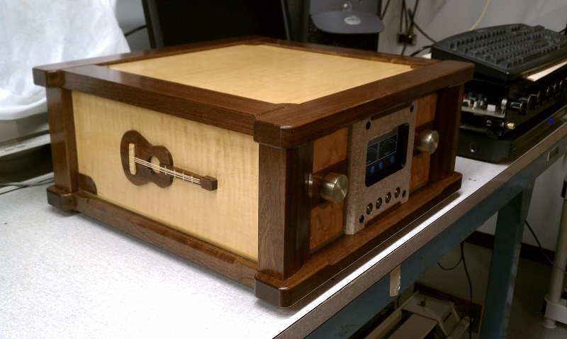

This is a great thread,I also prefer Arduino for Audio projects,I used UNO in my recent projects, A Pre-Amp/Power Amp combo,both units have touch screens and capacitive touch. The reason for both is I use these two units as a
development platform for future stuff.A PGA2320 is in the Pre and the Amp has a Sure 250W\CH Class D.
Joined 2004
Hi Gerald:
here is the link to the 4.3" display it is available with touch or without
4D Systems | Turning Technology into Art
Link to 3.2" (used in pre-amp)
They have a new 7" display which is just a little more than the 4.3...I have a few on order
I suggest you download their free development IDE,It will give you a good look at all the nice graphical elements at your disposal.They support Arduino/RasPi platform and they have a ton of good App notes to help getting started.You can also use their own programming language to develop your App,the program runs on the LCD standalone.
Link to Workshop IDE:
Be Happy to answer any questions you may have...
Regards
Bob
Regards
Bob

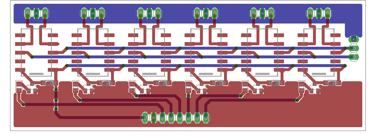

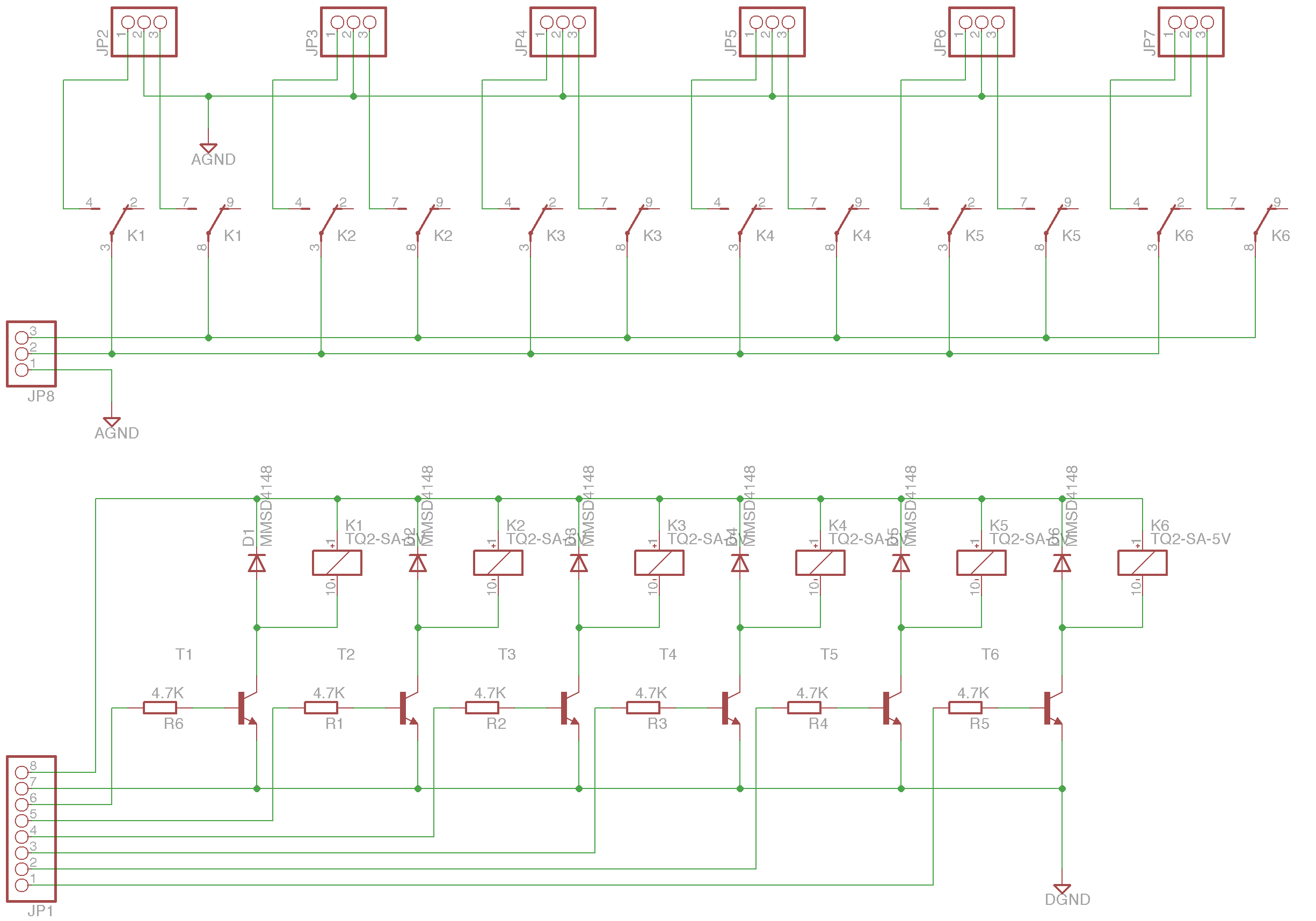

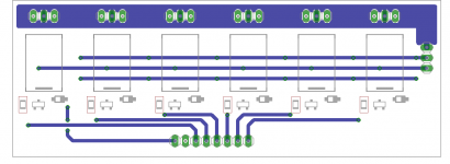

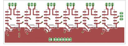

Ive been a bit away from this thread due to my university work but i have been trying to build a input selector relay board which id like to get some eyes on. Everything is in SMD except the pin headers.
Components:
Relay: TQ2-SA-5V
Transistor: MMBT2222ALT1-NPN-SOT23-BEC
Diode: MMSD4148
Resistor: 4.7K
Schematic and board is attached, let me know what you think.

I had the transistors laying around, but honestly i cant really bother using them when there is a IC solution as you mentioned. I will remake it.
I can't find the parameters of that chip off hand.
TI's MPC50x series is probably a more modern equivalent if not better specs.
They just released some switches with a THD of .004% +/-6V swing.
http://www.ti.com/lit/ds/symlink/ts12a12511.pdf
I just got some 16X16 crosspoint switches that I mentioned earlier from Analog Devices.
But I have to figure out how to control them via serial interface.
http://www.analog.com/static/imported-files/data_sheets/AD75019.pdf
Here are the links to the newer stuff,
Analog Switch or Multiplexer (greater than 5V) | Products for Analog Switch or Multiplexer (greater than 5V) | TI.com
Analog Switches | Switches/Multiplexers | Analog Devices
Analog Crosspoint Switches | Switches/Multiplexers | Analog Devices
Multiplexers (Muxes) | Switches/Multiplexers | Analog Devices
Linear Technology - Parametric Search for Switches and Multiplexers
FWIW
jer
