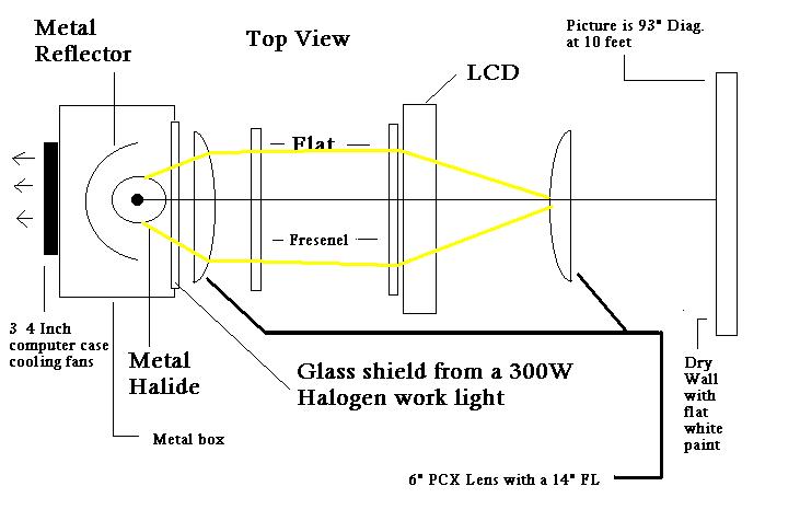

Hi: I've been in the forum for a little while and have read extensively on your setup. It's very much like the one I am building, although I'm going with the (too many dollars ~L~) laptop screen and controller card.
My card is on the way from Taiwan, and the panel is coming from the US...waiting for parts is the story of my life. I'd like you to take a look at a PCX I found and get your opinion on the lens. It's a 7-1/2” DIAM BY 20” FL PCX LENS - New This Week!
Item No.: L2152 from surplus shed. I'd also appreciate your advice on what lens to buy for next to my 400 MH lamp.
I was one of the missinformed folks that thought an old CRT lens would be helpfull to this project (untill I spent most of last night reading back posts that is). Fortuneately I didnt pay anything for the JBL PJ it was a DOA on it's way to the dump when I grabbed it (hehe also got a working Novabeam 1A from the guy).
Any assistance in my new nightmare....... "optics" would be great.

If I recall you are running a 14 inch screen? and are getting great result with your 6 inch/14fl PCX. Do you know if the 7.5 inch/20fl is going to make my PJ a "longer or shorter" overall box (dimensionally speaking) I can handle the 10 feet to the screen distance now.. but in the near future intend to move it into a spot where I can get about 18 or 20 feet from the screen. Screen to be determined, currently I'm watching the Novabeam CRT on a bed sheet LOL. But in the new location I am thinking of really testing myself and building a Torus screen... If my new hobby doesnt kill me the wife will for sure!
zardoz
zardoz
Zardoz
My LCD is 10" Diag.
Yes this lens will make your PJ box longer.
As far as the picture size, I would not know.
For me it was a try it till I get it right (one year later).
I will tell you one thing, a 4 1/2" PCX lens with FL of 20" at ten feet produced an image of about 1/2 the size.
Therefore this is maybe what you may be looking for in the future to get that 18 or 20 feet.
If I where you I would get the 7 1/2 for the bulb side for sure, another for the objective and a 4 1/2 as an extra to see which one would work for you.
The diagram that I have shown is a basic configuration.

My LCD is 10" Diag.
When you get to that point make a post on this site and I will
tell you a couple of other things that will fine tune your image.
L8r
