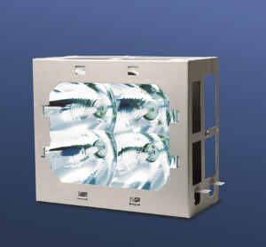

eebasist said:.....you might get a decent effect out of them if you encase them in an old elipsoidal stage light....
That's close to what I'm looking into. After seeing this product:
http://www.premier-lighting.com/tipa/tipa.html
I ordered a reflector and lens from an 8" fresnel stage light from Secoa and intend to experiment away. Not having specific data on the reflector, my fear is that the light source of my big honking 400w MH bulb won't be able to fit anywhere near the focal point. From what I've seen so far, stage lighting fixtures use very small high power bulbs which can fit deeply into a reflector. We'll see once I get it.
I tried to pick up a reflector like marklar's. Cooper makes the Portolio line and sells though Home Depot, so I called them with the model - H7684T. The quote was $181.56 plus $25.58 for the trim ring plus shipping. Youch! Well beyond what I wanted to spend on a reflector!
So, tech head and undream may have the practical answer. What sort of adhesive do we use to allow fairly precise tweaking and aiming of little mirrors inside a form which won't care about heat? Someone a while back had suggested using one of those laser pointers for checking focal points, and that might really help in aligning them in this case.
I ran into the same problem with Marklar's projector. It was just too expensive.......so i decided the ellipsoidal stage light would be better.....the thing is, with a quartz halogen bulb it could be very good, they are desined to use a relativly large bulb fillament. But i probably wont go that route yet since i've got two working projectors and that only need light sources....time to modify stuff

Xenon Light
May be of interest! Here's a pic from 10" single panel projector light unit. Projectors name is 'GP Movin 2001". It's a 4-pack xenon unit with 4x35 Watts. It should last up to 6000h and costs about 76 EUR. Xenon lamps dont produce so much heat and can work with smaller, more silent fans. If somebody is interested:

Re: Xenon Light
Cool! I'd never even considered an ARRAY of smaller lights and reflectors! This would help keep the light rays going straight through the LCD apertures. They sort of look like light headlight reflectors, don't they? I'd guess they must use a large high quality fresnel after the panel to make this work. Anyone understand enough German (or whatever it is) to know if its mentioned on the site?
xblocker said:May be of interest! Here's a pic from 10" single panel projector light unit. Projectors name is 'GP Movin 2001".
