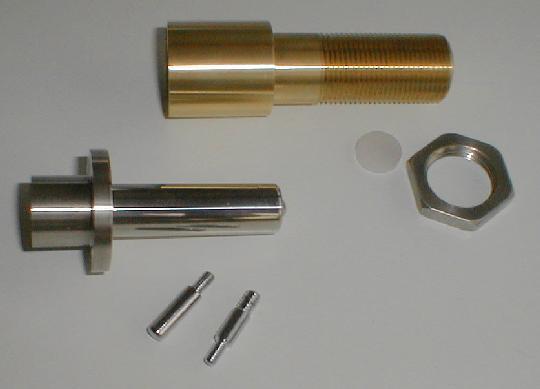

I think it is a great idea to have a group bearing design that has freely available documentation so everyone doesn't have to start from scratch. I've looked at the old Teres threads but there isn't enough info (or drawing) to duplicate that design. Is a a Teres drawing available anywhere? I have reasonable machining skills and I think getting a final dimension within a half thousands is not horribly difficult. Does the shaft really need to be hardened? If the ball bearing is taking all of the axial load and the sleeve is only taking the lateral load I would think that it wouldn't need to be hardened.
I lifted this picture from the Wayback Machine, but I also have the original drawings tucked away on one of my backup disks. I also had some communication with another of the Teres designers, and some new ideas. I don't want to publish the original drawings without permission Based on this, there are two dim's for the spindle diameter, .75 and .8''. The length of the spindle section is appx 2.5''. The bearing sleeve brass, appx 4.5'' total length, with a wider section turned in the middle of the inner sleeve, effectively making it a two part sleeve or bushing. The top hat of the spindleis recessed into the platter appx flush with the platter top, and a disc spindle is threaded into the top, one smooth or one threaded for a screw on disc clamp. O chose .8'' for my still not quite finished version.....
Wayback link here : Teres Turntable
