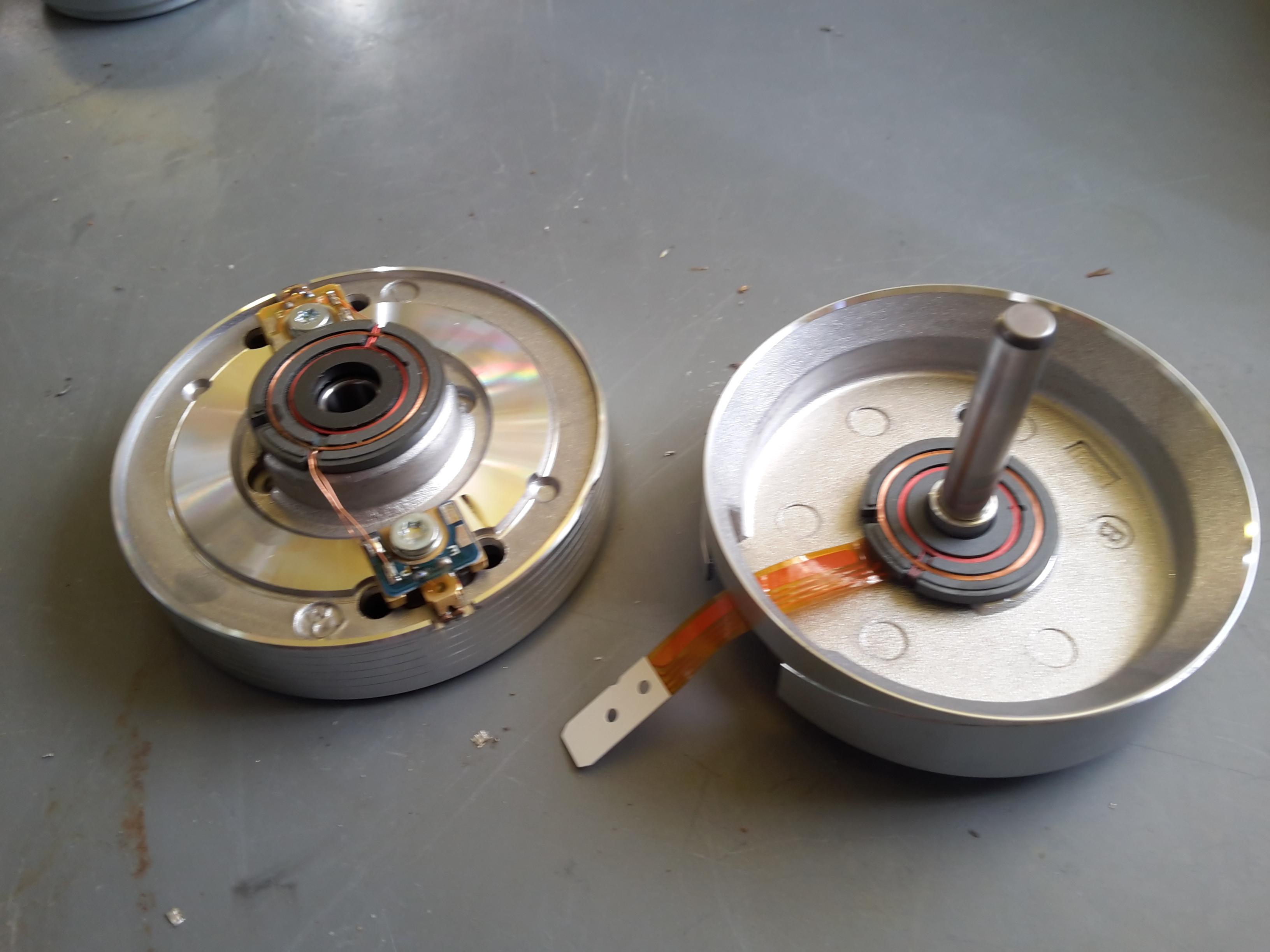

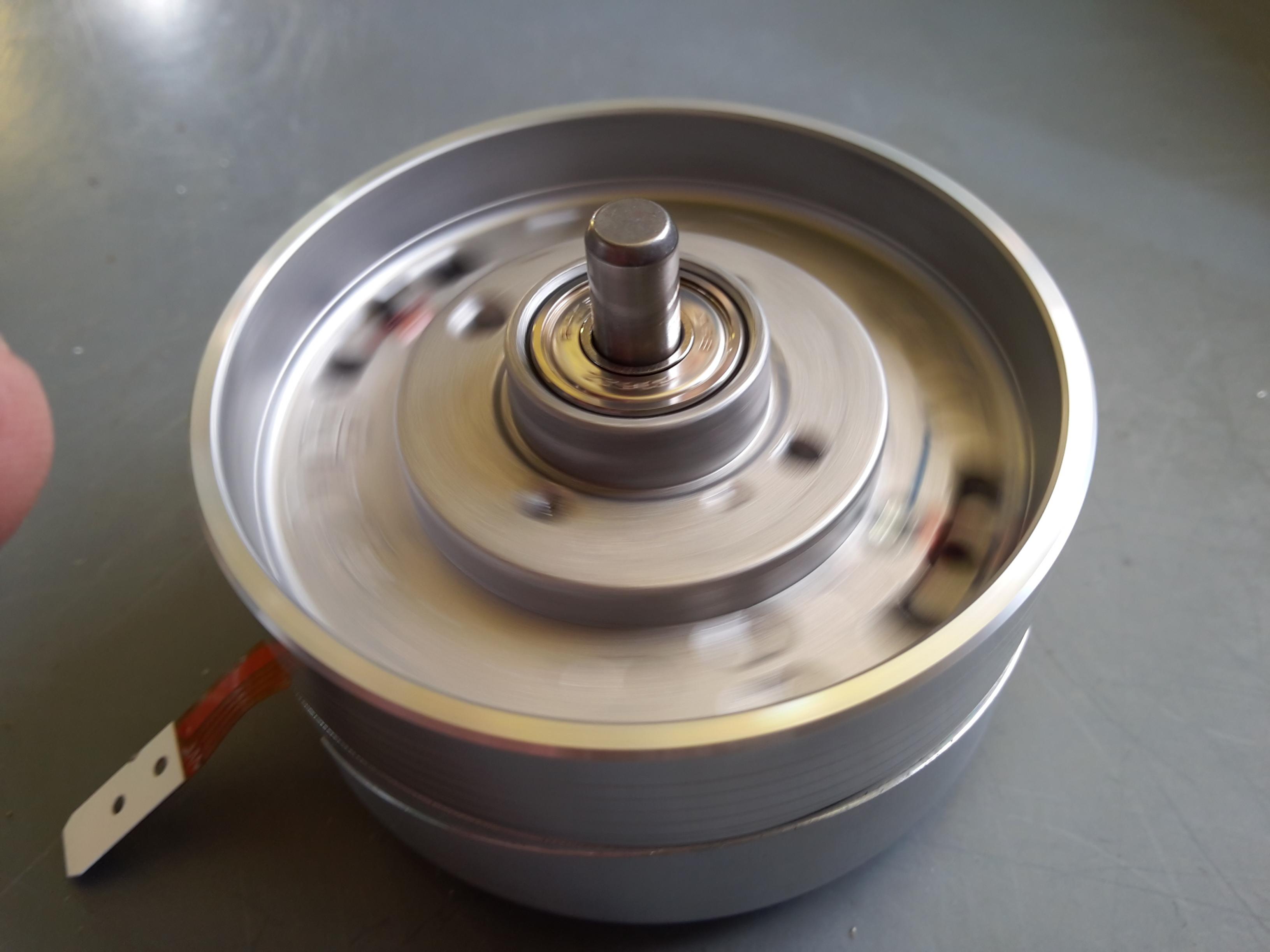

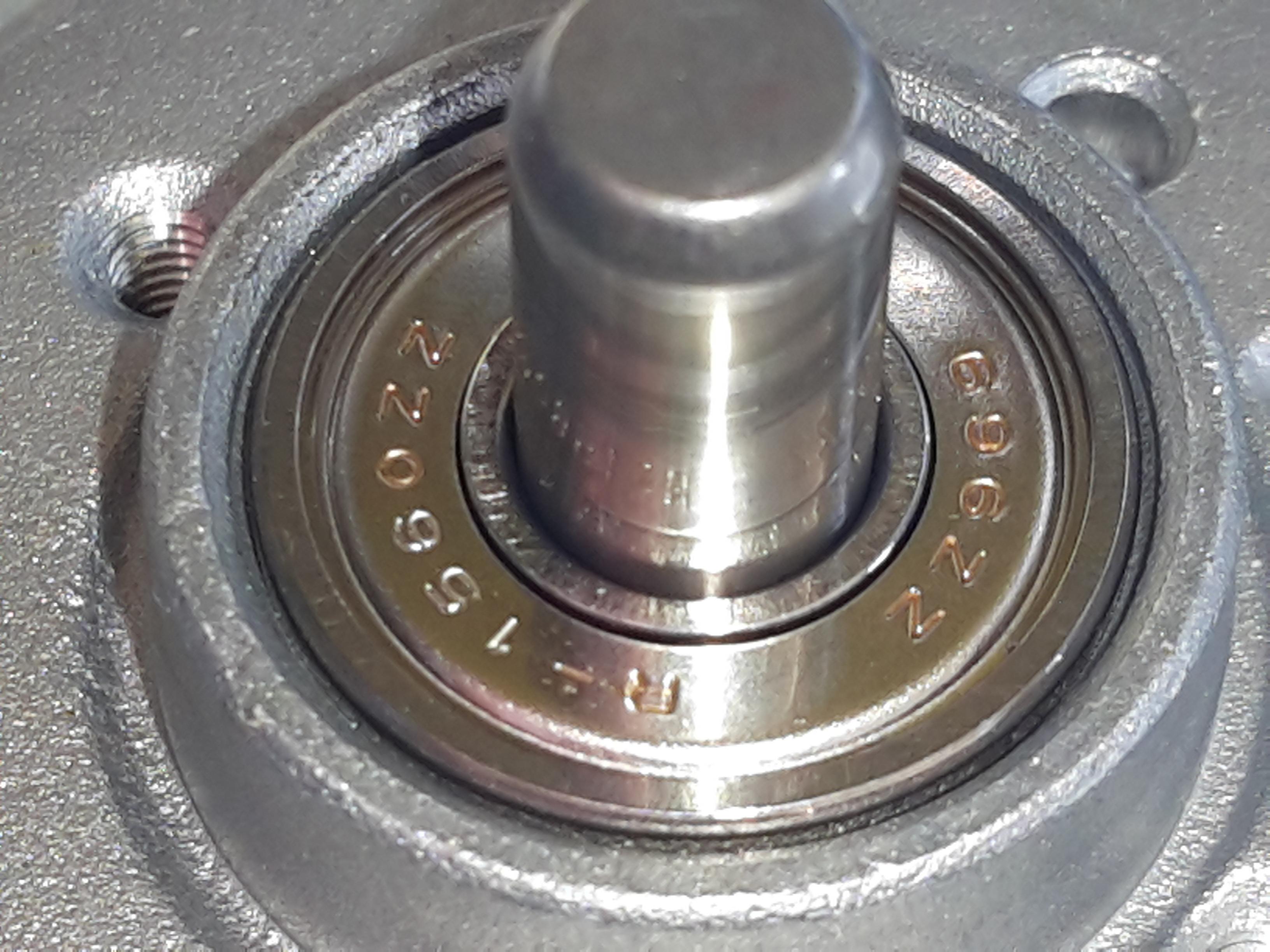

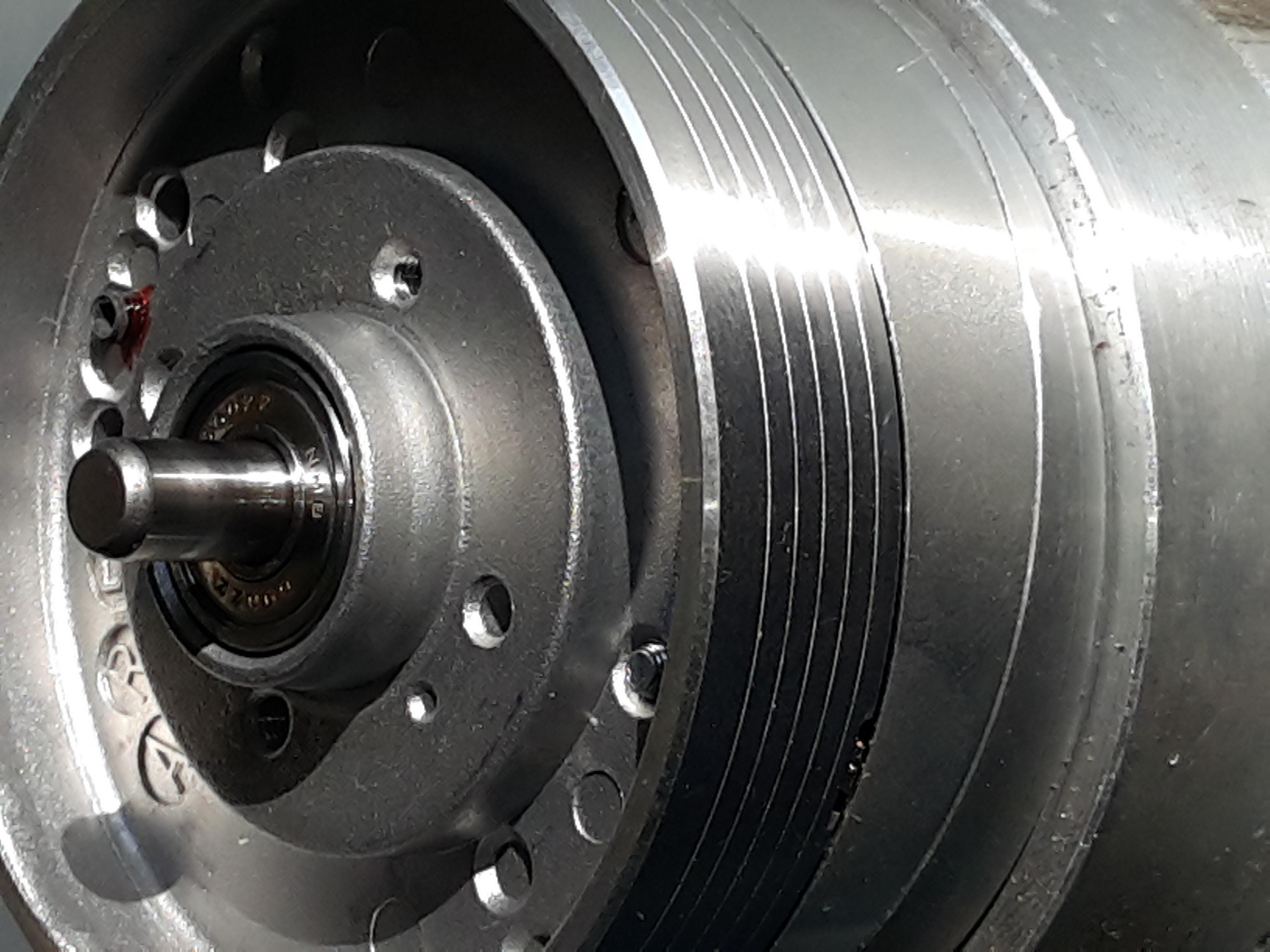

So now for me is time to study the best solution before attempting to machining a new spindle, so I will not give new updates to this thread before a while.
Anyway, today afternoon I pick up my daewoo vcr from my garage, and I removed its head.
At the end of the post I attached some picture of the head
Ok, almost all low cost and high end turntables seems to avoiding ball bearing, and for sure there is a valid reason to obtaining for other choices, by the way, I decide to test anyway this ball bearing system.
Well, if the upper flange (I dont know if flange is the proper name, anyway the rotor), is rotating with any load on it, ball bearings produce a very little sound, or hum as you want to call it.
But what happen if I put on the flange my 3 kg turntable plate?
With the load of the plate on the flange the ball bearings make almost no audible sound!
I put a stethoscope on the base of the spindle, and still very low noise is audible.
A real test would be hearing a test disk on this system, with a felt mat between the plate and the disk, I think it will be interesting.
Of course the most important thing is to decoupling the base which support the spindle stator from the arm, but this is another issue.
What about rotational error or free play?
No free play at all, and the 31cm plexy disk, (not fixed on the rotor, but only put it on it), on the edge of the plate, I've measured only +/-2 cents (millimeter cents) of error with my dial gauge.
I think is a good result, I've seen a lot of really good turntables wobbling a little bit, and this wobbling was not measured, but visible!
Last test regards the friction of the spindle, I run the 3kg plate put it on the upper flange.
From more or less 30 rpm the plate need 4 minutes and 3 second to complete stop.
What to said if not this vcr head is an interesting object?
Thanks all!!!
