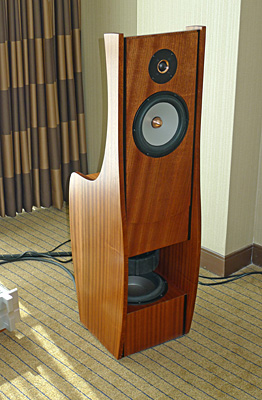

I really like Dennis Murphies new designs in the Philharmonics I, II and III. There are several driver choices such as Fountek and Raal for the tweets, B&G Neo 8 for the mid range and ScanSpeak or SB Acoustics for the Woofers! This is a completed speaker but for those drivers, the low cost and the designer, I have to say it sounds like a very high end system. Who knows, maybe Dennis would sell you something in kit form?
I also forgot to mention, the design of the Philharmonic speakers is very interesting. It has and open baffle, or open back tweeter and mid range that's isolated in a different compartment from the woofer, which is a transmission line design. If it's anywhere close to the sound of the DreamScapes, which also uses and Accuton ceramic mid, it will certainly be high end enough!
What I could not fathom was why Dennis used a $80 midrange in the Neo8 with a $300 tweeter in the RAAL 10D (see links below) when most of what we are sensitive to is in the midrange region.

Navin,
Dennis Murphy is a pretty good designer, so I'm guessing it:
1. Sounded as good, or better, than anything else he considered
2. Was easier to blend seamlessly with the RAAL
3. Was the only driver within a set price range, that actually delivered the required performance.
The cost of a driver has very little to do with it's sound, or performance. Most of the magic is in the crossover anyway, and that's what Dennis Murphy is very good at.

Zaph has some interesting things to say about ribbons and B&Gs.
Personally I like my ribbon despite Zaphs findings but then I only use it above 12k.
Also from what I have seen (and heard about) most of those super expensive, exotic (ceramic and what have you) drivers require a lot of massaging to get them to behave as well as conventional ones. Not worth the cash or the grief IMO.
Oh I am sure that Dennis considered performance and the way the drivers matched before anything else. My observation was not meant ot cast any aspirations on Dennis's design abilities or ability to choose drivers. I am sorry if it came out that like that.
Both the RAAL drivers and B&G drivers are highly respected by many designers.
