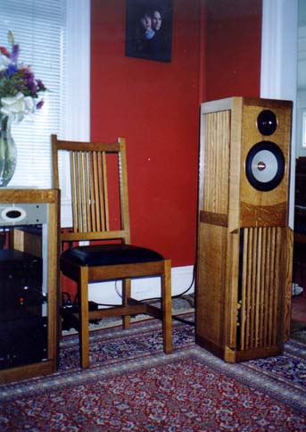

I'm personally partial to Earl Geddes kits though...
Loudspeakers
An Abbey kit with 3 or 4 discrete subs could run you up to $10k and give you a world-class system.
Also, consider this:
"But the best part of buying a Geddes sub is the setup analysis that is provided. With every sub comes a run of a complex room/sub fitting algorithm. Bass is completely room dependent and just buying a sub (or several) will not ensure a satisfactory response in any given room. Now you can have the subs custom fit to your room!"
I doubt any other manufacturer does that, but I could be wrong.

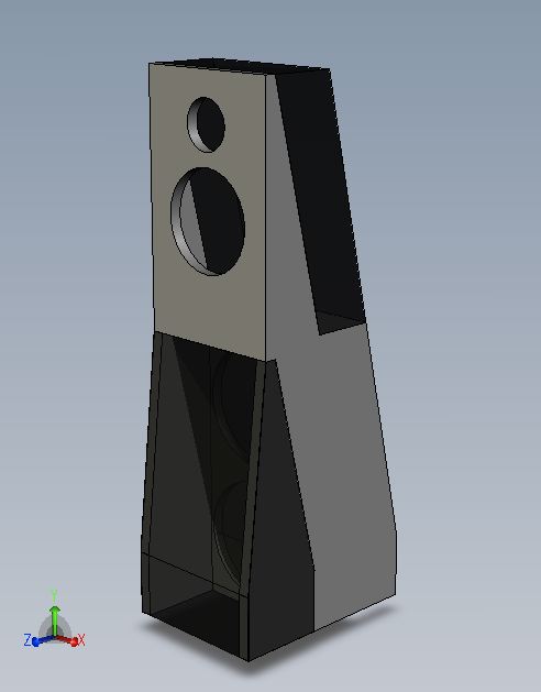

Im in for speakers split in 2, like sub-box under the box with the tweeter and mid like this for example:
Then I could just design it like a Coltrane 2 and just split it i middle, see?
4: In most of the time I most likely will listen for myself, but I need a speaker that could fill my upcoming listening-room
(8 meters X 6 meters x 3.5 meters tall)! BUT friends and family will often come and listen to.
5: What do that meen; "Focus on power response"?
6: This is my dream design!!! :
See the split in the middle I made, to seperate the bass-box and the tweeter/mid-box.
Better sound with the split/seperation?
7: Accuton drivers! Heard that the mid is among the very best, so the 11" I think will do allright?,
pluss they are the same design. The tweeter I can cope with another type (maybe Scan-Speak or something like that)? What do you think?
