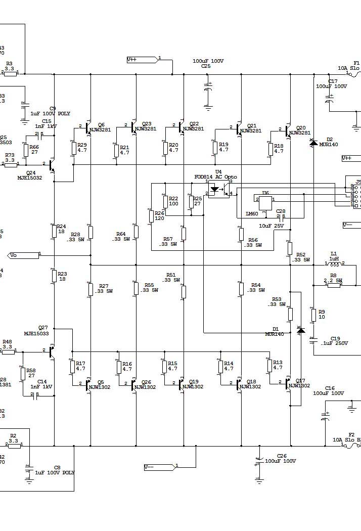

I am not building a Leach amp, just copy the current limiting circuit. I plan to use TTC5200 and TTA1943 that has 140p and 240p input capacitance resp. It's only 150W transistor but I don't think it's a problem with 9 pairs.

Read Michael Kiwanuka's article on VI limiters. You'll find it on Bonsai's site.

I went to hifisonic site, I can't find that. I looked at his schematic, he use an opto. You draw enough current across the two resistors to turn on the LED to do current limiting. I don't want any complicate stuff like his protection circuits.

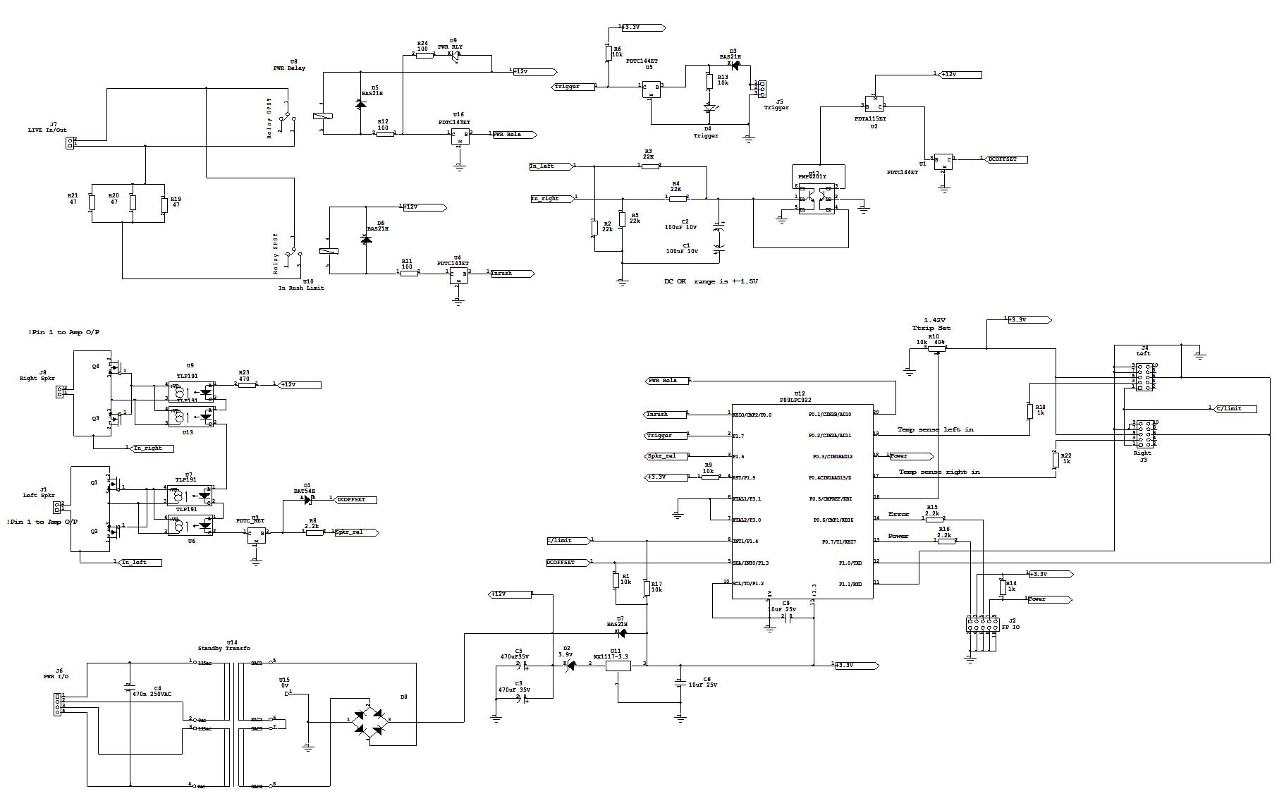

I allways do 2 steps of protection. The first is limiting the output current as a common V/I limiter, and I apply 2nd step, to trigger the relay driver circuit, if the overload exist longer time. This gives instant protection, and time to cool down the output devices.
Sajti
I thought about this, but I decided against it because it will kick in and out. When you detect over current, relay open, current drop, relay closes, over current, relay opens........... That's the reason I use 2 step to first avoid inrush of huge current using circuit from Leach to limit the max current to like 3 to 4A. Then let the rail fuse do the job and open it.
I do have SS relay to cut the speaker, but mainly for protecting the speaker if DC exist at the output of the amp.
Of course no! I use optocoupler to discharge the capacitor in the turn on delay circuit. This is very comfortable solution, and can be implemented into any existing amplifier, which contains the commonly applied V/I limiter.
It discharge the capacitor in about 0.5sec in case of short circuit. Relay turns off, and the delay process started again. I choose it to 5-6 sec, to give enought time to cooling down the output devices.

Here is a link to Michael Kiwanuka's Paper on SOA limiters - hosted by Bonsai. I admit, it wasn't easy to find it.
Michael Kiwanuka: SOA Protection for Audio Power Amplifiers
