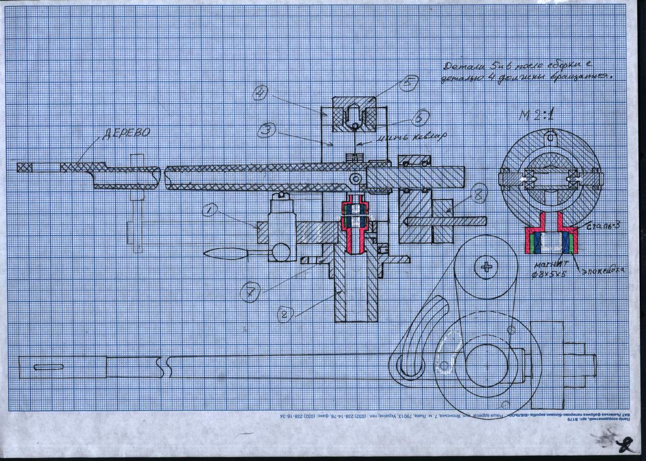

So Herr Schroeder patent application drawings are wrong then?

The patent drawing shown does not represent the current standard, but will allow for such an arm to be built successfully if executed properly.

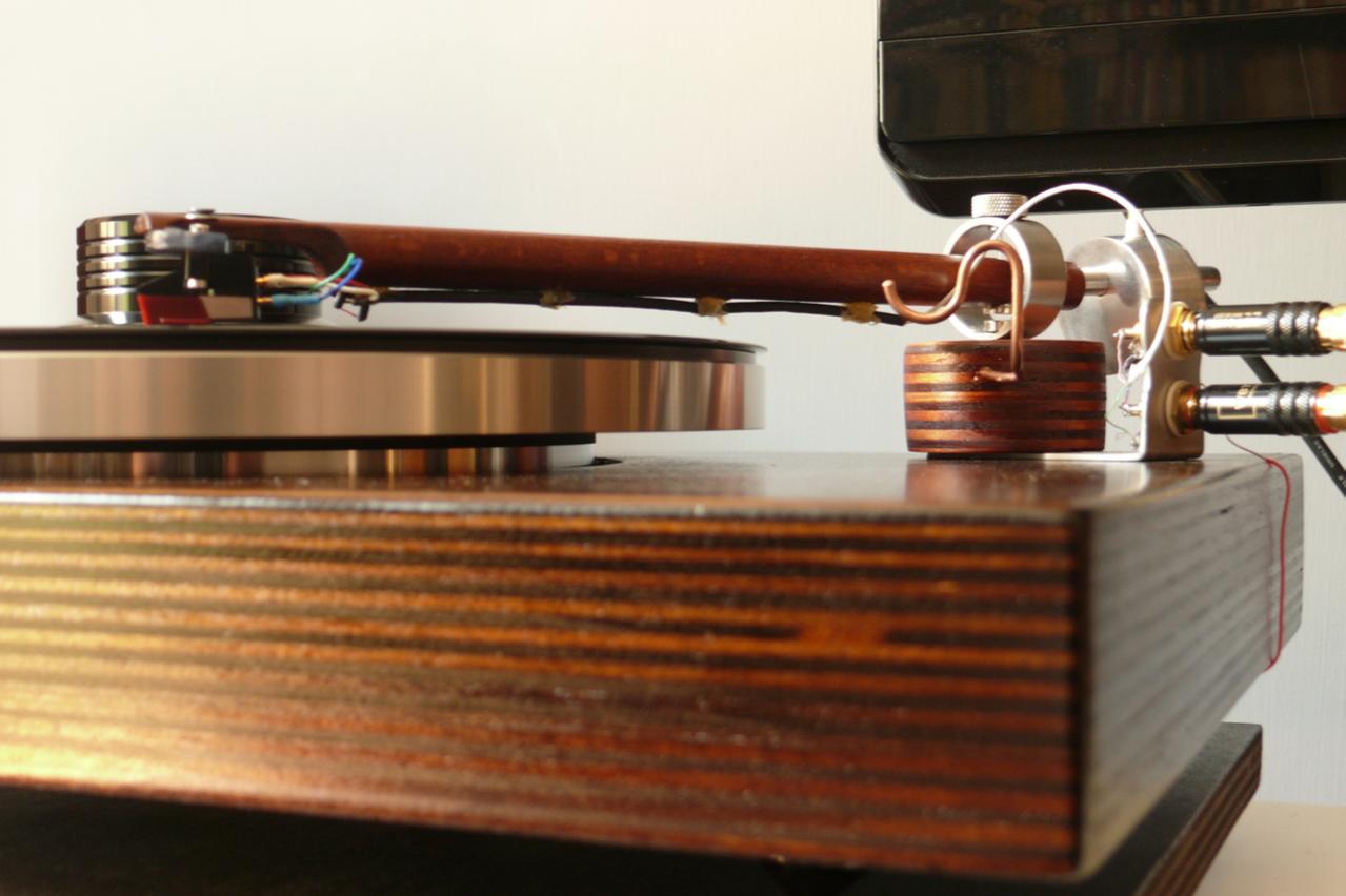

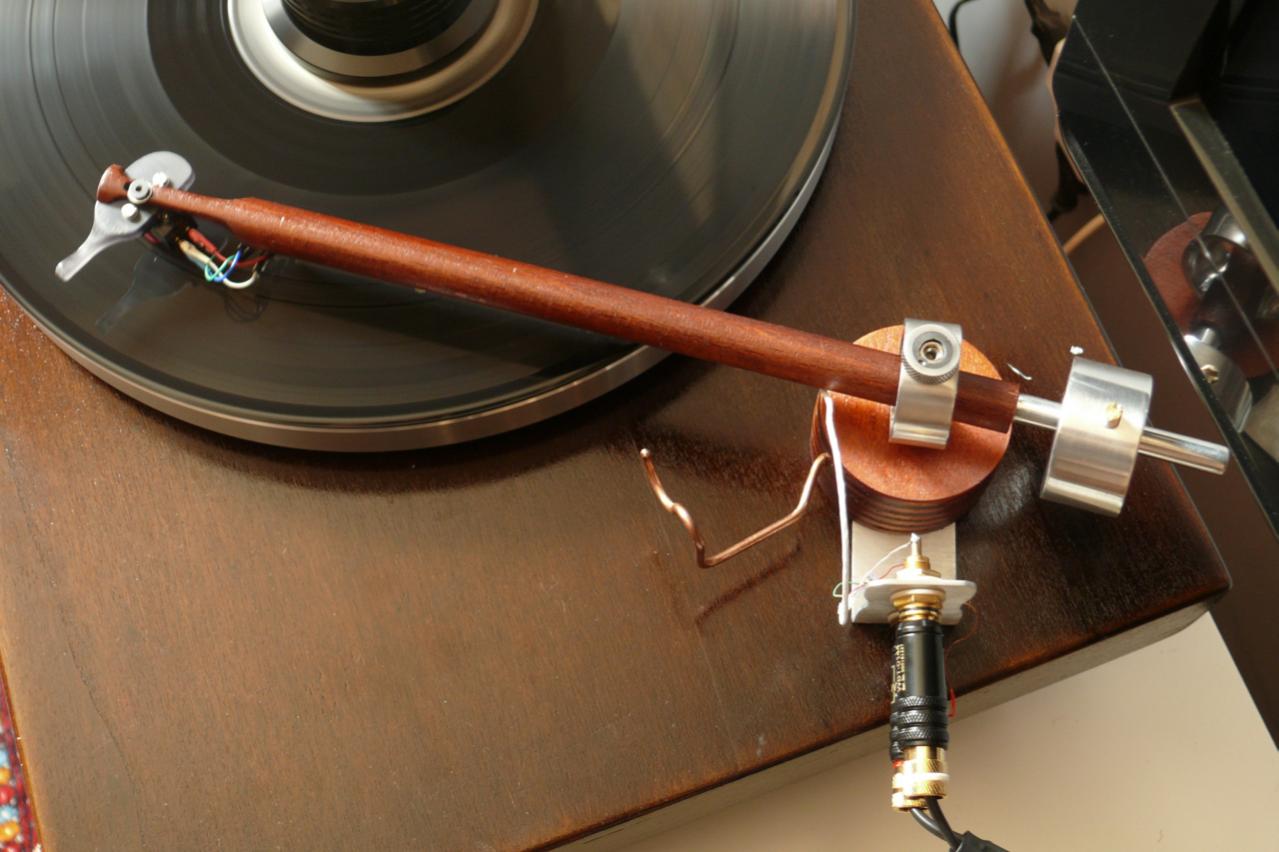

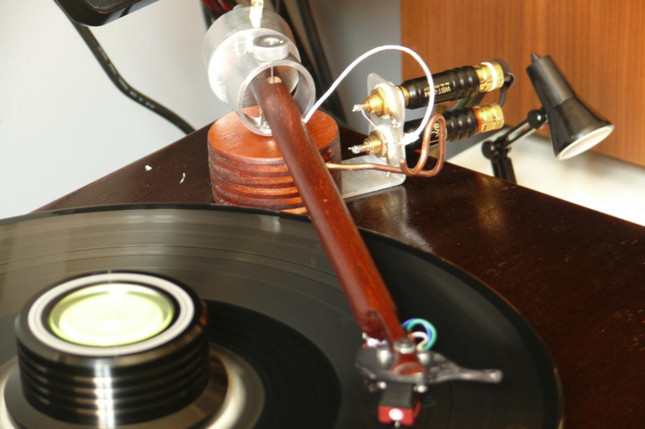

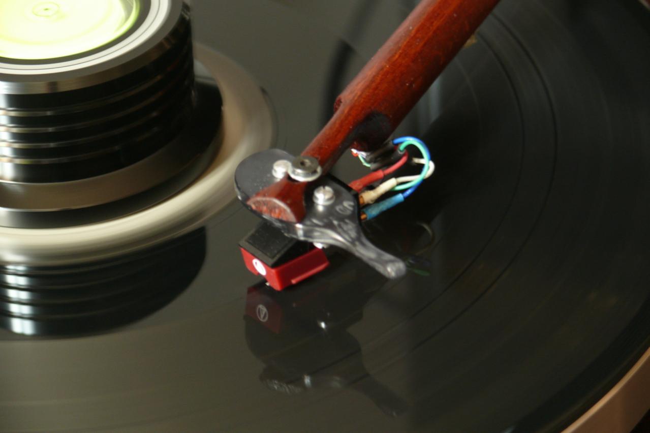

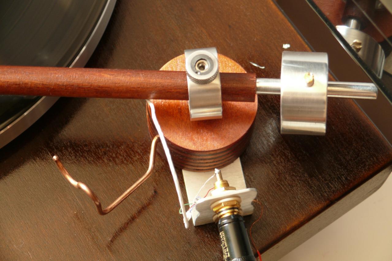

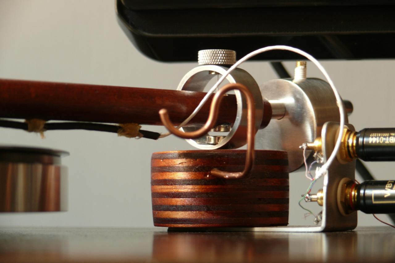

Hi all, this is my project based on Schröder concept. It's very rough, I builded it only for test and compared in this first (very poor) implementation, it sound better than my Rega RB250… I think that I'll rebuild it with better precision. Now it doesn't works properly, VTF change easily and if I beating on plinth, woofer moves. But, with help of this wonderful thread, now I the necessary knowledge to make something better.
Thanks All, specialy to Berlinta,
Corrado

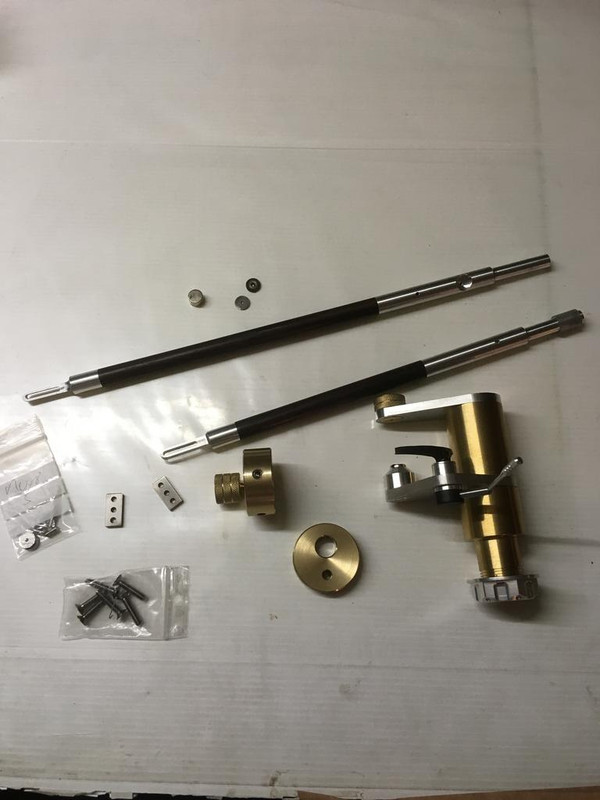

I think you should try this version. It's way easier to adjust.
I haven't seen that design before. I can see the allure of trying to add an adjuster, however, the freedom you introduce in the short horizontal axis places a larger burden in matching the adjuster holes with the hole for the magnet (which appears to be a potted magnet with mounting threads?). Adjusting that thing looks like trying to fly a helicopter.

Hello gentlemen,
I hope I'm not overly late as I only check this thread when diyaudio sends a notification...

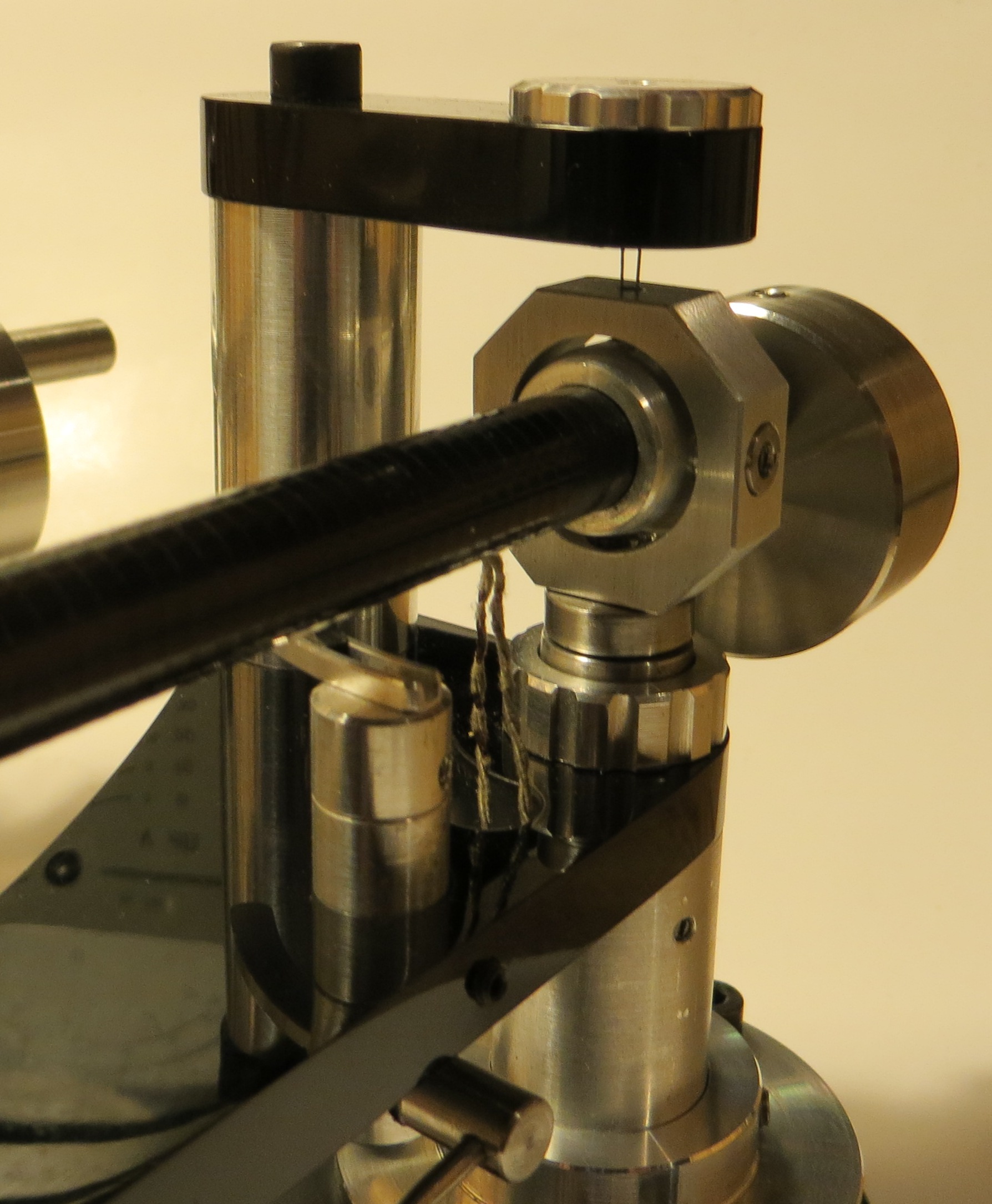

EAlex arm appears to be much closer to the Exact tonearm, based on Mr. Tietze's patent from the 80s, just upside down and with a little bit of Well tempered arm(two suspension threads) added to the mix. I see no reason why this one shouldn't work well, despite the potential issues with such a design.
@skyraider. The above design does not require drilling/polishing any holes for the suspension thread, so it's DIY friendly. I you intend to test various threads and need to exchange the thread frequently, it would be better to run the thread over a defined notch("attachment point"), which also needs to be centered relative to the lower magnet.
Which brings me to Corrado's arm. nice first attempt, but there is no provision for said centering, so your Azimuth and VTF are most likely to change over the radius of the record. You need to address that in your next implementation.
