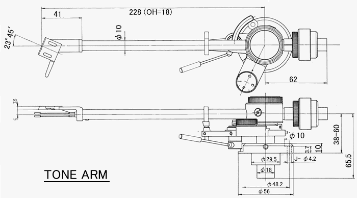

Hi Bill,
That's nice, but risky. Sand will be having some amount of magnetic particles, right ? Are you using any process to filter that out ? What about chalk powder or wood dust ?
Can we use the dimension values given in the attached image for this implementation (at least some) ?
Bins.
Bins.
