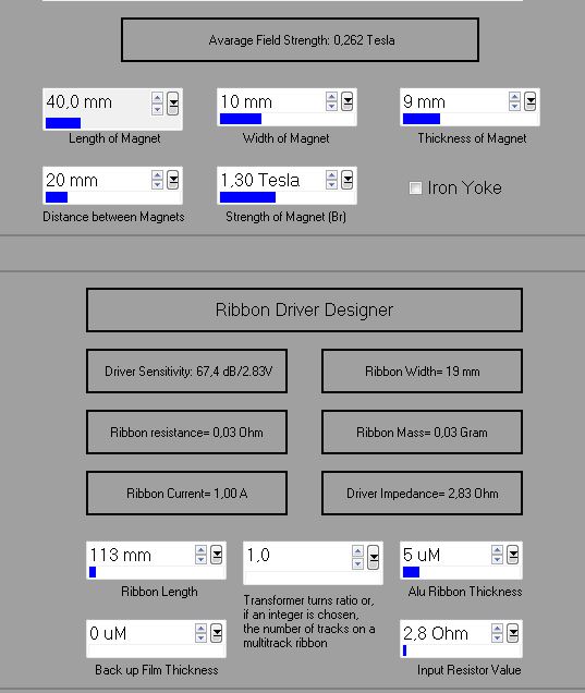

My intention was not to make a highly accurate simulation program.
The program was done for showing the implications of changing different variables, using some well known(?) equations.
Its impossible to simulate these things correctly if you think of the number of "small" variables like corrugation type, aluminium type, ribbon tension, dynamically changing gap between magnet and ribbon, baffle design, the effects of the nonlinear magnetic field, and so on into eternity....
But as You can see, the enclosed picture shows 67.4 dB for one ampere at one meter, which gives 73.4 dB at 0.5 meter......

…The program was done for showing the implications of changing different variables, using some well known(?) equations.
Do you happen to know the source for the equations?
The thread you linked to didn’t seem to provide much information on their origin.
I would be very interested to see their derivation.
I agree…trying to account for every design detail would lead to madness.
I think we are both after the same thing: correct prediction of trends for changes in major ribbon parameters. (field strength, dimensions, mass, current thru ribbon, etc…). Predicting the actual SPL level would be a secondary goal. The ribbon version of the Walker equation seems to provide a better match with measurements without adding any complexity for calculations.
You would need to reduce Average field strength to 0.19T and ribbon length to 100mm for direct comparison with the Gerrit measurements, giving about 69.6dB @ 50cm. But even so…what frequency would you be comparing with?

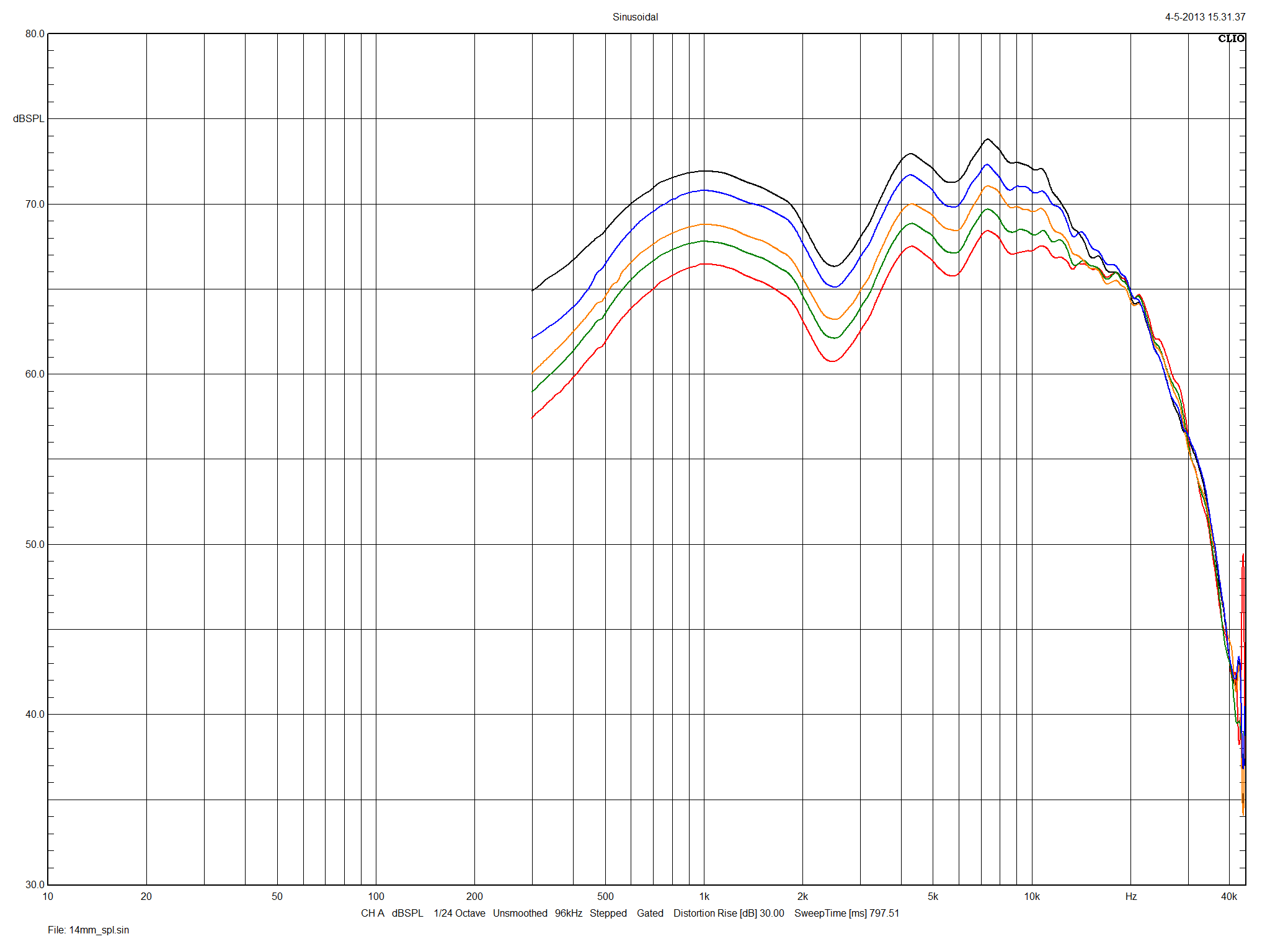

Here's a width comparison for a 40cm long ribbon, 15mm gap. Ribbon width 10mm (red), 11mm (green), 12mm (orange), 13mm (blue), 14mm (black):
For the recent designs I choose a 20mm gap to keep the excursion small because the field is not linear. I simulated a lot of designs in FEMM and found a 20mm gap to be the best compromise between field uniformity and radiating surface.

No, I do not know the source for the equations.
But I'll be doing some research.
I'm just a messenger who transformed the simple equations into a simple Delphi program, don't shoot me.
One thing is good with the program though, it made it easy to spot faults in the equations! (if there are any).
If anyone has better ribbon simulation equations, let me know so that we can improve the program together.
