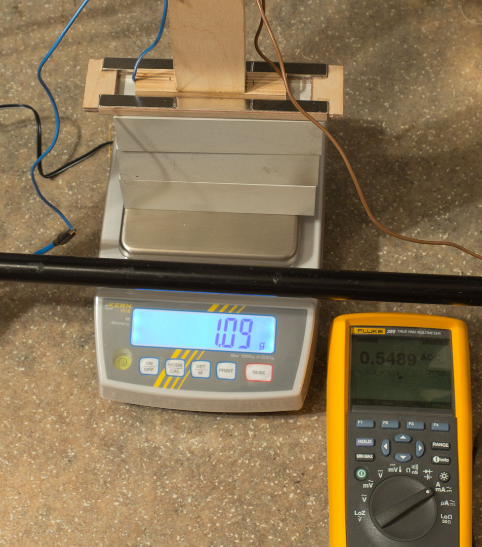

A while back I macgyvered this setup to measure the Bl product:
The minimal ribbon frame lies on the scale on top of three aluminium profiles (to create some distance to the scale). Mounted to the table above the piece of wood is positioned in the gap, a 10cm x 1.9cm copper foil is glued to the bottom. I figured that this would get me the average flux density. The scale is accurate to .01g. If you do the math on those two numbers you get a Bl product of 19mN, so the average flux density in the gap is 0.19T. This is a bit below the 0.24T predicted by FEMM but this is a view from above simulation and I don't know how accurate the simulation is.

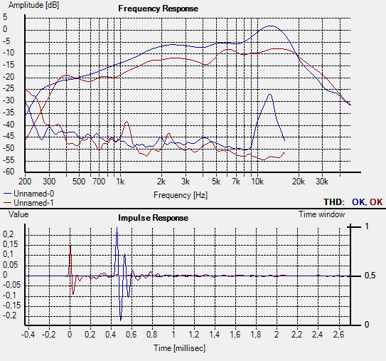

Speaking 'bout distortion, I have had this pair of B&G Neo8 laying in a drawer, not knowing what to do with them.
Almost useless with their hump and distortion peak at 13 kHz.
So, today, I decided to investigate what this peak is all about, and I have found a cause and a solution to the problem. (I think). See the differences in the graph...
Blue is before, red after remedy.. blue impulse is delayed on graph for clarity..electrical signal is not altered.....no new damping material...
The solution is quite amusing, lets see if You can nail it...

Do tell!!

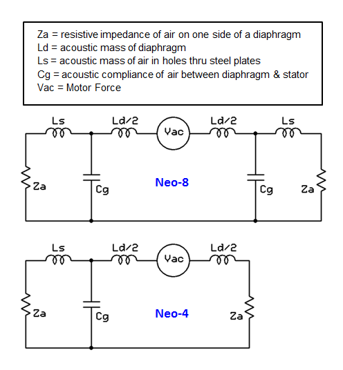

The peak is a mechano-acoustic resonance between the mass of the (diaphragm + aluminum traces) and the compliance of the air in the cavity between the diaphragm and the openings in the outer steel plates.…I decided to investigate what this peak is all about, and I have found a cause and a solution to the problem. (I think). See the differences in the graph...The solution is quite amusing, lets see if You can nail it...
From the measurement, my guess is you removed one of the outer steel plates. You would of course lose half the magnets so that would explain the loss in sensitivity. The resonance peak is reduced in level since there is now only one resonant system and the diaphragm is now better damped by the radiation impedance. Simulation would suggest you are measuring on the side from which you removed the steel plate. I’m not sure if you measured from the other side yet, but response will be slightly different in the top octave.

bolserst, you are spot on! (as usual!)
And, yes, the measurement is taken from removed plate side.

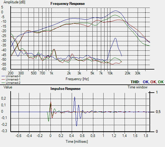

Adding a graph of measurement from magnet side, green trace.
I think that adding two rows of holes so that you had six rows instead of four, would make the problematic distortion peak less prominent...

I already had the scale available and with d=0.01g it's pretty accurate. The max load is 1000g so the dynamic range is 100dB

What are the measurement conditions (distance, SPL, smoothing)? You also need to compensate for the loss in efficiency and keep the levels equal otherwise you can't really compare the results.
To me it looks like you exchanged the distortion associated with the main resonance for distortion peaks at lower frequency. For this kind of comparison it's also important to look at the different harmonics.
Bolserst: Can I ask for a bit more detail?
- Perhaps I'm misinterpreting your statement. Are you saying that removing one plate increases the radiation impedance? I would have thought each perforated plate would add to the radiation impedance seen by the diaphragm so removing one plate would decrease the radiation impedance.
- When you did the modeling did you find that the resonance frequency matches the diaphragm-plate distance and not the plate-plate distance? I was thinking of the resonator as consisting of two perforated plates separated by a gap (and driven by a central diaphragm). Should I instead think of each diaphragm-gap-plate system as a resonator and then couple the two resonators to form the two-plate system?
Also, Jonas, is the distortion in your "before and after" plot the total harmonic distortion or just one distortion product (second or third, for example)? With one plate and set of magnets removed the symmetry of the system is broken and it seems that change should be reflected in the even vs. odd distortion profile.

Few, its THD that is showed in graphs....
I will do some new measurements showing 2:nd and 3:rd harmonics in B&g Neo4 and Neo8. (Neo4 is my name on Neo8 without front magnet plate.)

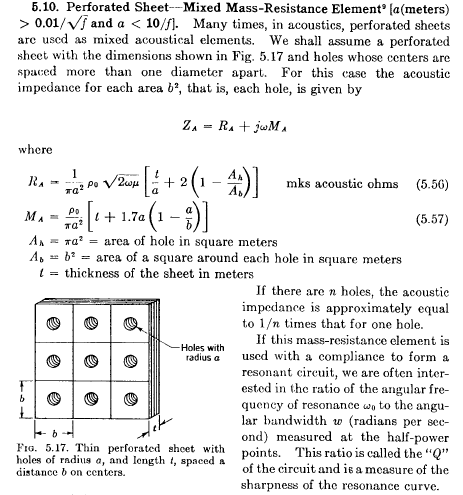

Simplified modeling can be done using a lumped parameter analogous circuit as outlined in Chapter 3 of the Beranek Acoustics text book. Without going into great detail, the attached figure should give you an idea of what it is about. The radiation impedance can be simplified by assuming we are dealing only with high frequencies (ka>1) where the resistive component is dominant. This is an impedance analogy, so inductors are masses, capacitors are springs, the voltage source represents Force on the diaphragm, and the output pressure is voltage across either the front or rear radiation impedance. Of course the tricky part is determining the values of the elements. Also, the %open area of the steel plates will affect the “lossiness” of the compliance, making it not act like a perfect spring.Can I ask for a bit more detail?
For the Neo-8 the diaphragm is so heavy, the mass of the air in the holes in the steel plates is not a bigger player in defining the frequency of the peak. However, the same model applies to ESLs and the mass of the air in the holes of the stators can be as large as the diaphragm mass…sometimes larger.
Does this brief explanation address all your questions?

I guess it depends on your definition of radiation impedance. What I was trying to say was that the airload on each side of the tranducer is unchanged at high frequencies and is the characteristic impedance of air = (air density) x (speed of sound). With the (steel plate + magnets) removed from one side of the Neo8, the airload is now directly imparted to the diaphragm without the reactive acoustic components of cavity compliance or small slugs of mass in the holes in between. This would increase damping of the resonance.Are you saying that removing one plate increases the radiation impedance? I would have thought each perforated plate would add to the radiation impedance seen by the diaphragm so removing one plate would decrease the radiation impedance.
That’s a good question. Although we like to think in terms of individual resonator systems, Spice simulation indicates there is significant interaction between the acoustic elements. With that in mind, I’ll try to describe what I did, and see if that answers your questions.When you did the modeling did you find that the resonance frequency matches the diaphragm-plate distance and not the plate-plate distance? I was thinking of the resonator as consisting of two perforated plates separated by a gap (and driven by a central diaphragm). Should I instead think of each diaphragm-gap-plate system as a resonator and then couple the two resonators to form the two-plate system?

Thanks, Bolserst, for the thorough replies. I had a different picture in mind so it's enlightening to see your approach.
First, regarding your circuit simulation of the system. Did you have realistic values for the various components in the circuit, and if so, did it accurately predict the resonance frequency?
Might there be a resistive contribution from the air moving through the perforated metal plate or are the holes' diameters typically too large for that to be significant? I was first thinking that the resistance from the holes would help damp the diaphragm so removing one plate would reduce the damping, but perhaps that's incorrect.
I tried looking at the problem by thinking of the partially reflecting perforated steel plates, separated by a gap, as an acoustic etalon, analogous to the ones used in optical systems. There, two partly reflecting mirrors are placed parallel to each other, separated by a small gap. The system exhibits optical resonances resulting from the "echo" of the light between the mirrors. The resonances are characterized by wavelengths of light at which the system exhibits very high transmission of light.
When I use your reported Neo 8 plate-to-plate distance of 6 mm I calculate a resonance frequency of 28.8 KHz so that doesn't encourage me to continue that line of thinking. I'd need a plate-to-plate distance of about 13 mm to get a resonance frequency of 13 KHz (unless I'm missing a two somewhere...).

Yes. Using equations in Beranek text to determine component values produced surprisingly accurate prediction of the resonance frequency and Q. It’s been a while since I’ve messed with the Neo-8, been mainly concentrating on ESL modeling as of late…will see if I can locate a comparison plot.Did you have realistic values for the various components in the circuit, and if so, did it accurately predict the resonance frequency?
Indeed there is, but the resistance is exceedingly small until the holes get < 0.1mm diameter.Might there be a resistive contribution from the air moving through the perforated metal plate or are the holes' diameters typically too large for that to be significant?
Similarly, to a first approximation the acoustic resistance of damping mesh is inversely proportional to the square of the hole size.
