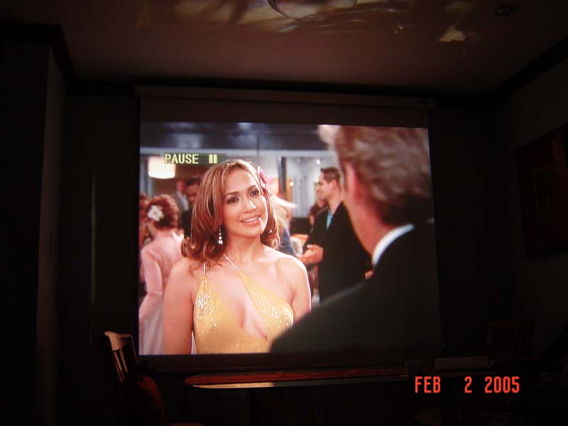

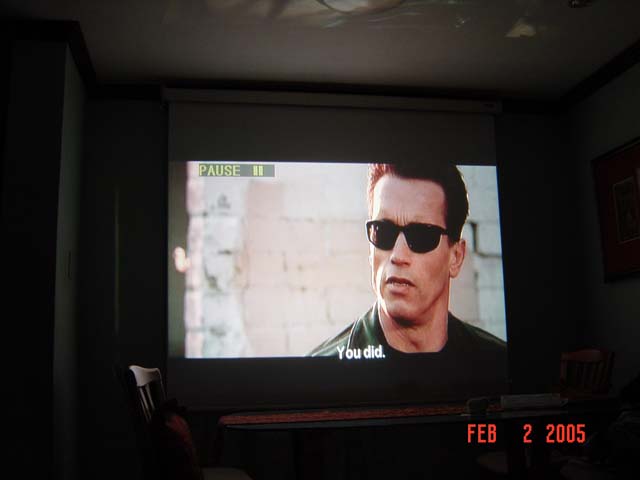

hertzblaster said:MY PJ!
Dude I seriously think your projector looks WAY better then the dlp530, the coloring is SO much better.

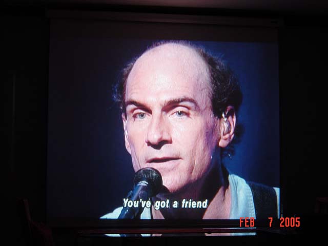

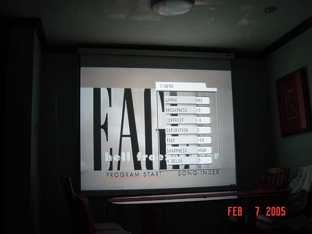

As can be seen in the OSD, Gamma and sharpness is adjustable. For Pioneer DV266, only Brightness, contrast,hue and saturation are adjustable. JVC called their processing as VERSATILE FINE PROCESSOR (vfp)
Here is my initial evaluation
1. GAMMA adjustment is in 3 steps only. Low(default), Med and high. Setting the Gamma to med and HIGh will brighten up the image especaily in dark scene. I rate this adjustment as EXCELLENT.
2. Sharpness setting in 2 steps only. Low and High (default). Just a little useful for me
3. Contrast setting is from -12 to 12. Very good flexibility. What makes this very different with Pioneer DV266 is incresing the contrast will make blacks blacker, the color deaper and more saturated and the best of all , IT INCREASES THE OVERALL BRIGHTNESS unlike the Pioneer DV266 where the total image becomes dim as you increase the contrast. I guess this is the strength of this JVC model.
4.. Brightness adjustment is up to 15. Very good flexibility also.
5. I found the close caption as whiter and brighter than the Pioneer.
6. Pioneer has i guess a slight advantage in image detail and sharpness.
OVERALL, i prefer the JVC because of Gamma and better contrast processing. Image brightness overall is much brighter and color is more saturated than Pioneer Dv266
JVC price is $89
Pioneer DV266- $116

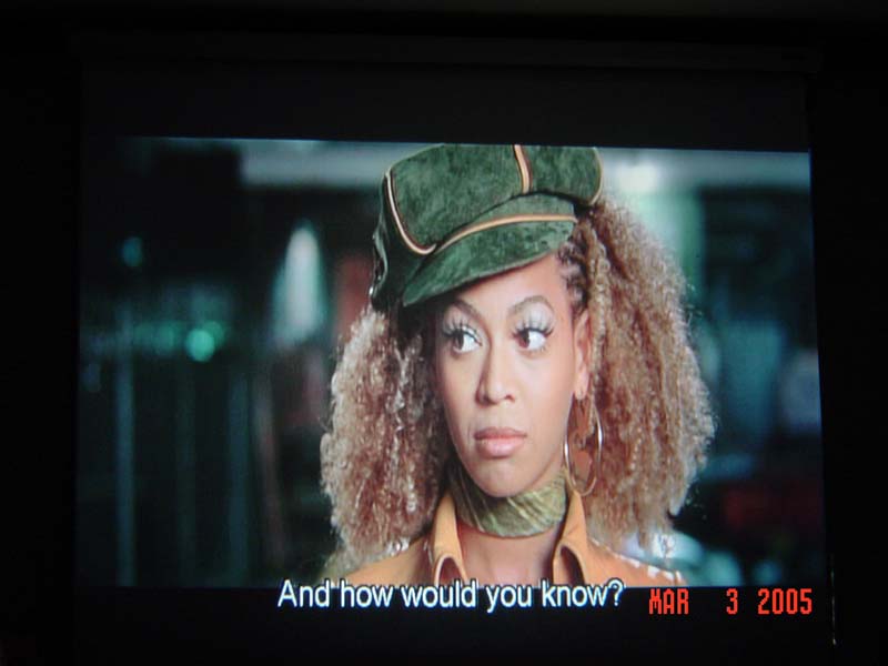

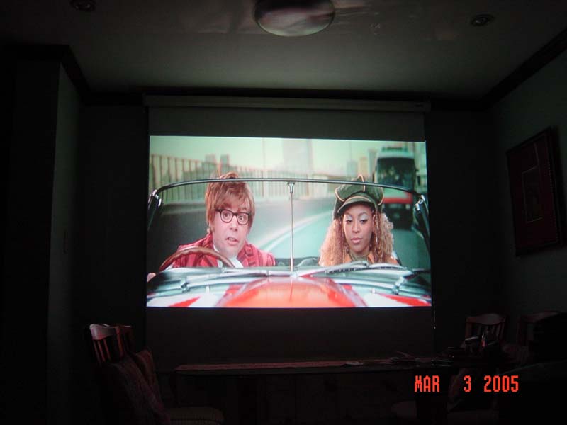

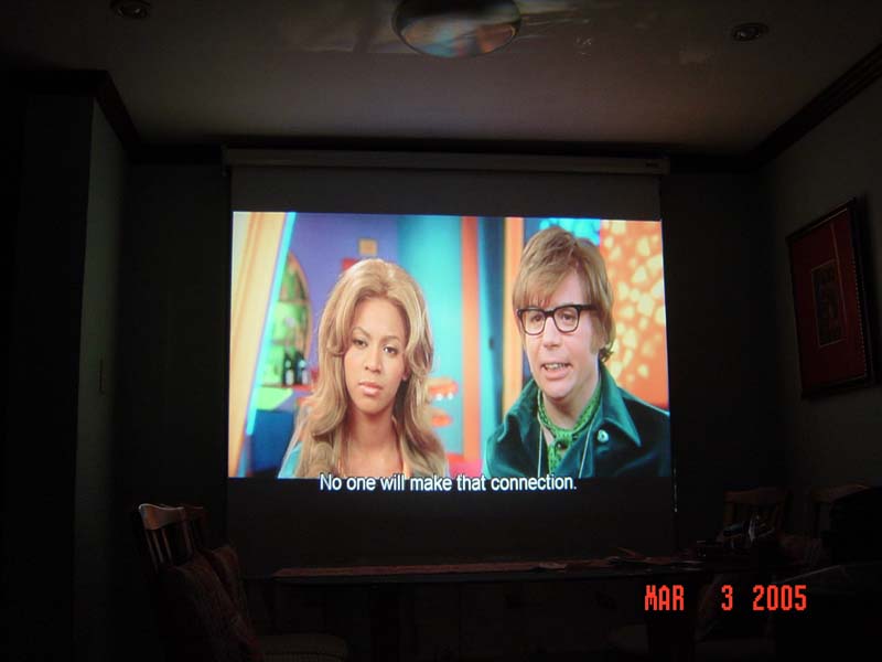

JVC's Gamma and contrast adjustment are excellent for movies. I feel like approaching commercial pj brightness.
Here is more of JVC has done to my image quality and brightness.
If you think of buying dvd player for your pj, have a second look at jvc model. its much better overall than pioneer.
The dvd btw is highly recommended. its one of my collection now.
