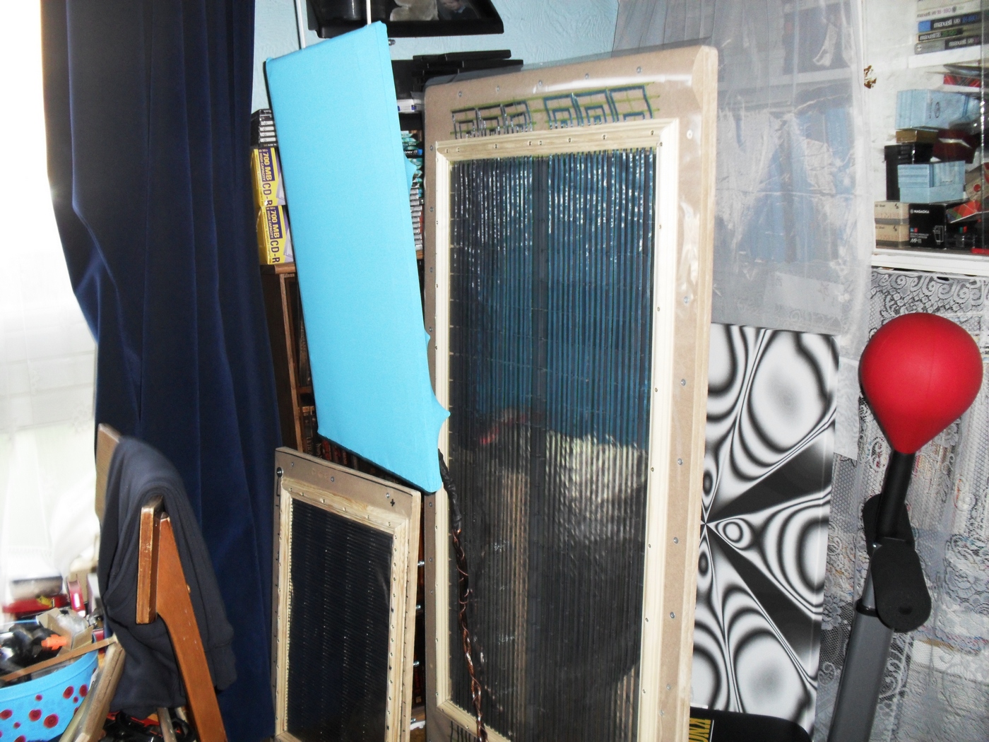

I am in the process of rebuilding my 20 year old full range planar which used ferrites. I have cut the alu foil down to 4.5 mm wide and I am using thinner black plastic bin liners from tescos. The sensitivity is increased significantly by using the lightest membrane you can manage. If it is a success using the thinner plastic, I will rebuild all my planars (10 pairs +). Using the thinner membrane design. You learn as you go along. It keeps my mind active and at my age 72 it's a good thing. HENRY.:D:hypno2: My planars go down to about 20 hertz. They also don't require crossovers or transformers or high voltages just 2 or 3 resistors. Depending on the size and impedance of the membrane.:)

yes I have bought a few thousand magnets from china and have been quite happy with their response.The postage is dear but they are still cheaper than anywhere else.I have designed several new designs using the epsilon diaphragm layout, even using ferrites the sensitivity is very much higher than my previous design which only used the interface with the N S layout.My latest design uses 360 50 x 12.7 x 6 mm neos. I had laying around. Using the epsilon diaphragm layout or my modification of it! The sensitivity is far beyond any design I had built before and I have built well over 30 full range planars. Using both neos and ferrites of differing sizes, from 60 x 40 cm to 7' x 2'. After modifying the epsilon layout, I have come to the conclusion I will have to rebuild all my designs as the increase in sensitivity is so spectacular .:eek: No crossovers or complicated electronics only good sound including the bass. A simple MDF carcass . So no heavy metal work or dangerous sized magnets. All you need is a jigsaw, drill, file,screws, penny washers, bolts, nuts, washers and a pair of scissors to cut the CPC 9 mm wide aluminium tape in half or a quarter if building A4 sized planars or planar headphones :sing::D
To finish the other one of the pair, I have to cut 45 meters of foil in half with a pair of scissors:eek: You can see the other one of the pair behind the chair on the left.

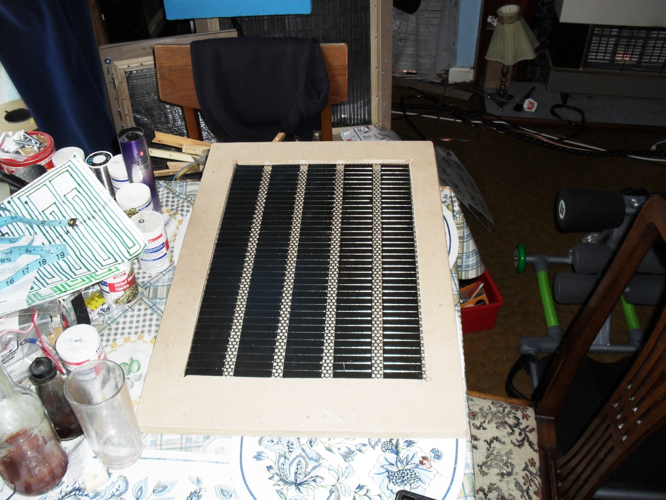

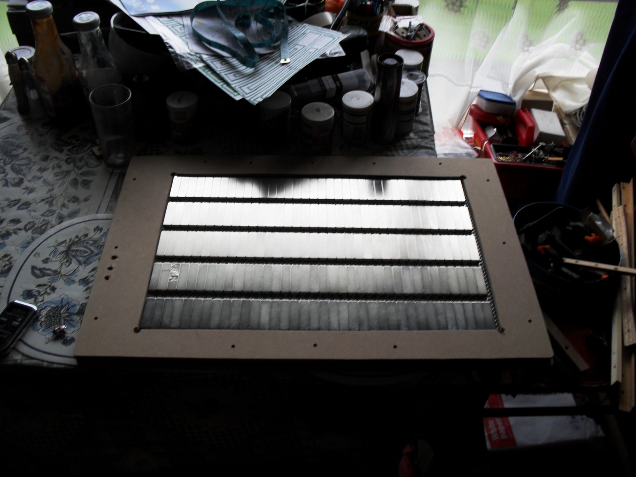

I already have built one with gaps between magnets, but it is not worth the effort of using glue they become very delicate and you have to move them very gingerly or the magnets come adrift .Unless you use a lot of glue!! The large one using ferrites, too dear with neos. The small one uses smaller magnets and it is just as sensitive, with no gaps between magnets so waste of effort using gaps believe me. I speak from experience.:) You can just see the small one on the right. In the second picture. In the first picture you can see the 60 x 40 cm using the 6 mm neos on the floor.

But you can glue distant-keeper strips of the same perforated material as the magnets are glued on, and aligning the holes. This would, I think spare You a lot of magnets and distortion.
Don't think so, that's even more fiddly cutting the perforated steel, it's hard enough cutting the perforated sheet once with scissors. So cutting it into long strips is almost impossible as it would form a circle as you went along at that width.Getting the holes lined up would be even more of a dilemma!!:eek: With over 30 speakers to rebuild I want an easy life.:D.Anyway using ferrites in the smaller newer design is as sensitive as the neo one of the old design. So you would save a lot of money using ferrites. Why do you think there is more distortion with my new design? There is a gap between the columns of 2 cms anyway! The final result is really down to how tight the mylar is etc etc.;)
