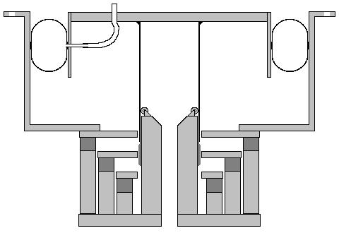

That said, here's my first stab at how we might accomplish this. (Sorry for the quick 'n dirty drawing, but I hope it's clear enough.)
At the bottom, we have a three-gap version of the Parthenon motor with a 4" dia. pole piece, using similar construction methods.
The suspension will be the tough part--here goes.
First of all, we have to essentially abandon the classic spider/half-roll-surround suspension model. It just isn't the way to go when you're looking for 3+" of one-way Xsus, IMHO. To center the VC in the gap radially, I suggest three small rollers mounted to the top of the pole piece, on which the inner surface of the VC former rides.
Serving double duty as spider and surround, I suggest . . . wait for it . . . a common bicycle tire tube! With an extension, the inflating stem would feed through the diaphragm, and you could inflate the tube to a variety of pressures, which would supply a variety of compliance curves. The molded shape of the tube would supply the return force toward zero VC excursion. As a bonus, the internal pressure would allow it to be both supple and immune to suck-back.
To be continued...

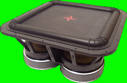

EXTREME AUTOSOUND
I believe this is 24" x 24"

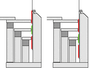

ooo ooo, furthering EM suspension, by increasing the winding height of the two suspension VC's so that they span greater than the distance between tiers, at high excursion two tiers will be acting on the suspension VCs still. The downsid being the increased height of the first tier from the bottom plate, more wire/weight bla bla...
it would appear, (considering the 4inch VC instead of the original 3inch, and the 3 sets of coloums, rather than the current 2) that this motor assembly would be somewhere near 12inches in diameter.... lol anyone see a possible problem with that? lol you'd just HAVE to go with atleast a 30inch cone with a magnet of that size hanging off the back.. lol am I the only one that finds that slightly insane??? LETS DO IT!!! heh

Vikash, interesting idea with the EM suspension. However, I'm suspicious it may be far better suited to lower-excursion applications. I'd always thought of it as working in tandem with ferrofluid to position the VC radially, (and reap the benefit of going spiderless) but ferrofluid is out of the question here, IMHO.
Also, in this app, there are the added difficulties of the necessary VC weight and the heatsinking for the large DC current the EMS coils would have to pass to keep control of this heavy diaphragm. And even if you were to use EMS, you would still need a surround to seal the basket/diaphragm juncture.

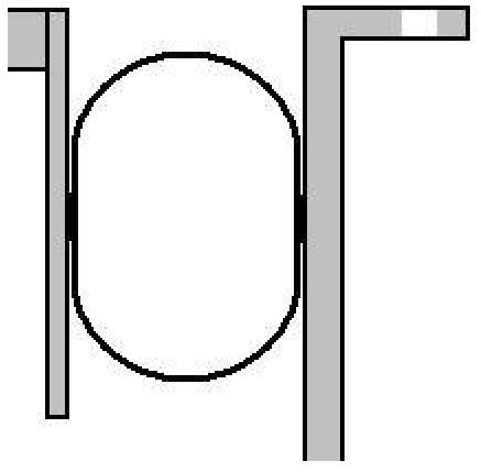

Now, to explain my bicycle tube suspension:
My first pic above was really too small to allow you to see much detail in the innertube suspension, so here's a blow-up.
As you can see, I'm thinking of attaching the tube at two small points along its inner and outer midline. This allows the tube to roll freely between the edge of the diaphragm and the basket in a large range of axial motion.

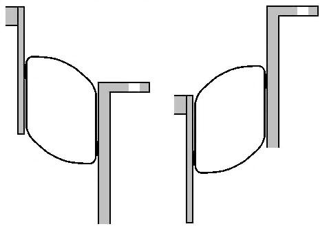

Here's an illustration of how the tube would allow large excursions.
Varying inflation pressure would alter the tube's diameter, thereby altering its compliance curve.
Since the tube was molded in a torus, the inner diameter is naturally smaller than the outer. Therefore, the elastic property of the tube's inner diameter will supply a measure of return force as excursion tends to turn it inside out.
Since the tube supplies radial centering of the diaphragm, return force against excursion, and seals the basked/diaphragm juncture, it functions as both spider and surround.

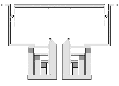

Hello, Bill... you continue to rule!
My hypothesis was something more akin to an old 2-way door hinge, like an old saloon door (as I stated on CAT) - applied to a surround.
I drew a picture, attached to this post.. pardon the poor artistry.
I don't think the tube will work... my basis for that is the old Earthquake passive radiator.
It was a nifty rigid flat panel, suspended with two back-to-back half-roll surrounds.
So why my doubt? One of the half-rolls (the bottom one) had holds drilled through it every few inches, to allow air to escape... because the changing shape meant changing air pressures. The higher the excursion, the less space inside.
If it were pressurized, wouldn't that limit your excursion?
As regards CES and XBL^2...
I just wanted to point out that CES is going to be doubly exciting in the scope of high-excursion motors!
Not only is Adire bringing a fully functioning 24"x24" driver using the XBL^2 Parthenon motor that they've developed...
...but Resonant Engineering is also bringing an XBL^2 subwoofer, with 80+mm... utilizing a 24"x24" panel.
I'm particularly interested in the RE driver to see if it is a distinct XBL^2 design, or simply a Parthenon.
Mostly, I'm interested in the suspensions for these two drivers.
I understand how XBL2 can be architected to yield obnoxious excursion... I'm excited to see how it's realized in application with a suspension that can keep up.

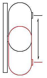

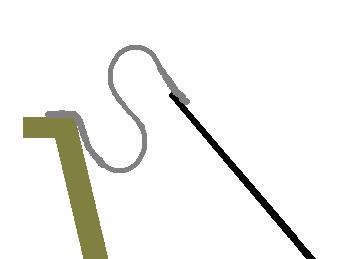

Here's an idea I had a long time ago as a surround for this thing.
What you would do is have two slinkies, one slightly larger in diameter that the other. Between them would be a piece of stiff cloth that is air tight. It will look a little like this:
Dan told me that this has been done before a long time ago, so there is no patent possibility. But I think with some ingenuity it would work quite well. The downfall is that it would need a custom basket, but the Parthenon already needs one. The advantage is that you won't have to worry about losing Sd from the surround.

Interesting take on the surround--sort of a crunched sinusoidal (is that a techincal term?). Looks like it certainly could allow good excursion.
My only question (and this goes for Steven's version, too) is how much radial centering force it would contribute. Even if your VC former has a good spider or some other means just above the top of the motor to center the coil radially in the gap, if your surround allows the diaphragm sideways play, the former gets rotated off-axis and your coil will end up kissing the motor at some point (especially in one so deep & multiple-gapped). I'm not saying that your surround wouldn't be good on this point, just that that's a question that pops into my mind. Have you ever mocked up your idea and tested it?
Yep, the earthquake PR was my inspiration...
Yeah, I'd thought about that. IF the enclosed space has a circular cross-section, you are right that any excursion would distort it and change its volume, as I believe is the case with the Earthquake. But if you sqeeze that circle between the diaphragm and basket and connect it at two narrow bands like I'm proposing, you get an oval that can roll through a lot of excursion before there's any deformation/change in volume. My previous illustration wasn't ideal since it shows the shape of the innertube as it surpasses Xsus and goes nonlinear. Below is an illustration of how I picture it working within its linear limits. Notice there's a large range of motion with no deformation. It's just my theory right now, but I hope that's how it'll work in real life.
In this application, I believe the inflation pressure would pretty much just change the volume of the tube, which in turn affects the dimensions and the elastic pre-load on the rubber. So you might inflate it more if you want more excursion, but you'd also be stiffening the suspension. There's a bunch of variables here, so we'd have to run some emperical tests to really know how well it'll work.

1) The tube will take up a lot of energy....it stretches as well as rolls. Besides that its not common to see tubes cast of high quality, so the tube walls are not even.
2) The tube will not be able to keep the pressure as is. Any tube ive seen till date looses the pressure over time (through the tube and the valve)....and thats fairly fast.
I like the idea of a tube though, and the problems stated above can be solved im sure.
Magura
I dont know what sort of tube you expect to use, but you will have to sort out two problems:
Magura
Mark,
I agree there's potential for noise from the rollers guiding the VC former. I'm hoping that if the rollers were rubber where they contact the former, it shouldn't make noise. I'm open to any other suggestions of how we could get radial centering with infinite compliance.
Yes, I agree. That adhesion will have to be very robust. It'll take some experimenting.
Vikash's earlier comments remind me of one other possible thing we could try to take stress off the adhesion: We might rig up a couple of braking coils mounted above the top gap and below the bottom one to absorb most of the kinetic energy before it stresses the suspension.
But I like your surround idea. The only part that I have a problem with is in the actual adhering the "inner tube" to the basket and the diaphram. It must be both mechanical and glued to survive the stress.
