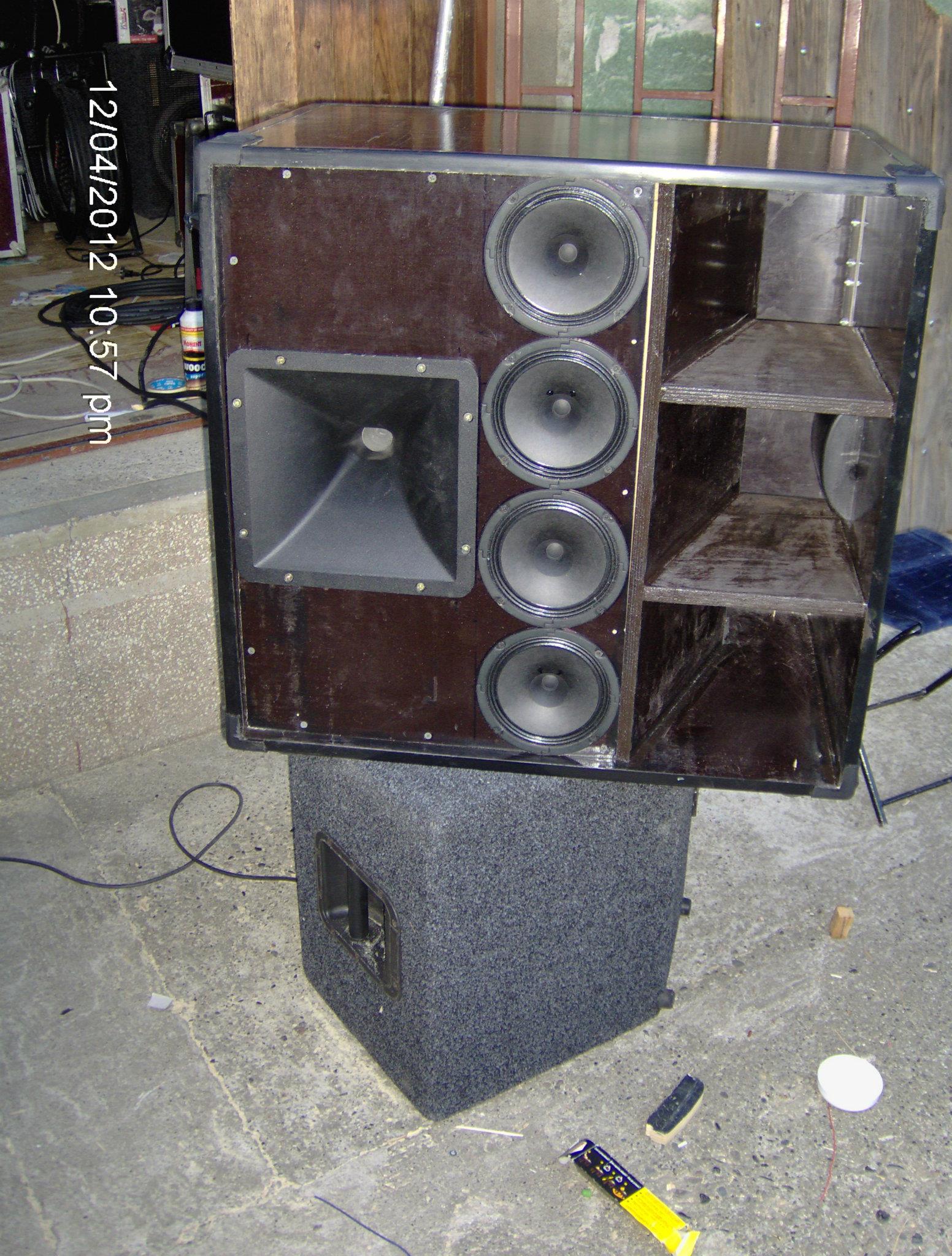

DIY PA Speakers Setup (Line Array)
Bass 2x12inch + mid 4x6inch + 2inch HF driver

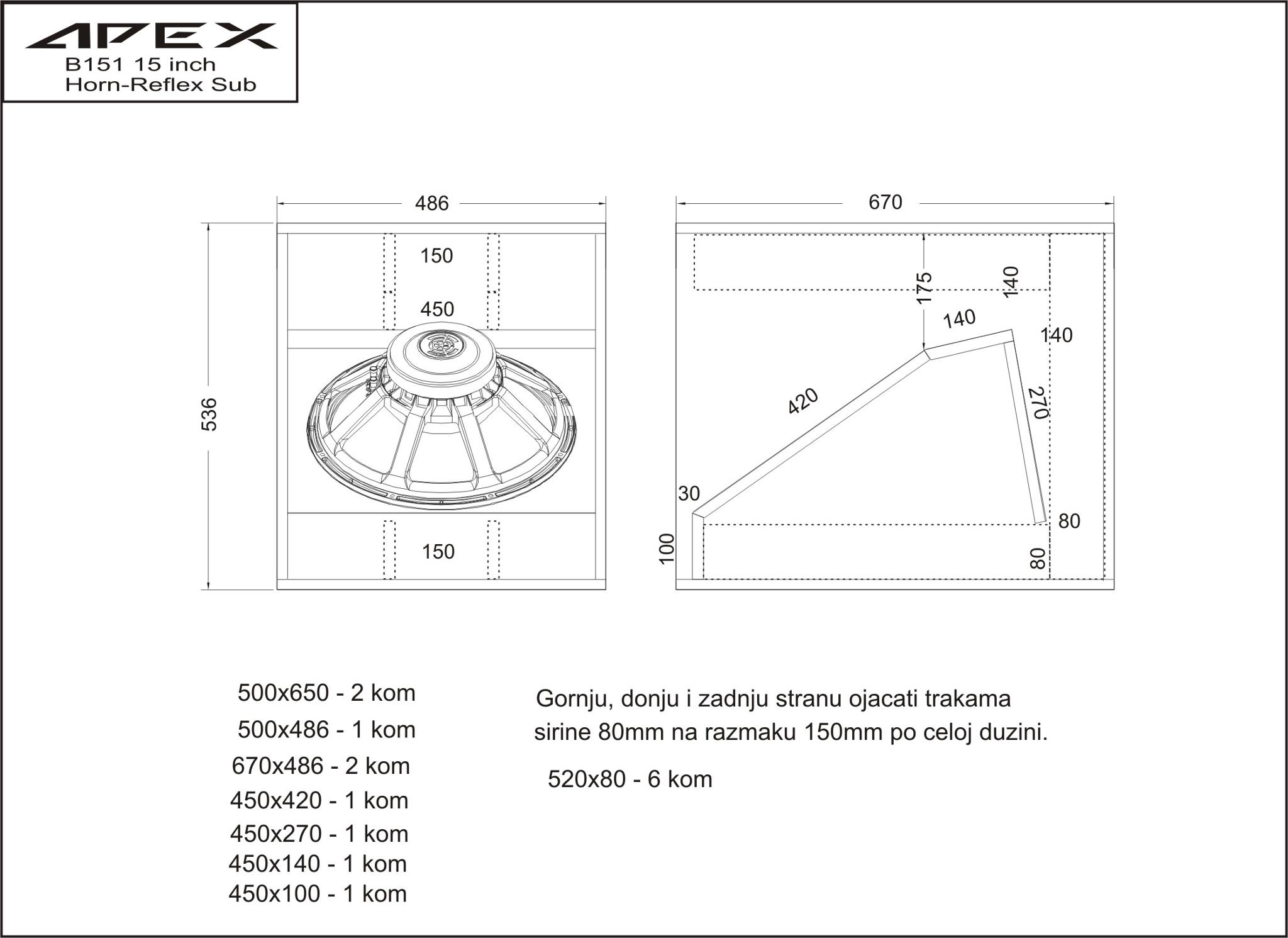

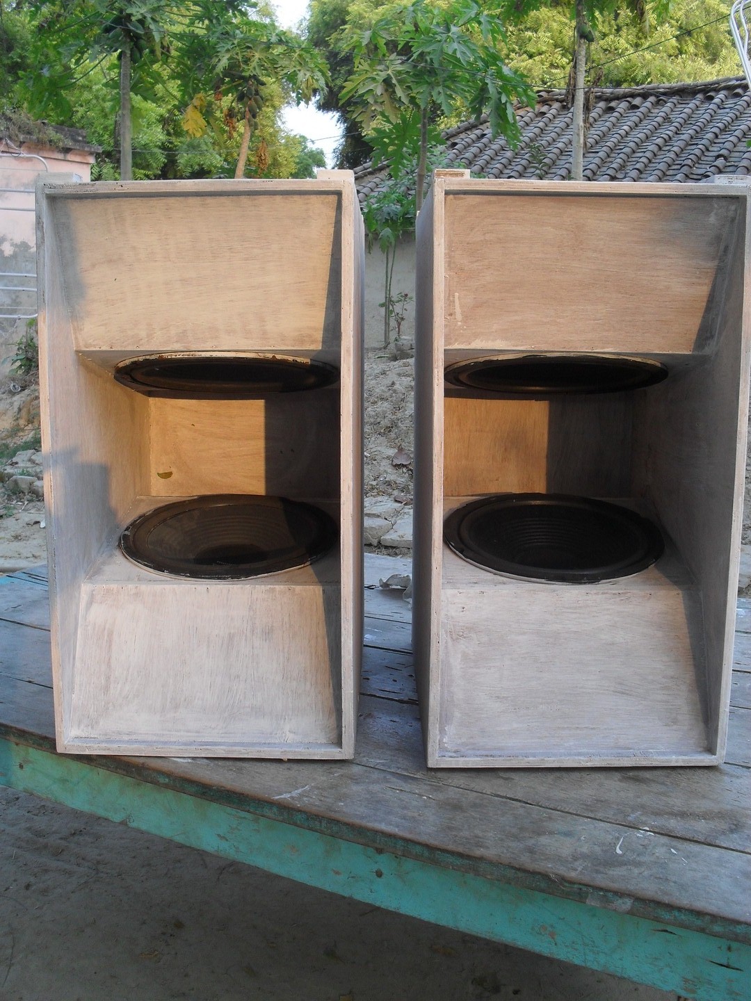

15"horn enclosure
Hello, i found here some 2x12", 2x15" 2x18" and 1x12", 1x18" enclosures, but i did't found any for 1x15" horn/BP enclosure, can You share some of them mr Apex? I'm interested in building two small, but effective subs based on 15tbx100 or 15nw100 or similar from B&C.
PS, i think in 4 ohm option of this speakers they would work well with your H900 based power amp.

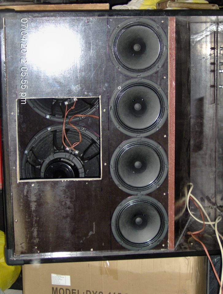

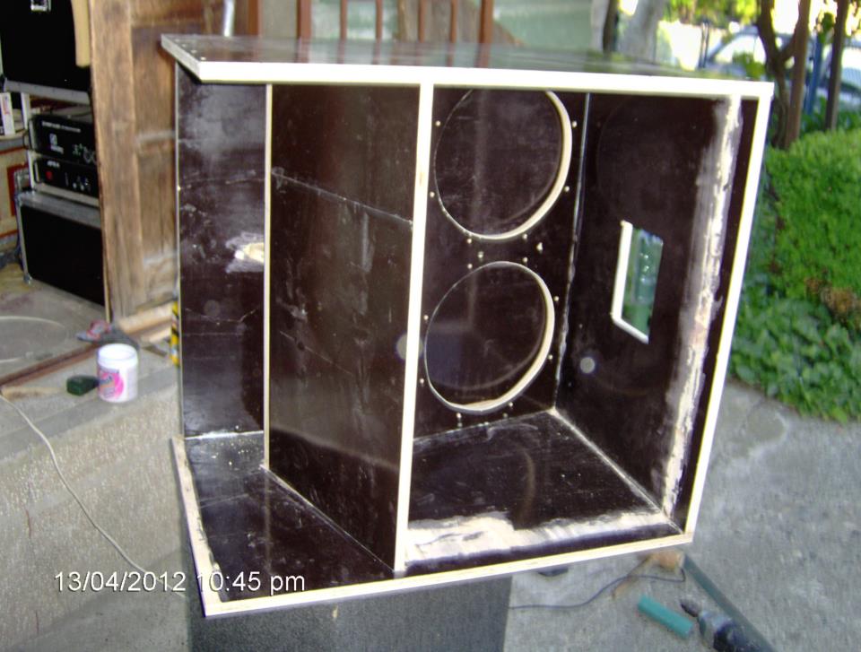

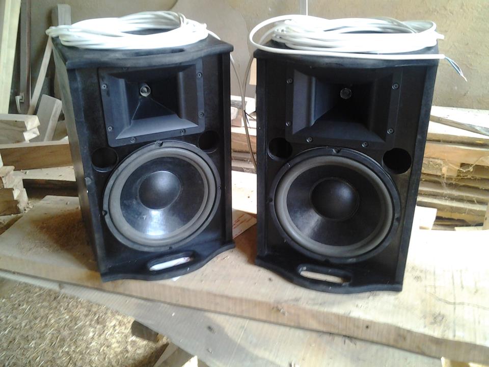

Sat pictures

I don't like half of them , I'm not gonna build 'em ! Better building big sealed CONCRETE boxes !! They're gonna rock ! Sure !!
I'm jocking..but ; if there isn't any improvement over the market speakers ,what is the
purpose of a DIYer ? Do you know if there is any difference by putting the top box horizontally or vertically ? I just came to know that an array source can offer a really wide and long soundstage but that after a looooong study and a perfected tecnique.
Take some Valium, brother! Apex is just making suggestions; nobody is forcing you to build anything you don't like. But I think the point of a DIYer is to build somebody's 2000-dollar design and build one that looks and sounds like it but for a quarter of the price. Do you think you are smarter and better equipped to out-design the R&D departments at JBL and EAW??

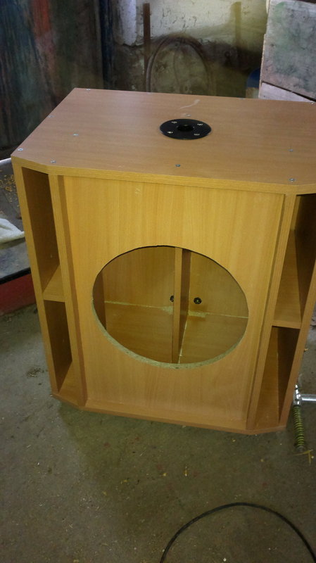

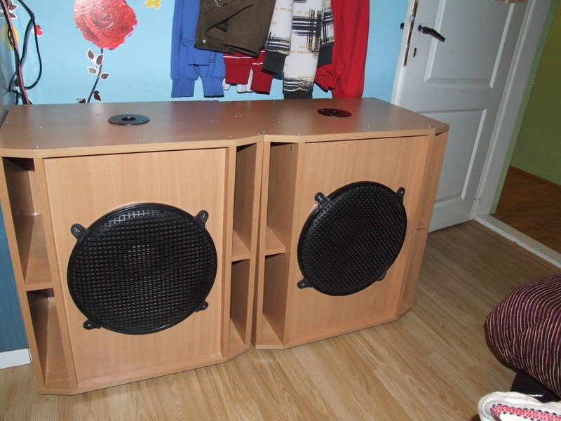

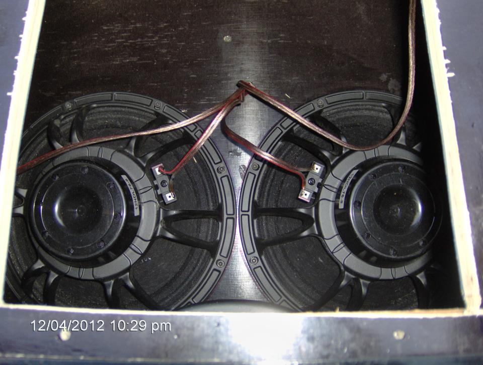

Dear sir Apex,
I am using your design with 12 inch drivers.Response is very good with 3- way active crossover system.It is driven by your 'quasi amp for beginners' amplifier. I want to know that does it need any subwoofer filter circuit or fine with 3 way active crossover ? Also please suggest me anything suitable to cover front opening of this box.
thanks
sudhir.
