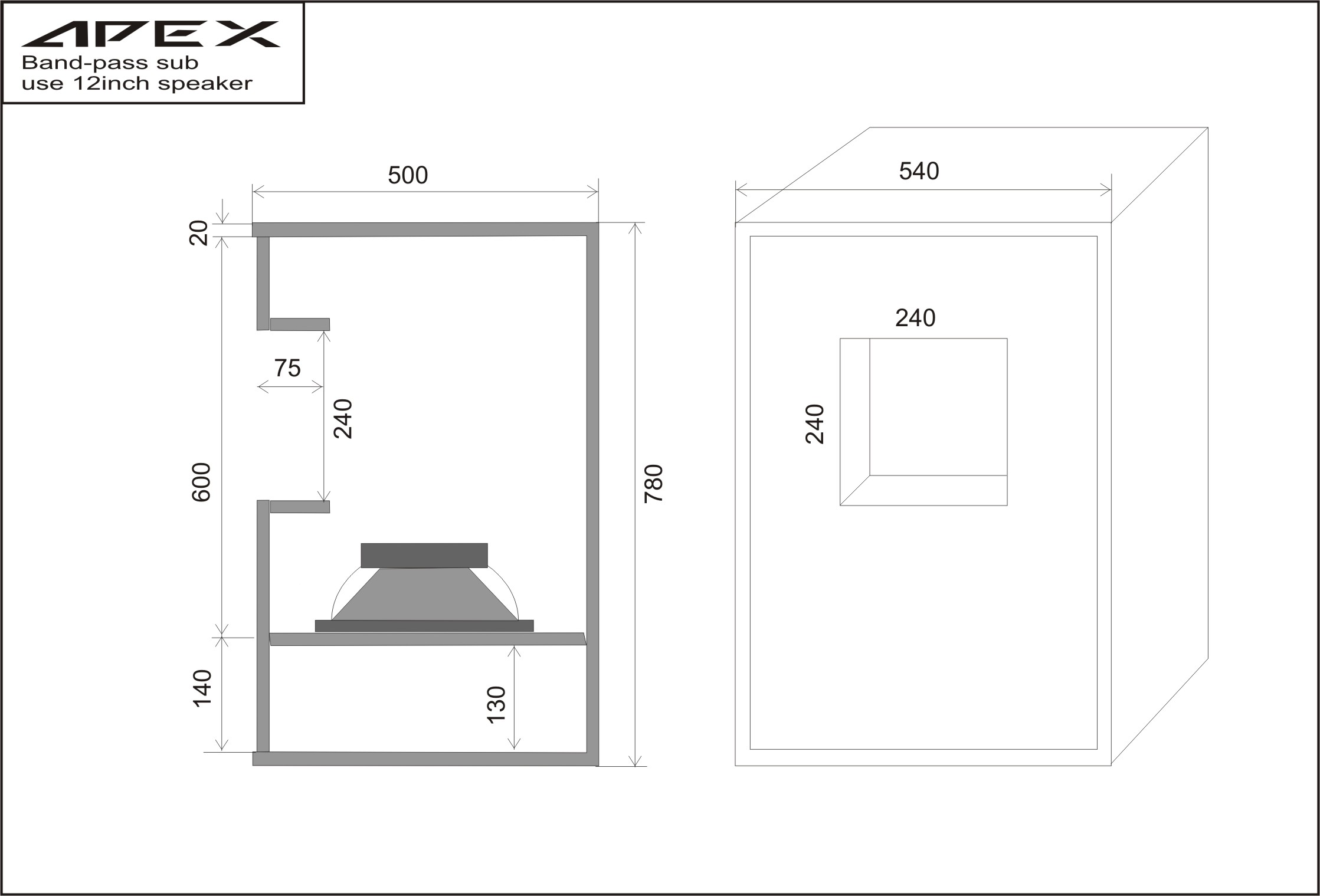

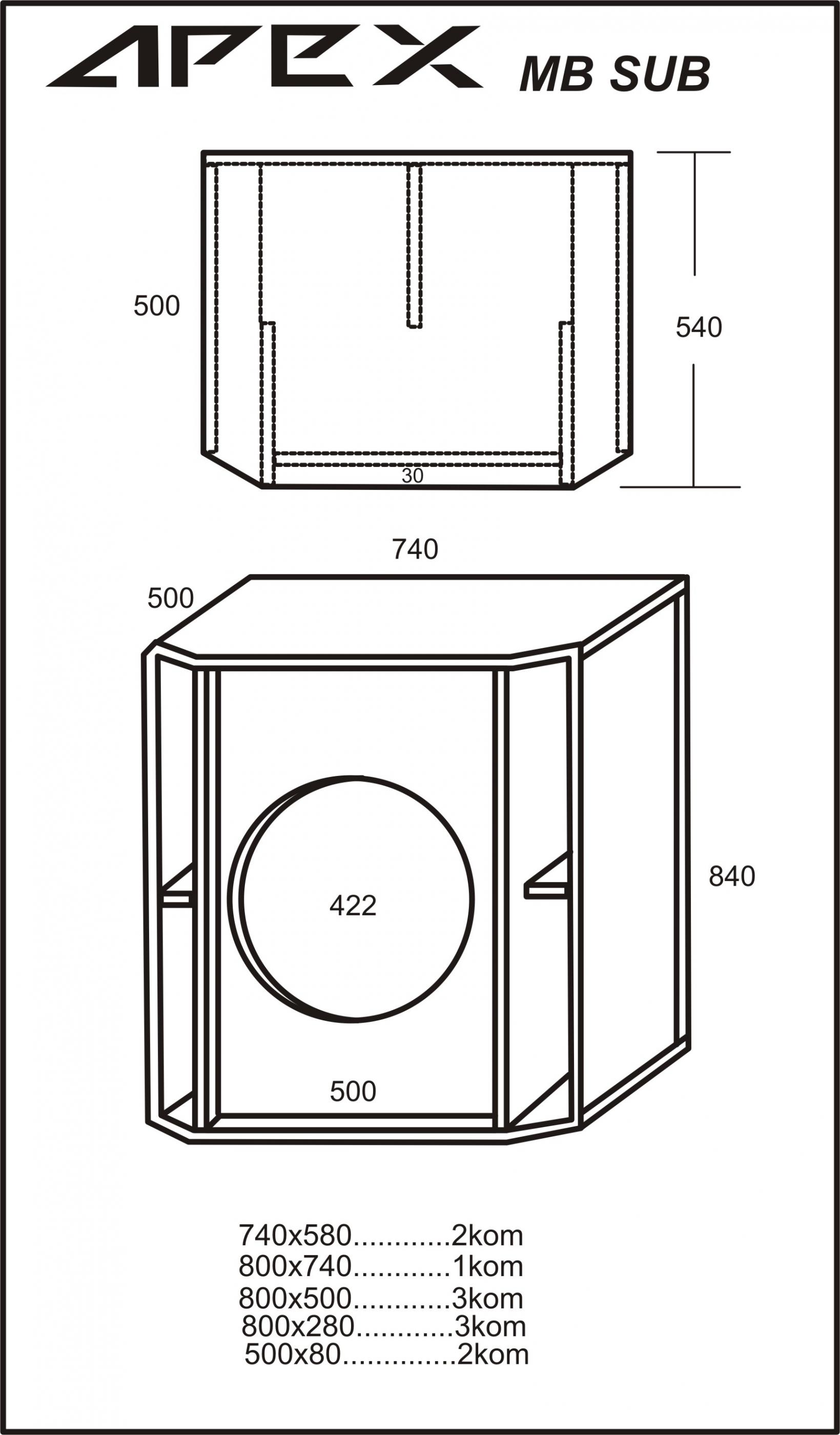

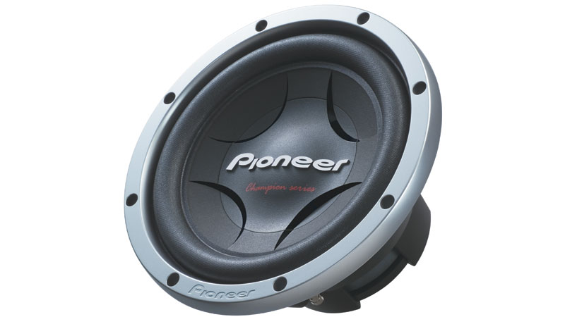

hi apexaudio,
just like your amps, i like your enclosure designs also.

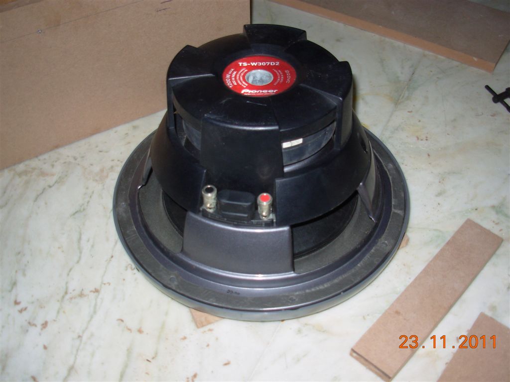

could you please take some time to design a bass reflex cabinet (similar to MB sub) or a horn reflex for my 12" pioneer TS-W307D2 Champion Series
thanks in advance
thanks in advance
hi apexaudio,
thanks in advance
Use this band-pass design for maximum SPL
Thanks alot, i appreciate your response.
Thanks again
Should i cover the inside walls with a carpet or glass wool sheet.
thanks

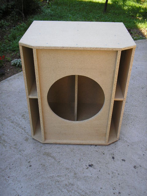

What would be the frequency response of this Enclosure. (fs=40hz???)
sure I sound naive
but it is quite interesting.

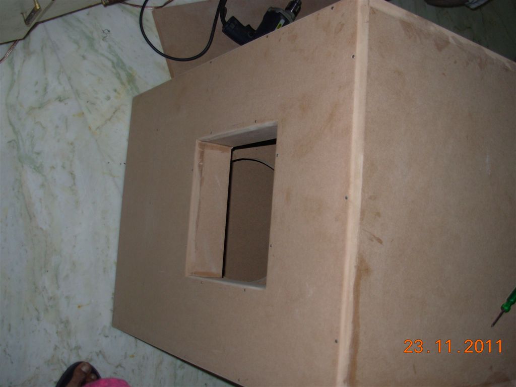

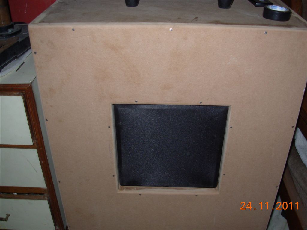

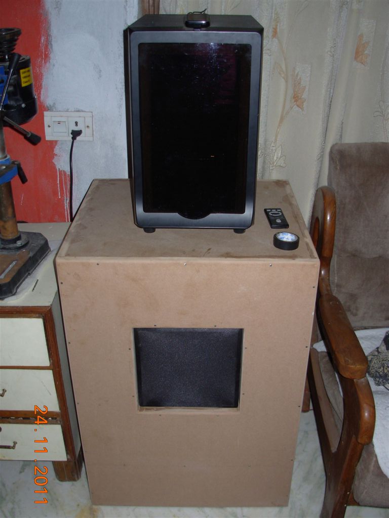

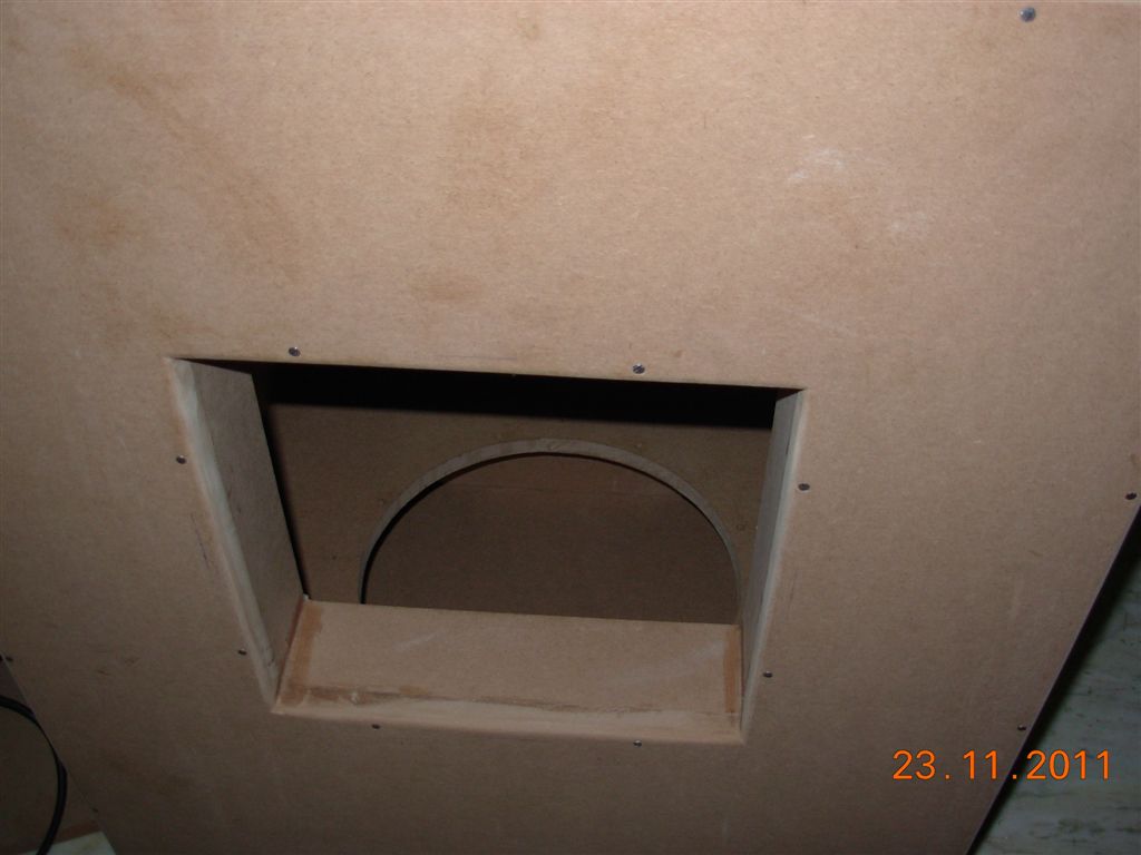

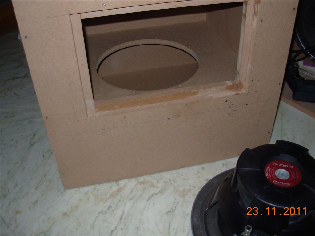

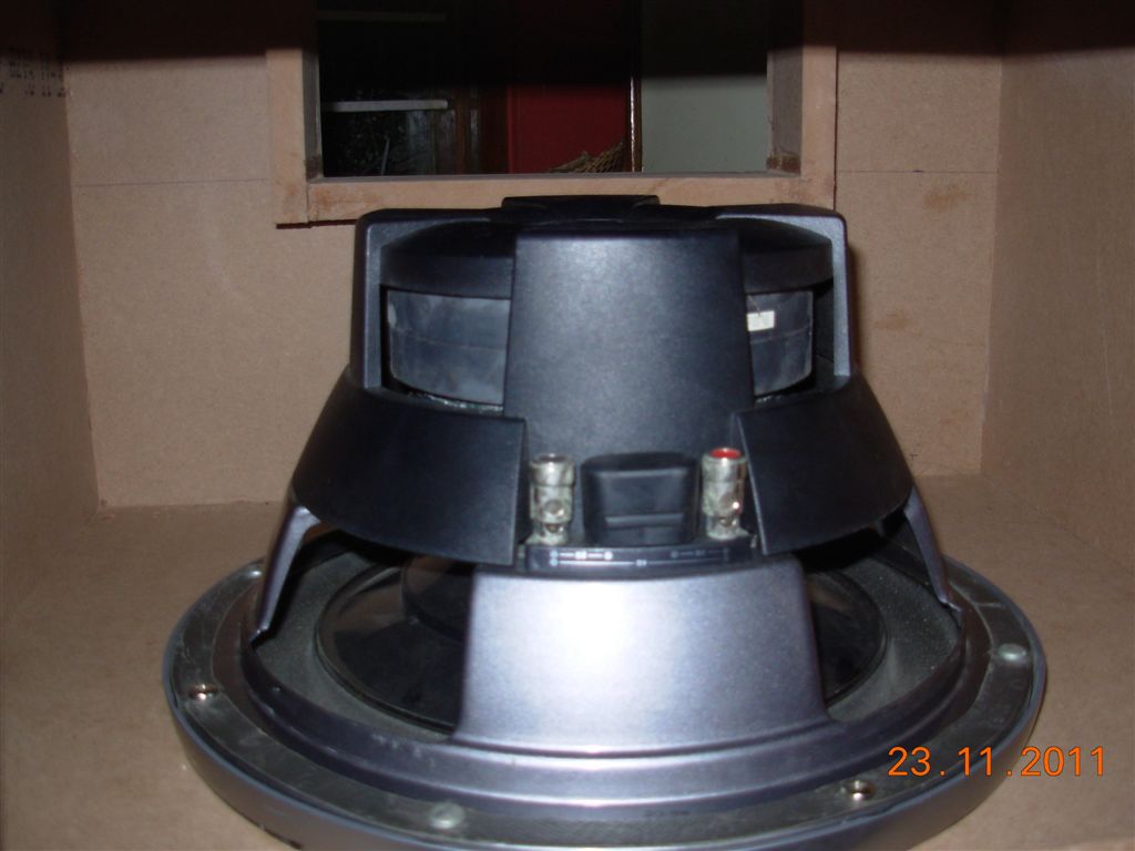

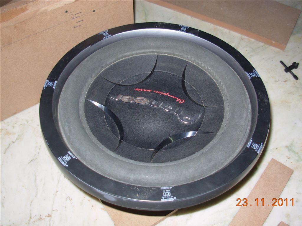

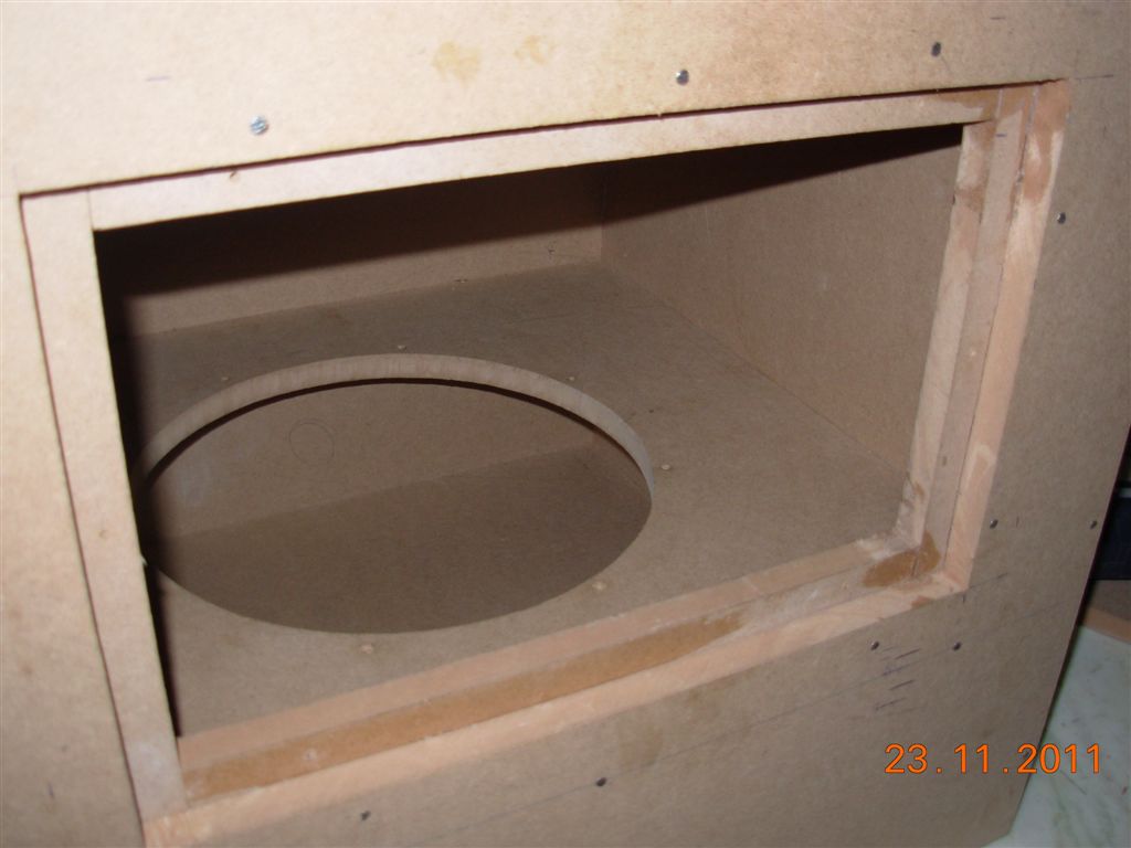

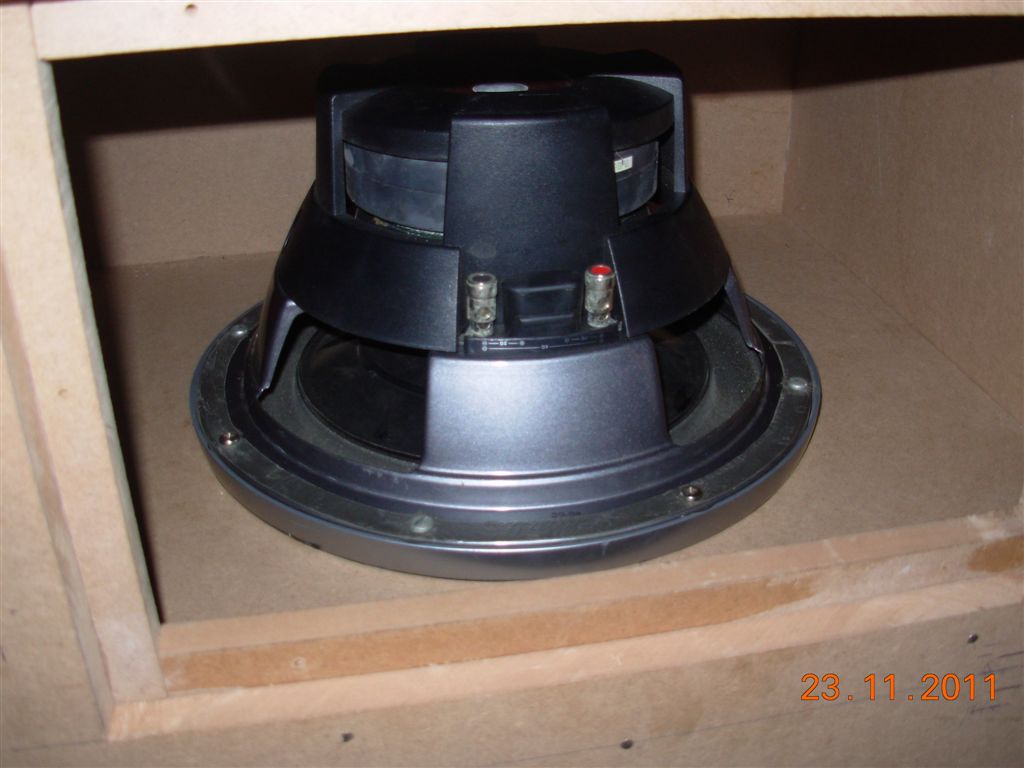

HI APEX,
I made this enclosure. this sounds great, specially at lower frequencies.
below ate some of the pics. still i have to mount glass wool and decorate the exterior.
thanks alot.
HI APEX,
thanks alot.
one more pic
Nice work, what kind of x-over, and what amplifier you use?
Regards
hi apex,
I use your subwoofer active crossover and a B500 for the subwoofer. for speakears, i use STK 3062 (60w /ch)
thanks

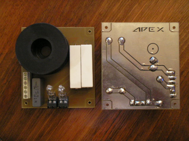

Simple HF x-over for PA drivers with two halogen lamps (G4 12V 35W) for protect protect.
can u share this pcb an schematic sir.
