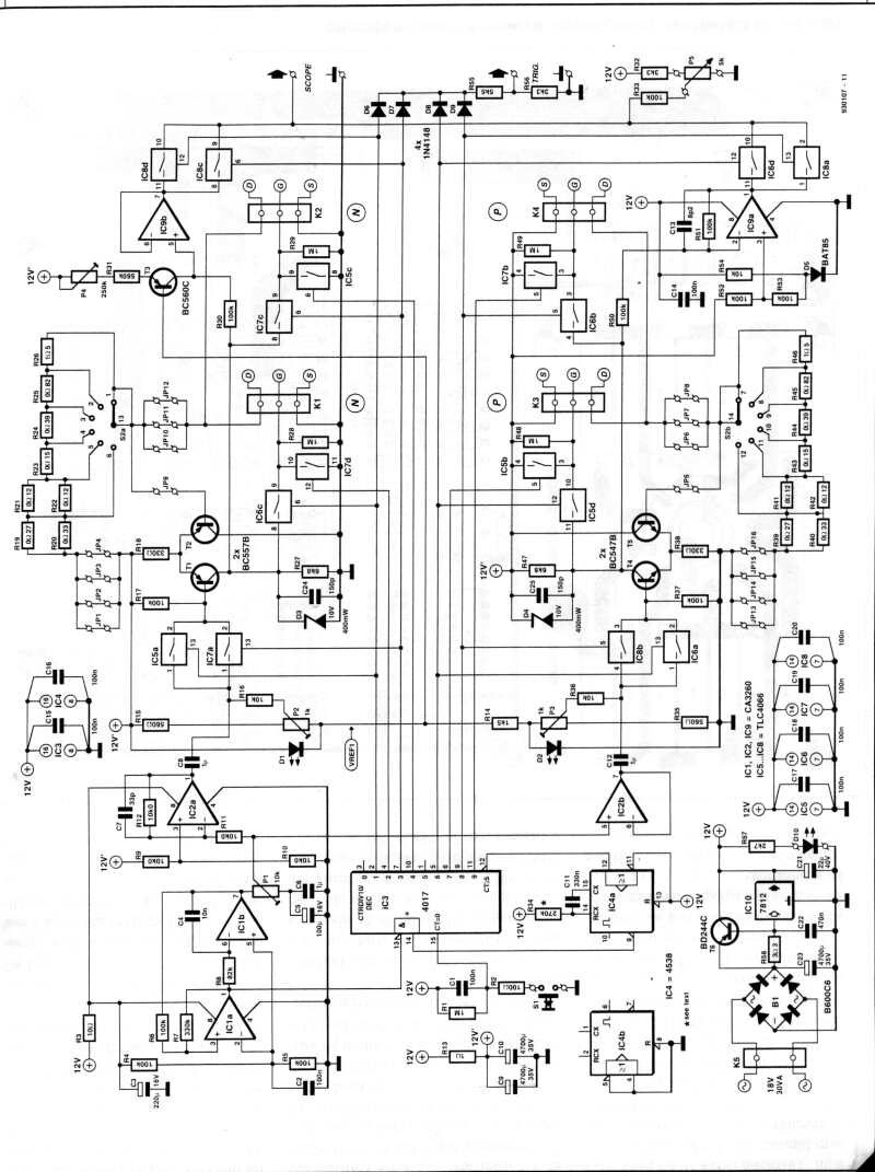

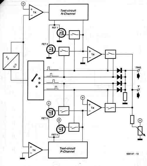

Perhaps you can tell us what temperature coefficient those ceramic power resistor you use would have ? Also I see that those resistors are stack one above the other without air space in between. I wonder how hot they might get in continuous operation (rather than a single shot per minute or so).
Further more, I expect that at 40V 3A, those power transistors of the dynamic supply will dissipate quite a portion of that 120W. I wonder how hot do they get, again in continuous operation, on the aluminium heat sink that you showed in your photos.
Thx for sharing your progress. We have decided to make our own, write our own software, and design our hardware from scratch. Our version will eventually be able to support continuous operation at full power (40V 3A), and sufficiently dimensioned power MOSFETs (12x TO247 devices in total) on large finned heat sink, and will use reference resistors throughout, with temperature coefficient of 50ppm/K or less. These are loaded to maximum 30% of the rated power, and are all mounted on heat sinks in addition. The hardware will have its own µP and linked to the PC via USB (no RS232 required).

The most temperature stability is ADC input resistor (91K/12K),
The ceramic power resistor is no important.
