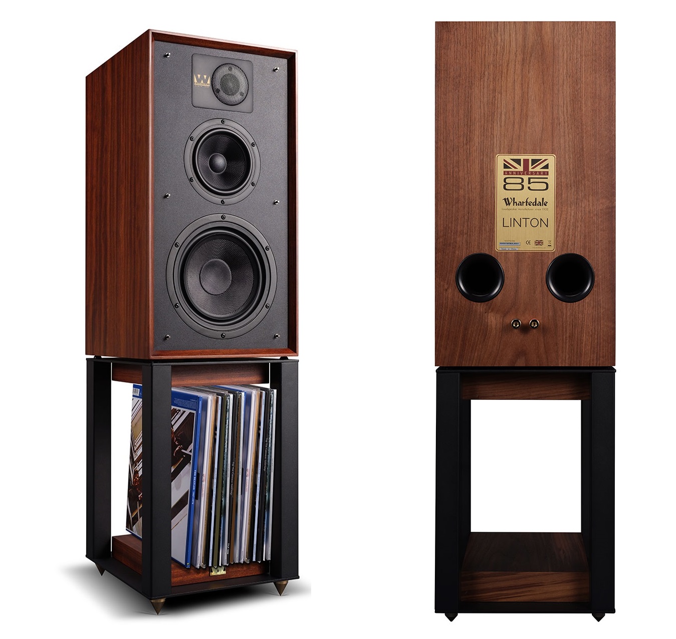

Wharfedale Linton Heritage
I wonder what DIYers think of this product and how it might compete against the classic 3 ways we can find as already available kits. Surely the parts could be had for 570 €/pair, not counting enclosure/finish and postage, but once you calculate in some realistic work hours, I don't know...
I wish there was a way to check what the Linton drive units and crossover filter looked like, as well as in internal of the cabinet.
A truly interesting product for a down to earth purchase price, considering everything.
There is a Stereophile review of it as well.
edit: At last someone figured out it would make a lot of sense to protect the tweeter dome. The only company that does a better job than this is Canton.

On first sight this loudspeaker ignores 30 years of "how to build a speaker enclosure for correct radiation", while using fancy looking carbon fiber chassis.
You will need a highly complicated x-over with countless parts, just to make it sound right on a very narrow axis.
A design that put´s the retro look over sound quality.
