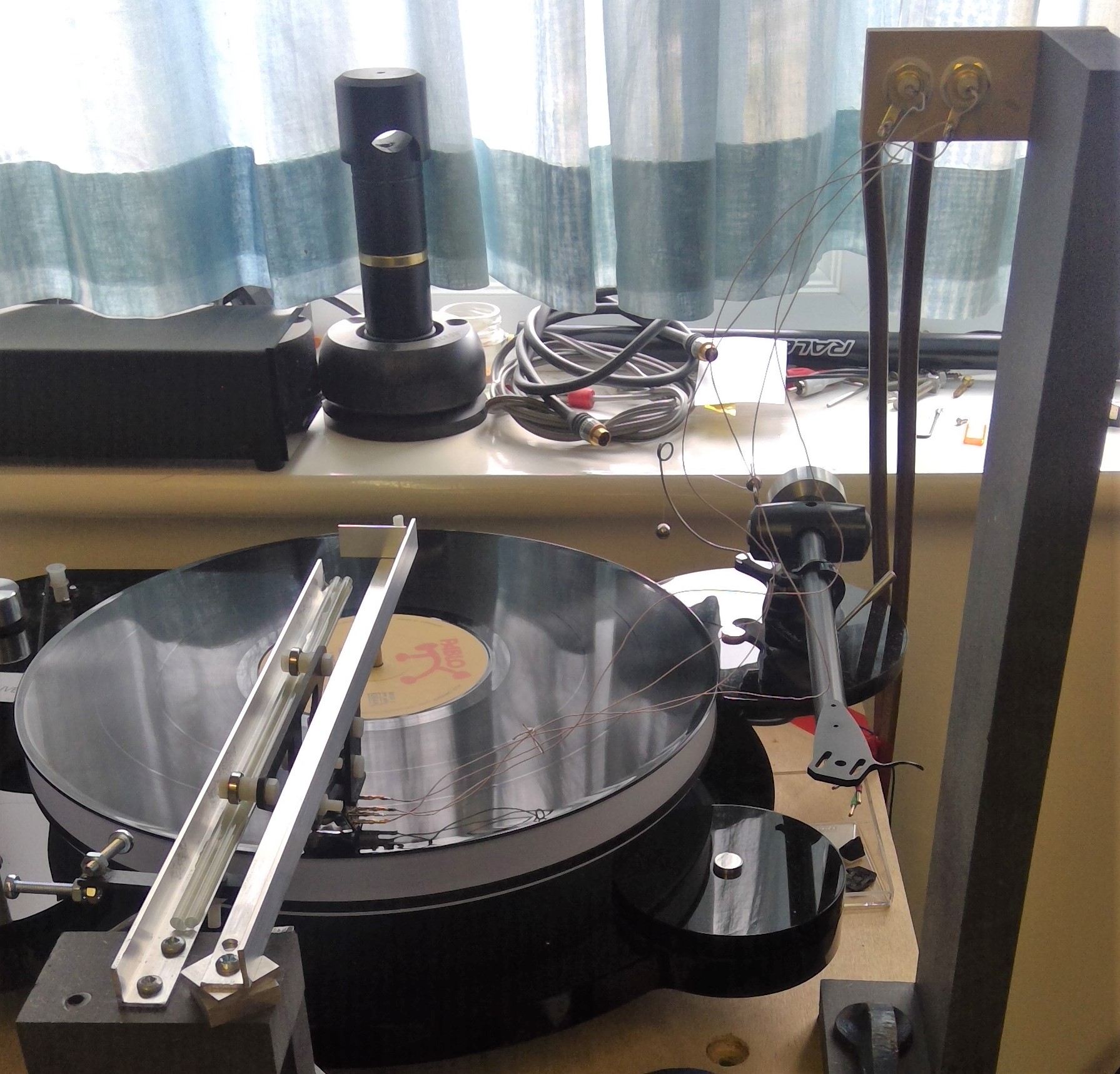

Needle talk, i have to get down to 200mm from the record to hear it.
My previous TT was a Rega RP8 with Apheta 2 MC and the Needle talk could be heard from the listening position with the volume turned down. I didn't have this TT very long.
Limitations so far are two
It sways or rocks parallel to the groove and you can hear the wow from that, it needs stability. i hope this can be seen in the clips. Somehow i need a solution for that
The warp movement seems fine, the cantilever seems untroubled by the experience.
Rocking I assume you mean Azimuth tilt. Looking at the photo of the back IMO this is most likely caused by the play in the bearings. Preload the bearings to remove most of the play. Too much preload and the bearings will bind.

I mustn't get too exited yet, i still have those problems to resolve before its usable and to judge if it exceeds my current arm at all......BTW, i never noticed needle talk with the OL arm, doesn't mean it wasn't there, but i never noticed it, but hopefully his arms are better than the Rega as that's what he aims for and has a good reputation, and i have been happy with his, my motivation started as a lockdown project!My previous TT was a Rega RP8 with Apheta 2 MC and the Needle talk could be heard from the listening position with the volume turned down. I didn't have this TT very long.
No, sorry, my poor description, its rocking along the groove varying VTA by swinging around the rail viewed from the side. It seems pretty solid in lateral across the record and azimuth consistency also looks ok at a first glance.Rocking I assume you mean Azimuth tilt. Looking at the photo of the back IMO this is most likely caused by the play in the bearings. Preload the bearings to remove most of the play. Too much preload and the bearings will bind.
The bearings get a little preload from needle drag i guess in the direction i am describing.
This may also be because in warp the length of the vertical lever around the rail varies and cartridge drag will rotate it but with the varying lever the moment varies.
Being radial rail as opposed to vertical pivot this is more critical and must be because this variation exceeds the resistance to rotation from the bearings sat on the rails and the moment of the weight below the rail.

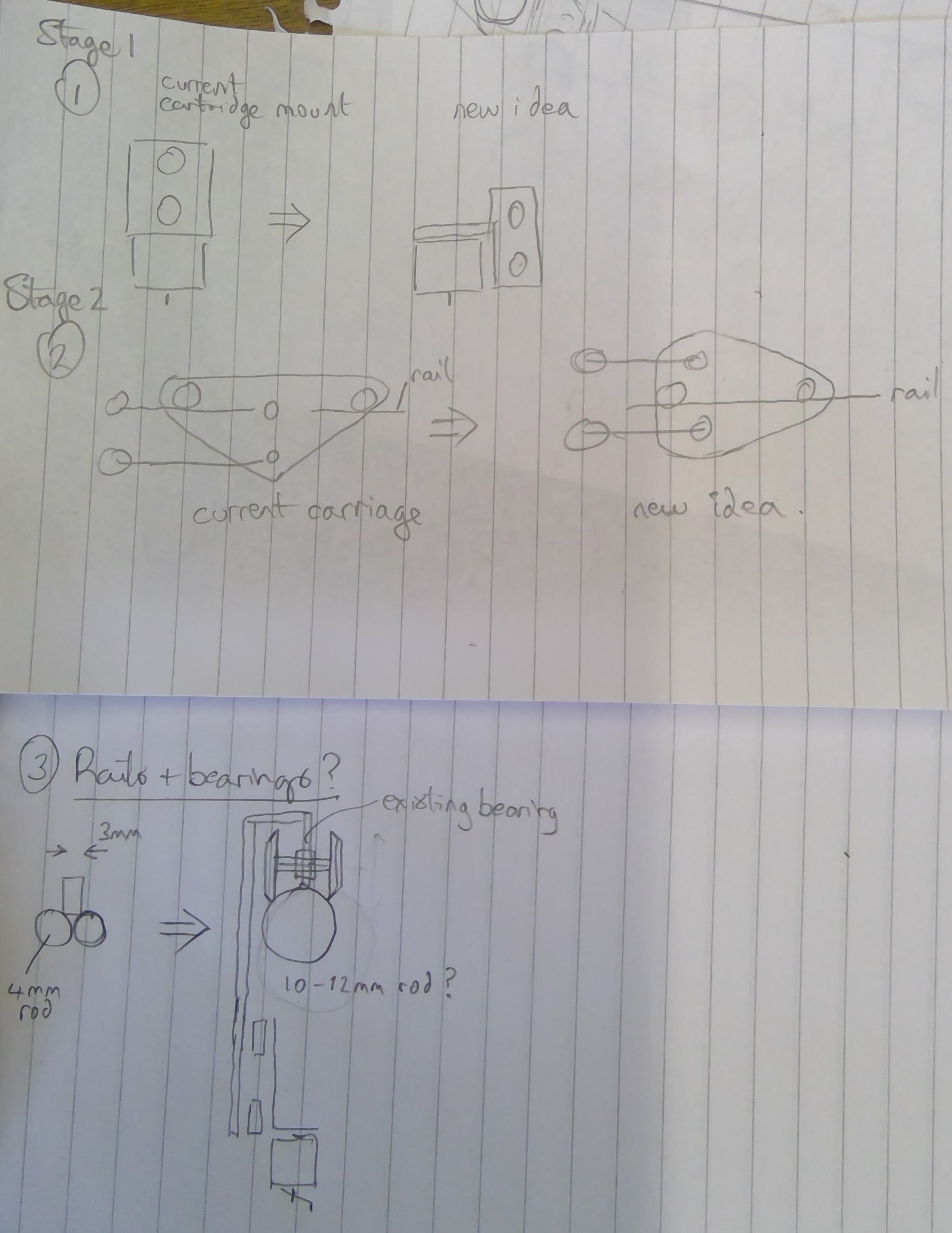

So i scribbled 3 ideas, (apologies again to those i offend with these sketches!) first two to lower rail to stylus height, but i have a feeling the weight being low relative to the rail is also nice, Stage 1 i can do more easily than stage 2large rail section: same single bearing centered on two large diam wheels, to increase the advantage on the axle. The double rod rail is not really self centering because the bearing has to slide (not rotate) to go back, while probably it likes more to reach a lower potential position
c
3rd idea is my interpretation of your suggestion of larger rail, can be done with the other parts the same, are such wheels readily available, easy to centre etc?
This way the cart can still rotate (no self centering). Think instead to put the cartridge + parallelogram between a two rods rail (round, square, angular, who knows) hollow in the middle. And at the same level, trying to reduce at most all harmful torques, horizontally and vertically.

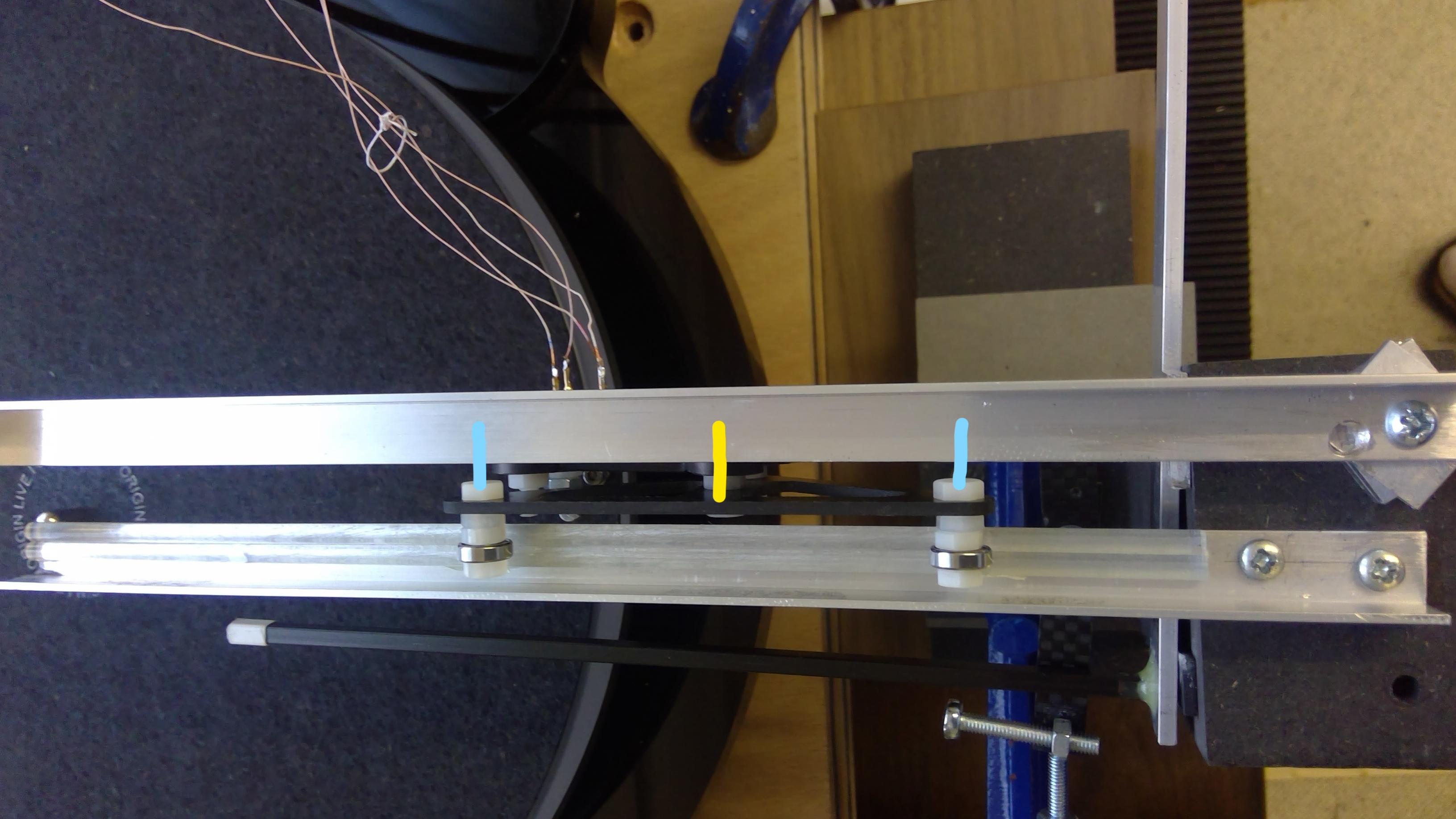

I can see the appeal to get stability and also to reduce the moments and torques. The two are not necessarily related so starting with the rail and runners:
At the moment i am struggling to think of the rail system that will give stability without increasing friction and contact points.
I could simply add a second rail where my crash rail is and dispose the running bearings (1 or 2, yellow or blue respectively) and i would have stability, but would only be good if i could get the rails really flat, one relative to the other, or i would create VTA change as well.....and friction may also take over.....but if that worked i could then move on to other areas, mike
From that pic I can see why you have pitching issues. you have 2 vertical pivots. Adding 1 bearing in the middle on the opposite side to the other 2 and another rail would solve the issue. You will need to make the rear rail adjustable so it becomes parallel with the front any miss alignment (either vertically or horizontally) between the rails will tilt the cartridge by a multiplication factor of the distance from the rail to the cartridge.
Thanks Warren, i can implement that most easily and then consider further refinements as time goes on.
i will make a new pair of rails and bolt the two bases together each end to ensure alignment. the works will then hang through the centre.
By two vertical pivots, do you mean the pitch on the rail and the parallelogram please? - and acting under the same force or moment they get into instability?
If i do that the rear bearing and rail will not then be radial. which brings me to question which rail and bearing is considered the principal one and where between them to i best centre the weights?
Or, i could not change any of that just add the rear rail with current arrangement and see! - i recall sound advice about don't over think it.....

I would start with the COM centered between the 2 rails. If you use 3 bearings the rear will have higher contact pressure, will this cause issues, I don't know. I would not use 4 bearings as any miss alignment however slight could have one or 2 bearings lifting off the rail. A 3 legged stool is firmly planted no matter the ground profile.
