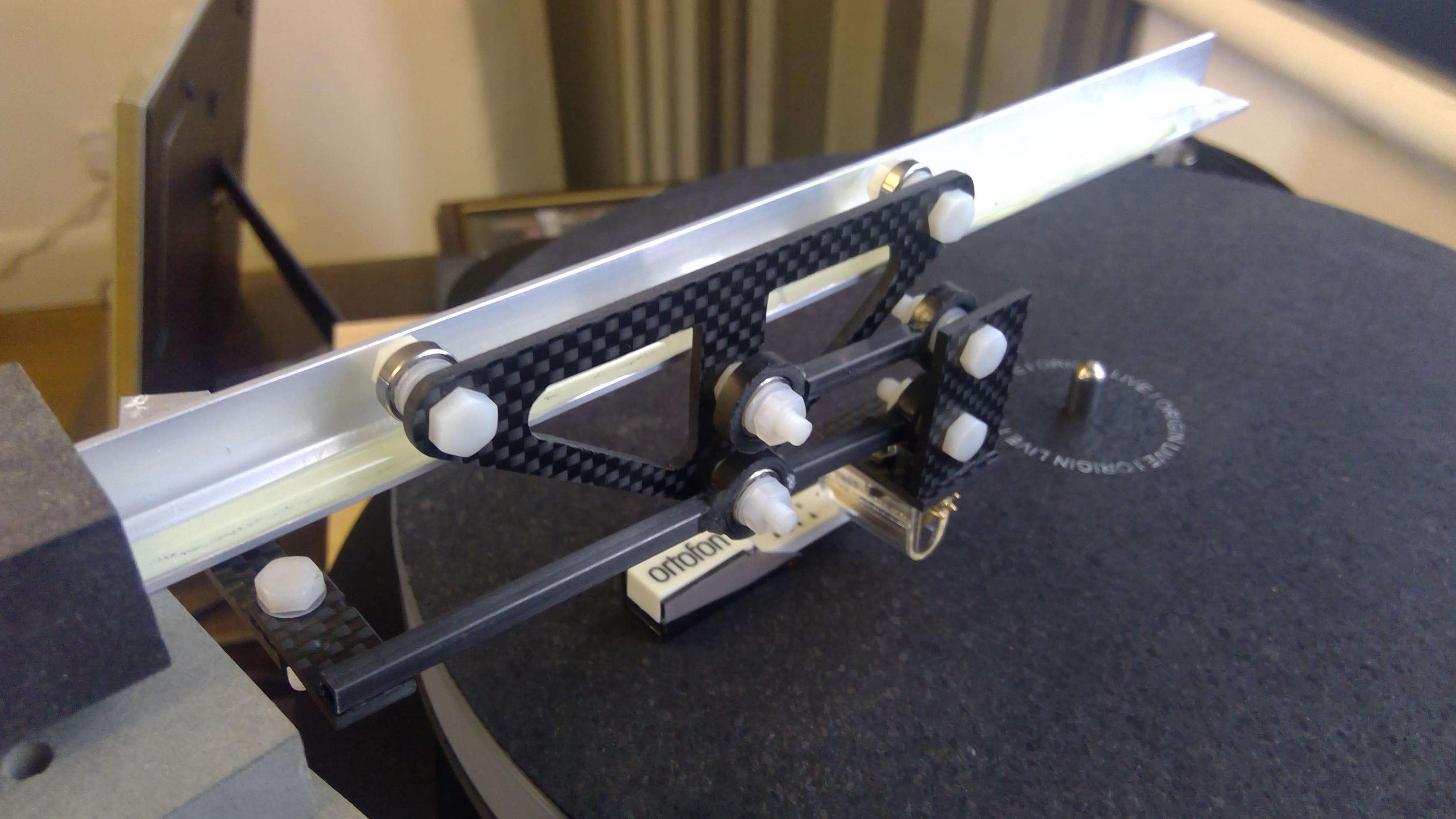

i know the glass rail and bearings is vulnerable at the moment having knocked the carriage off many times already....
Well, having crashed the carriage regularly during assembly i added a crash rail, you can now knock it around and it stays in place.....
wiring next, then a first run.....
Carlo, i am not familiar with the Cantus, but on mine there are no articulations except the parallelogram and the stylus is directly under the rail which i read is desirable.
I freely acknowledge i may have missed something as i have not done it before, maybe this pic shows it more clearly, before i fitted the crash bar to stop a derail, the vertical movement for cue and warp is the parallelogram, horizontal the carriage.......................
would be great to have your further insight, thanks, mike

Joking, of course: ball bearing + glass rail drove me to Cantus, an highly replicated solution.
Now i've seen better; you have two ball bearings on two glass rods, while Cantus uses two ball bearings on a glass half pipe to achieve the vert. articulation with some bearing's sliding.
This is far better because, due to the vertical lever, it's important in your setup to keep the hor. travel as steady as possible, and you may use all the weight and section needed.
Difficult to have opinions, the forces involved are so small that nothing is enough to go wrong. I do not like ball bearings, and would have kept the lifter separate, aiming to miniaturize at most the parallelogram (+ - 2mm even for the worst warp).
All what remains is to try, and you are now at the ending (again, very well built)

Hmm, set it all up wired and ready to go, it rides the record ok, but no sound!
Leads seem difficult, they show continuity on the meter if you push hard but produce no result.
Thinking i had wrecked something, like the cartridge, i put it all back in the original arm and it works fine, so wiring seems faulty.
Heck, this is a hurdles race where each time you get to the end someone puts a few more in the way!!!!- i thought i had done the difficult bit!

Xover? Mike, I understand the impatience to hear the new born playing, but don't put too much meat on the fire, consider please that many LTA builders lose years of tiresome efforts simply to avoid the stylus skipping.
If the carriage "rides ok" horizontally and vertically using simple ball bearings it is a really, really good result. Thanks to your simple and effective design and construction, and to the radial rail too, that does not steal side force in harmful torque on the bearings.
Watch carefully with a magnifier the behavior of the cantilever, and listen to the resonances on the rail (the needle talk must be almost inaudible), better if taking simple friction measurements.
For listening, test discs and so on there will be time after: better to evaluate first what has been done in the most objective way, imho. Everything seems to sound wonderfully better than everything heard before, at the beginning: but an arm that moves badly will never sound correctly, whatever the owner may think.

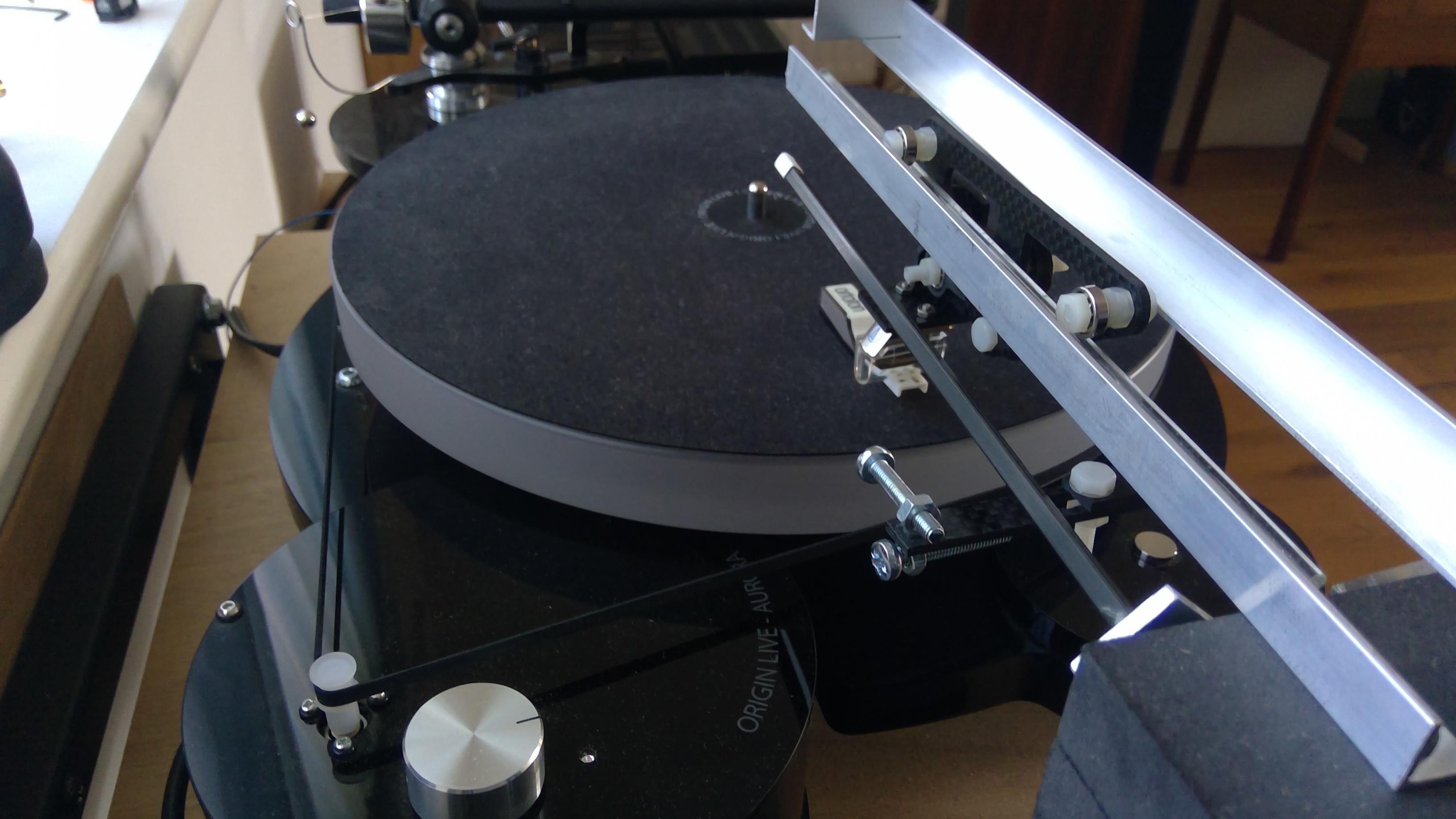

Well it plays records!!I understand the impatience to hear the new born playing,
And as you said Carlo, of course it sounds great! - well its the new baby isn't it!?
It sounds solid, seems to track ok generally.
Limitations so far are two
It sways or rocks parallel to the groove and you can hear the wow from that, it needs stability. i hope this can be seen in the clips. Somehow i need a solution for that
The warp movement seems fine, the cantilever seems untroubled by the experience.
Needle talk, i have to get down to 200mm from the record to hear it.
Second the wires spring varies and for example moves the carriage when on the lift, i will try them straight back from centre of groove area but with some slack. it might ease the instability parallel to the groove as well.
