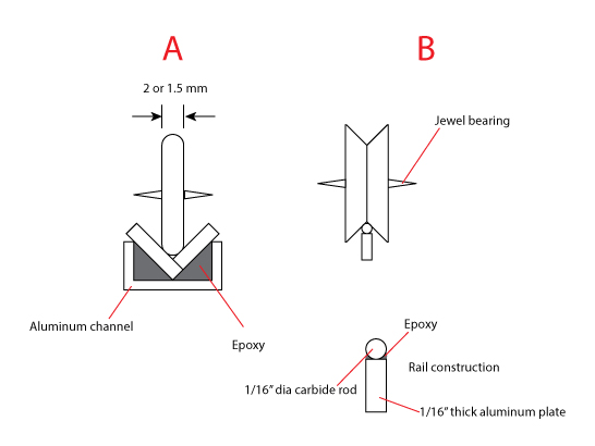

Here are two proposals if I would make a mechanical linear arm. Both proposals are highly diy friendly.
A. You may use two pieces of glass plates to form a rail and make two wheels same as Niffy’s. If you can find a pre-made glass angle channel, it would be even better.
B. Using two v groove ball bearings and modifying the v groove bearings by using jewel bearings. The rail can be hard metal or glass. I think even regular stainless steel will work well, too.
I did cut c shape of glass tubing myself. However, I would not recommend this kind of arm. If you still want to build this kind of arm, I will be happy to explain it in detail.
Jim

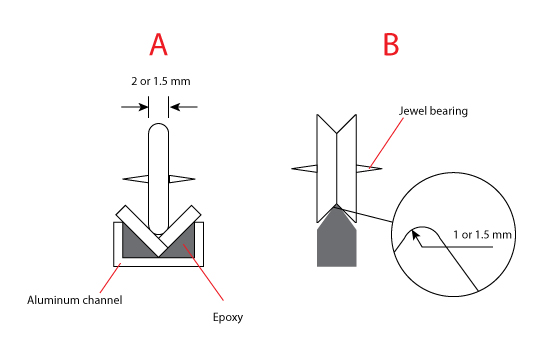

Hi Jim,
Picture B is pretty much exactly what I made for my first rail and wheels. I used a 1mm steel rod for the knife edge.
With either option I would recommend having the angle of the V greater than 90°, I think that 120-140° is optimal though this angle will be more difficult to make.
Even with my very short arm and 2mm wide wheels the amount that the wheel moves on the rail is very small. This is helped by having a very effective clamping system. During normal use the wheels will slide by less than 10um around the rods. That's less than 20 arc minutes which is pretty much a straight line. In reality there isn't really any difference between using round rods and flat bars except that it is much easier to build a straight level rail from round rods. It is also much easier to get a more obtuse contact angle.
I think that one of the reasons that knife edge bearings can work well sonically is that they have a very narrow contact line. I found that having a smaller radius on the edge of the wheel sounded slightly better than a fully rounded edge, as shown in picture A. The smaller edge radius will result in a narrower contact line.
Niffy

Hi Niffy,
For the rail as yours, two rods, there may be only one set of optimal parameters, such as the thickness of the wheels, the diameter of rods and the radius of wheel edge. For example, if we assume the thickness of the wheel is 2 mm, the damping in the vertical plane can change dramatically once the thickness of the wheel is less than 2 mm. But the rail as I proposed, it may be very flexible. For an optimally designed arm with the rail as yours, and for an arm with the rail as mine, I don't think there will be a lot of difference.
Jim

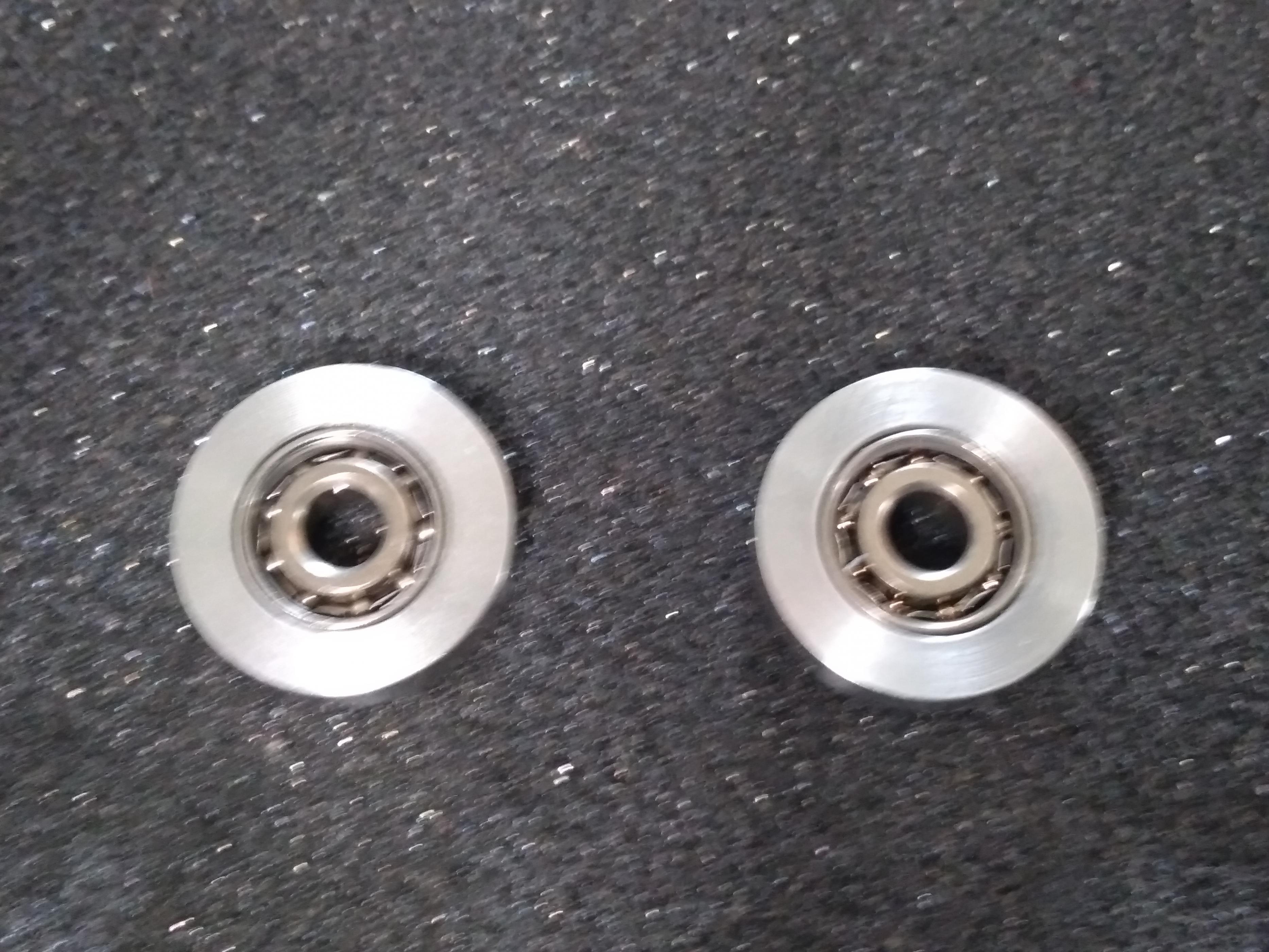

That last one is my video, and is the before I added the larger diameter rings.
The cartridge I use a Stanton 881s and very high compliance 30um/mN. So it took me a while to get it to track properly. I machined a set of rings to increase the diameter of the wheels, this made a significant improvement to tracking. The cartridge now tracked without jumping. Installing the brush improved it further.
I did back to back listening between my Technics EPA100 and this linear, and have the same type cartridge installed in both arms so all I need to do is swap the stylus. The linear arm smoked the EPA100.
A lower compliance cartridge would be easier to set up. Niffy uses an Ortofon 2M Black 22um/nM and I'm sure this would track well now in my arm.

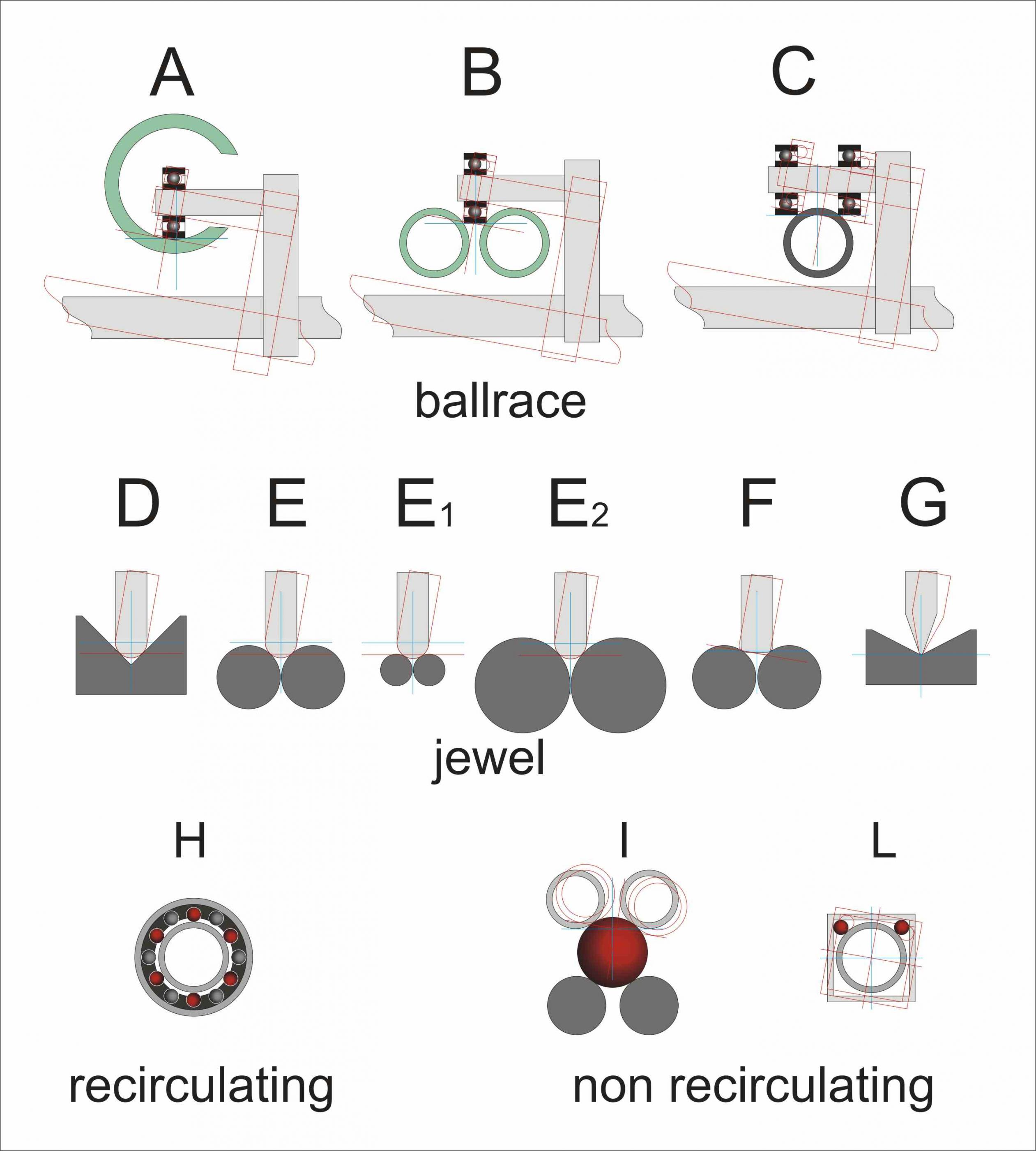

Here a summary of the carriages known to me, that can allow the double articulation, so as to be able to evaluate their advantages and disadvantages, from a geometric point of view. To highlight it was used an angle of 10°: obviously in the reality there will be at most a tenth, on worst warps; if not, better to throw away the disc.
hope this helps - carlo

Hi Niffy,
Jim
Hi Jim,
You make a very good point. With your design, with the flat sided V channel, it would be much simpler to experiment with vertical damping, all you need to do is make a different thickness of wheel. With my design I would have to make a whole new rail as well.
Niffy
