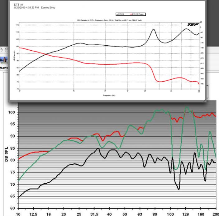

You will find when sensitivity adjusted for the different drive levels used, Josh's tests show about 8 dB less output than DSL's posted measurements.
Though the DSL DTS-10 output is impressive, that difference is hard to ignore, though when I pointed out the discrepancy to Tom Danley, that is what he chose to do..

The DSL DTS-10 spec is 100 dB sensitivity 2.83 v into a nominal 4 ohm, which should be about 97 dB one watt one meter (2v). Since the actual impedance dips lower than 4 ohms, perhaps subtract another dB or two.
Josh Ricci’s one watt DTS-10 tests show a 87.3 dB average.
That is quite a large difference, even after the voltage difference is accounted for.

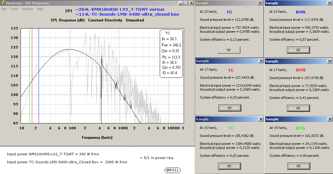

Hi Keyser,
Agree...Its a very good driver.. I'm not starting a 'P'-contest..there are IMO more than enough of stupid SPL bla..bla Power bla..bla threads in the Subwoofers forum where you can find drivers that can be..I hate this phrase, : ..'Pushed harder'.. by injecting currents large enough to weld stainless steel..
See the submitted picture of such a driver compared with the BMS 18" driver...No doubt on which one I would choose...
