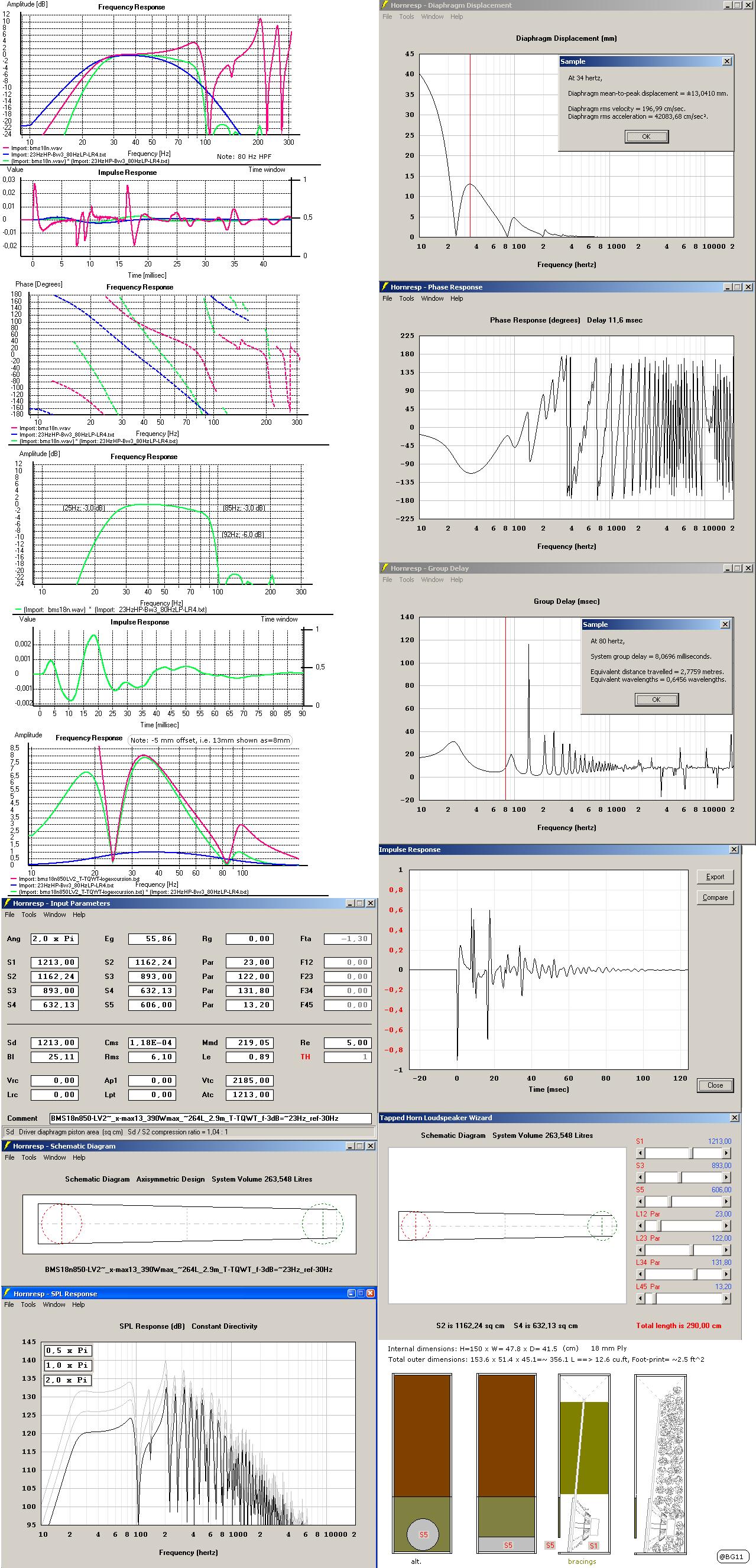

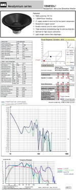

Hi Dennis,
Here is a sub suggestion I believe is as good as any other:
b:)
