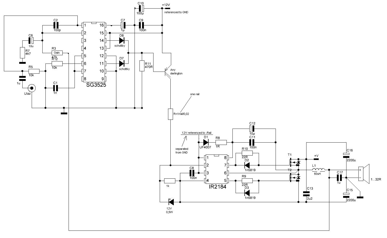

I don't have any test equipment here so it's only idea,not tested.You should test it.When I buy scope,I will try with GDT,I like this.Darlington is used because of base-emmiter voltage and classic BJT with diode shouldn't work.
Any sugestions will be good.
There's schematic:
There's schematic:
Don't forget to place storage inductor after secondary diodes.Oh,i get it,i will try smps

There's schematic:
Is this one better or just not the same?
Can ''Logic'' optocouplers be used?,im pretty sure they can be since they are listed as fast optocouplers

Or this if you want not ''logic'' optocoupler https://www.fairchildsemi.com/ds/FO/FODM453.pdf
