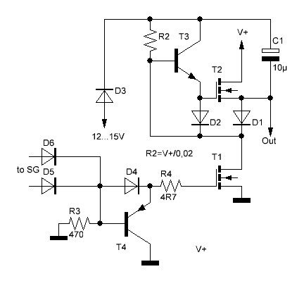

FIRST READ DATASHEET,If you wired it in halfbridge.SG isn't lo/hi side driver!.If you want class D without ir2184 you must use for example (I listen music now on this amp.) irfz44 and irf950 with RD in gates and totem pole driver.Output must be taken after two diodes (se my schematic) and go to totem pole,then fets with discharge with diode and charge with about 47...100R

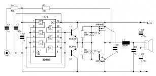

Sure,I tried with 40106...4049 work very well as the comparator stage
393 is bad for class D.Measure output wave if you have scope.Transitions is very slow,and Fet's will heat more than class B amp.

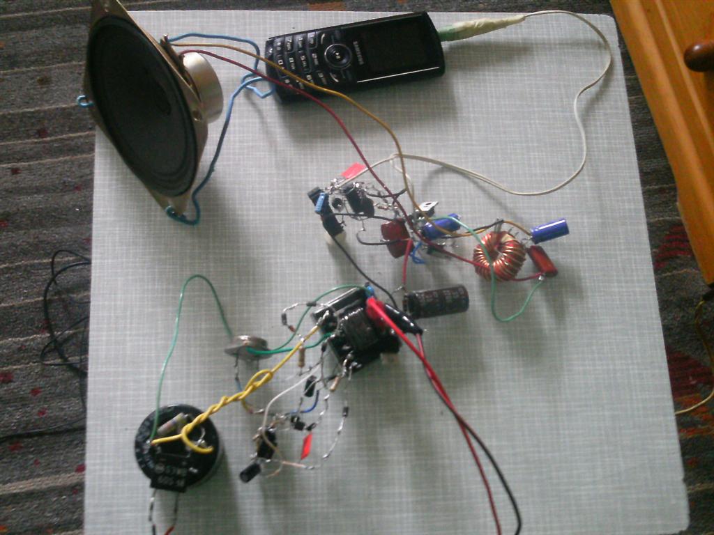

Here is my sch.,
I used only at 12V,for more there will be capacitive drive.Maybe I will try to make discrete driver for upper Fet,and both will be N fets.40106 will insert dead time betwen two fet's.

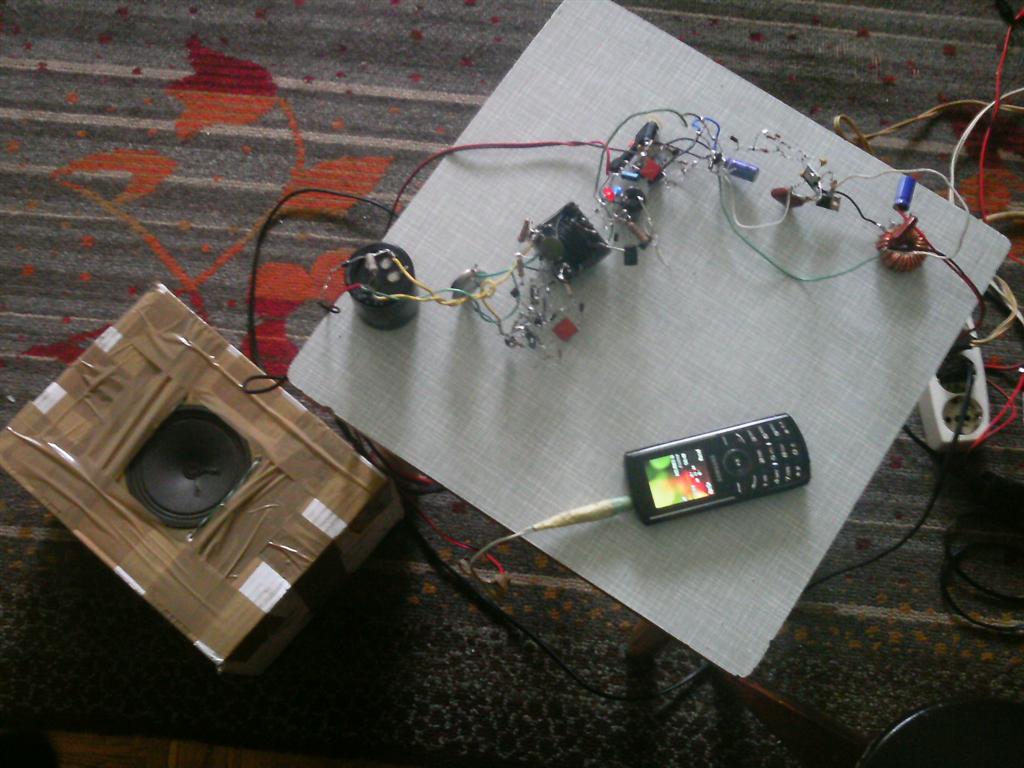

Here is my sch.,
