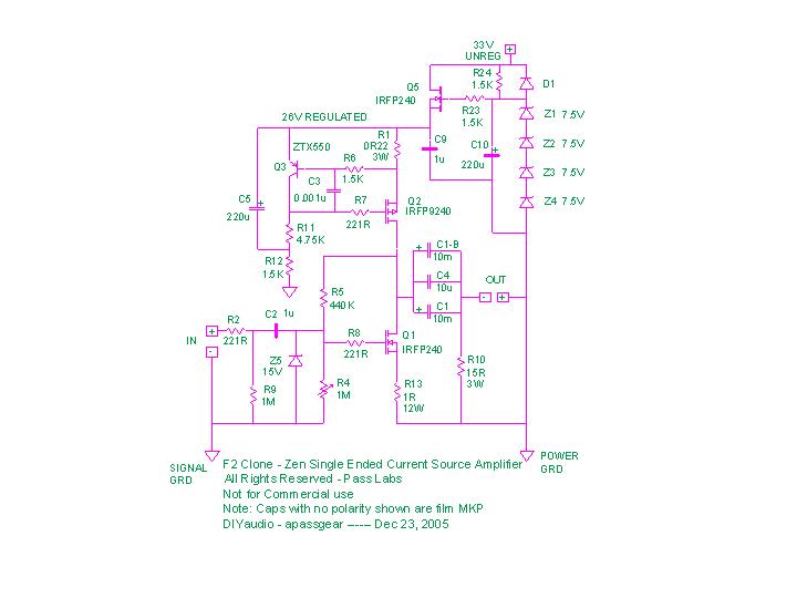

Babowana said:F2 N-ch MOSFET CCS
This way?
I just replaced "all" 2k2 with 3k3.
And, thought of 10,000uF on hand.
Papa, don't hate me . . .
looks good enough
Trimpot P1 on Mr. Pass's schematic is connected different from what we did. It has the viper connected to the gate of Q1. We had it connected to Gnd as far as I recall. Maybe that was the cause of the problems there was adjusting the F2 clone?Now the original has a different schema for biasing Q1 and has a slightly higher feed back (?), 100K against 440K resistor if memory serves me well.

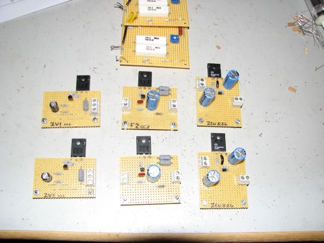

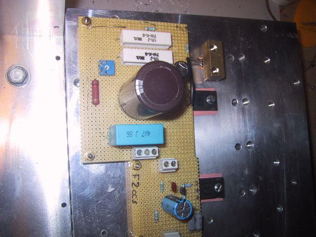

Could be fun making a few perfboards with the correct schematic, the F2 CCS's I posted on the picture earlier, just needs one cap changed to 15.000uF. Wouldnt 10.000uF be enough? I cant figure out how to calculate the timeconstant or whatever it is that determins the size of C4.

For reference I have attached the clone schematic.
Steen
steenoe said:Trimpot P1 on Mr. Pass's schematic is connected different from what we did. It has the viper connected to the gate of Q1. We had it connected to Gnd as far as I recall. Maybe that was the cause of the problems there was adjusting the F2 clone?
Both are voltage dividers for biasing Q1, Nelson's schem seems easier to set though, what did call my attention is that he uses only 100K + some that acts as a bit more feedback in my book against our 440K. As far as I know the way you connect the pot is not important but Nelson wisely enough connected the wiper to the leg that will carry the least current and uses two more resistors in an elegant way. In this setup is easier to vary the FB chaniging only R6.
