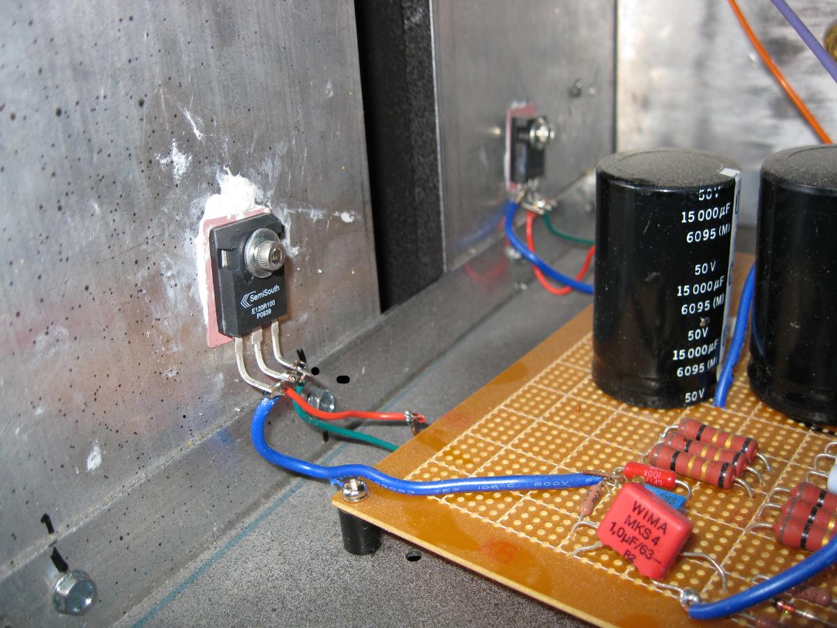

I dropped in a South Semi R100 JFET this morning into an F2. About a 4 minute operation in my very proto looking F2.
Made music right from the start which is good. The previous bias setting had dropped from 14v to 10v. So I cranked it back up some, and listened for some time.

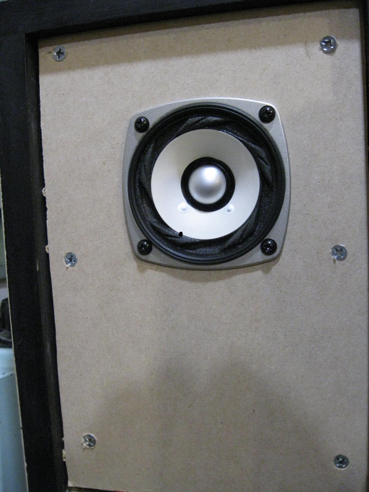

I think, with no other circuit modifications, there is a bit less gain, and the F2 sounds a bit 'cleaner' without sounding lean. I was driving a fostex ff85k in a bass reflex with only the 3x47r resistors on the output.
Might be far from optimal, but does appear to drop right in, replacing IRFP240.

The F2's that I have updated with the JFETs need the
following changes:
R6 = 47k
C1 = 10 uF
Z1 removed
The potentiometer must be re-adjusted for minimum
distortion at 4.5 watts (symmetric clipping) and readjusted
after an hour.
The distortion results are typically a reduction from about 1%
at 1 watt to .25%.

Papa,
Completed your circuit mods, made sense to remove R2 since it seemed a lonely soldier.
The unit now biases at 13v max (P1 full blast), and by ear (swag) I think the distortion seems to be less with bias at about 10v. Do you off hand remember the bias voltage you had? My distortion analyzer is only imaginary, so I was hoping for a best guess. I have no R13-15, but do use 10R 10W across a FF85k terminals.
I thought R4 could be set to 4.7k for more bias, but that seems to be going in the wrong direction.

Wicked1,
I changed R4 to 3.32k for sport. Still Bias'd at 10v, mostly because I perceive it to be a good value from both heat dissapation and sound. More bias might give a bit more body and less distortion from messing with amp's in general. I will tweak more once I get a scope home from work and learn to use it.
